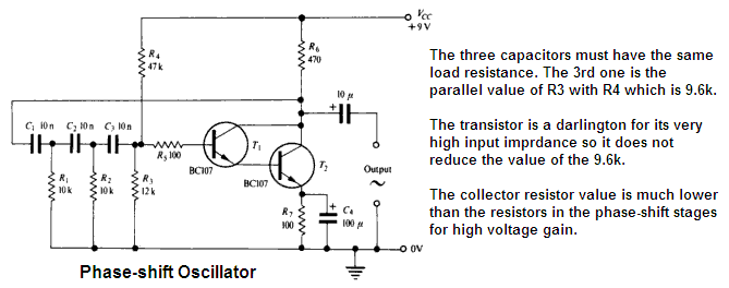

The first link in Google shows a resistor in series with the base of the transistor to increase the total load resistance for the 3rd phase-shift capacitor.
Another link in google uses a darlington transistor that has a very high input resistance then the load for the 3rd phase-shift capacitor is calculated with the resistor values.

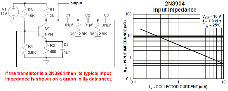

But the fairly low input resistance of the transistor (do you know how to calculate it?) is in parallel with R3 and R4. The total resistance is supposed to be the same value as R5 or R6 which is 2.9k ohms ohms.
I/P impedance is R' = R1//R2//Beta*Re i think it it the formula.
The input impedance of the transistor is about 1.3k ohms and is in parallel with the 2.4k of the resistors then the total resistance is only 843 ohms. It is supposed to be 2.9k ohms.
I used a 2N3904 transistor that has a typical beta of about 150. In your phase-shift oscillator circuit its collector current is about 3mA and its Re is 0.026/3mA= 8.67 ohms. Its emitter resistor has a bypass capacitor so it does not enter the calculation for input impedance.
Then its input impedance is typically 150 x 8.67= 1.3k ohms.
The datasheet for the 2N3904 transistor has a graph showing its typical input impedance at different currents which shows a typical input impedance of 1.3k ohms at 3mA collector current.

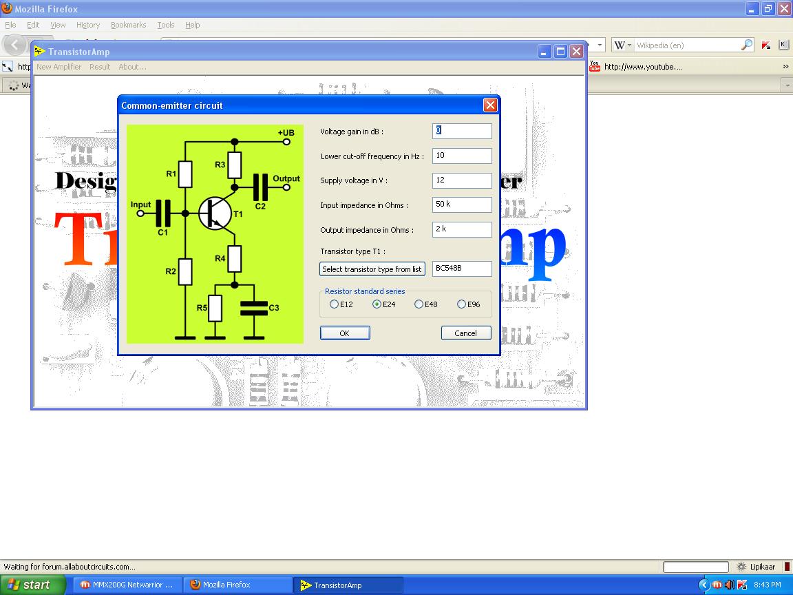

Hi, see this I find in Google.
Use the program to design the transistor with a total input impedance of 2.9k ohms and a gain of 30 or almost 30dB. Then the transistor can be used in your phase-shift oscillator circuit and watch its output rise to clipping.
