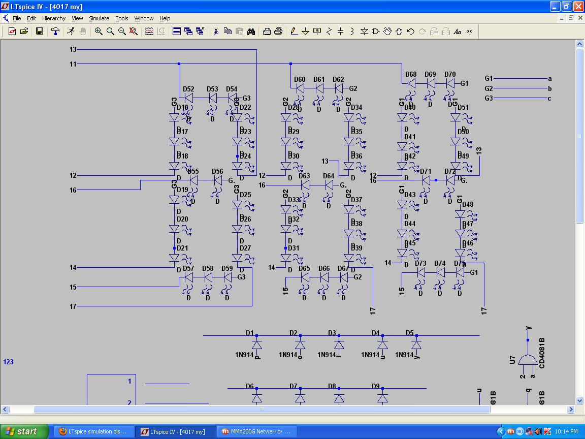

This is some part of it to be designed.!!

Please, you tell which ic should be used??

I don't know what your 15 LEDs are supposed to do.
please reply..!!
Ritesh,
They way that you have shown the LED diodes connected are as individual 7 segment DIGIT displays.
They can only display '0 thru 9' and 'A thru F' and a few symbols.
The display cannot scroll left as shown in your link, that link led display uses a DOT matrix and the scrolling characters are moved one column left, which gives a scrolling effect.
Your display will be just number changes. eg: '12' , '23', '34' which is not going to look like scrolling.
why?? i have stimulate it.
If you are satisfied that the simulation of your circuit really works and gives you the results you are expecting, WHY dont you build it in order to confirm your design.????
Its make your mind up time.:)

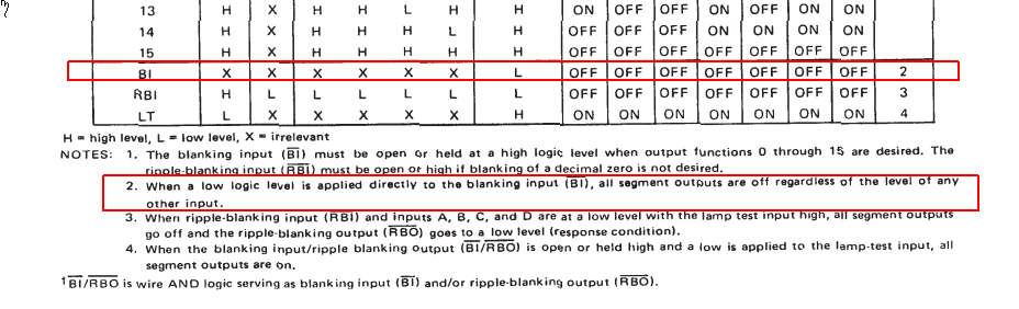

hi, i want only one 7447 ic to be connected to displays, but when there is no input to 8421 pins it should give output i.e. blank.
Use a 4 input OR gate to detect 1,2,4,8 LOW and set the BI pin LOW

How else can you detect that the 7447,,,, 8,4,2,1 inputs are LOW, so that you can switch the 7447 BI pin low in order to BLANK the leds, which you asked how to do.???
