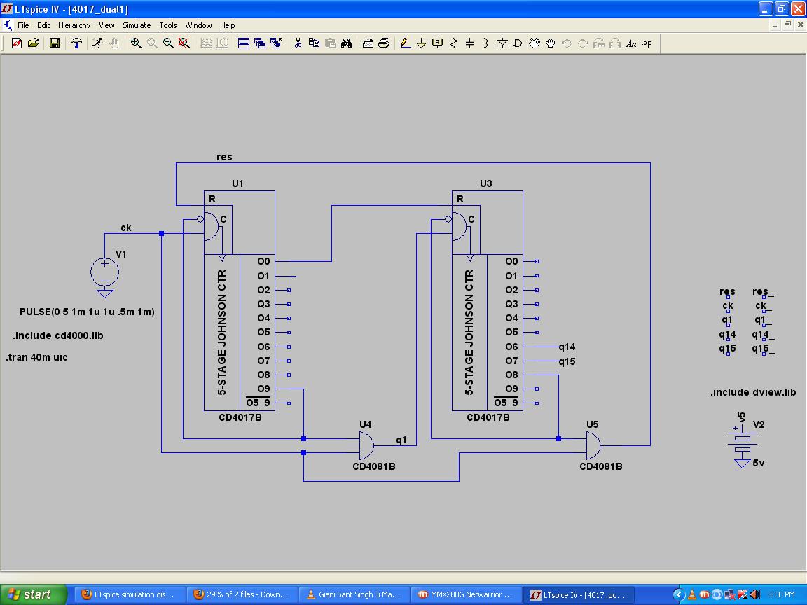

Sir, pls post 4017 complete tutorial circuit for Lt spice, as earlier sent is showing component not found.

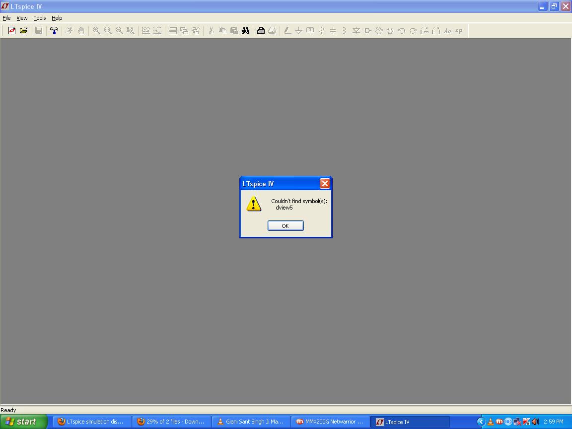

These are the problem occurs when i run 4017 file i LT..!!

This is your problem, you dont have dview,,, just delete the figures shown in this image,

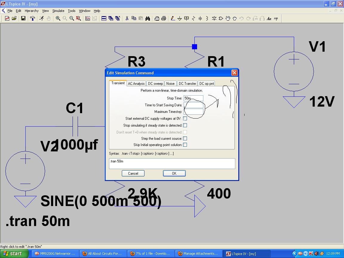

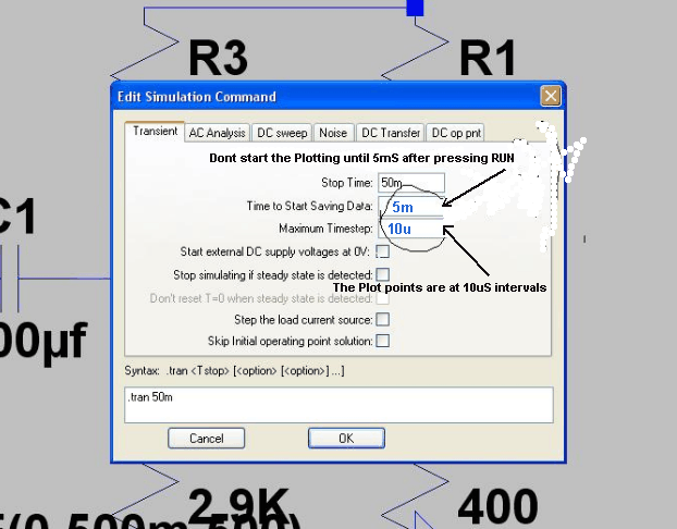

Hi, pls. tell the use of this option in LT spice as shown in image and how to make it JPEG as it don't show save in JPEG format..!!
Thank's.
The screen saver software is very good, as i was using print scree option before but i don't understand why it does not capture video with background images??
Thank's sir, for helping but tell the use of time to save data & maximum time spend what the need of it in lt spice??
