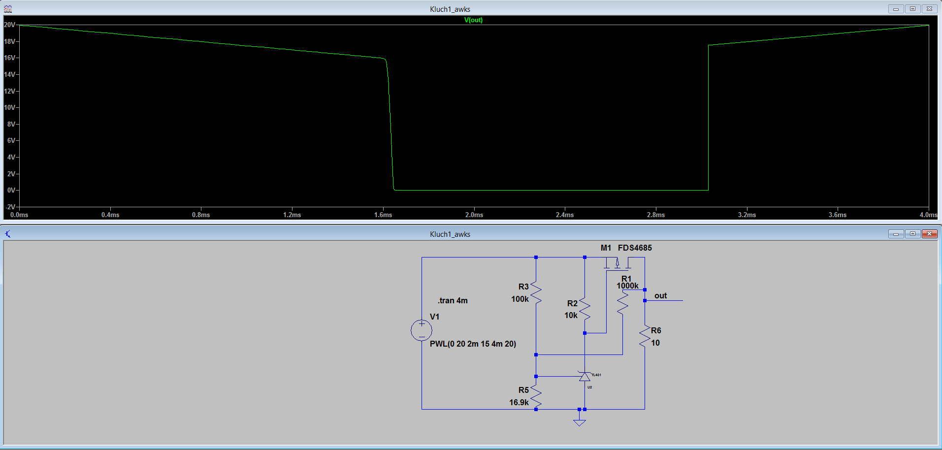

What does this mean?
The Green line is the Input from the source and the blue line is the output.
They cross at my desired shutoff voltage???
What should I do to fix it??

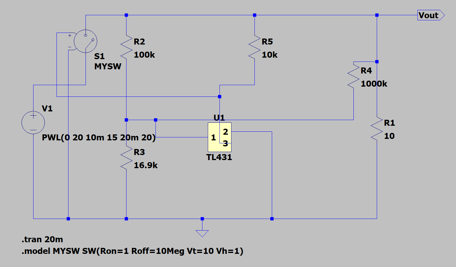

I am trying to get a complete low voltage cutoff using this schematic...
Can anyone tell me what is wrong with this one?
I am using the voltage controlled switch as a relay...
The way you have S1 connected, there never is a voltage from V1 applied to the circuit.
S1 should be moved to just in front of Vout.
Why did you move the switch's position from that shown in post #13?
Also the polarity of S1's control input is reversed.
As connected, S1 will be off when U1 is on (high battery voltage condition)..
A P-MOSFET, connected as shown in post #13, is ON when its gate is pulled to near ground, and OFF when the Gate is near its source voltage.

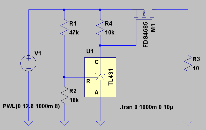

Refer to #13
According to my calculations, R6 would have to be a 40W resistor...
Voltage Across it - 20V
Resistance - 10 ohms
20/10=2A at 20V DC...
Amps x Volts = Watts, so this will take a 40W resistor...

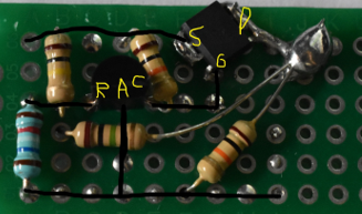

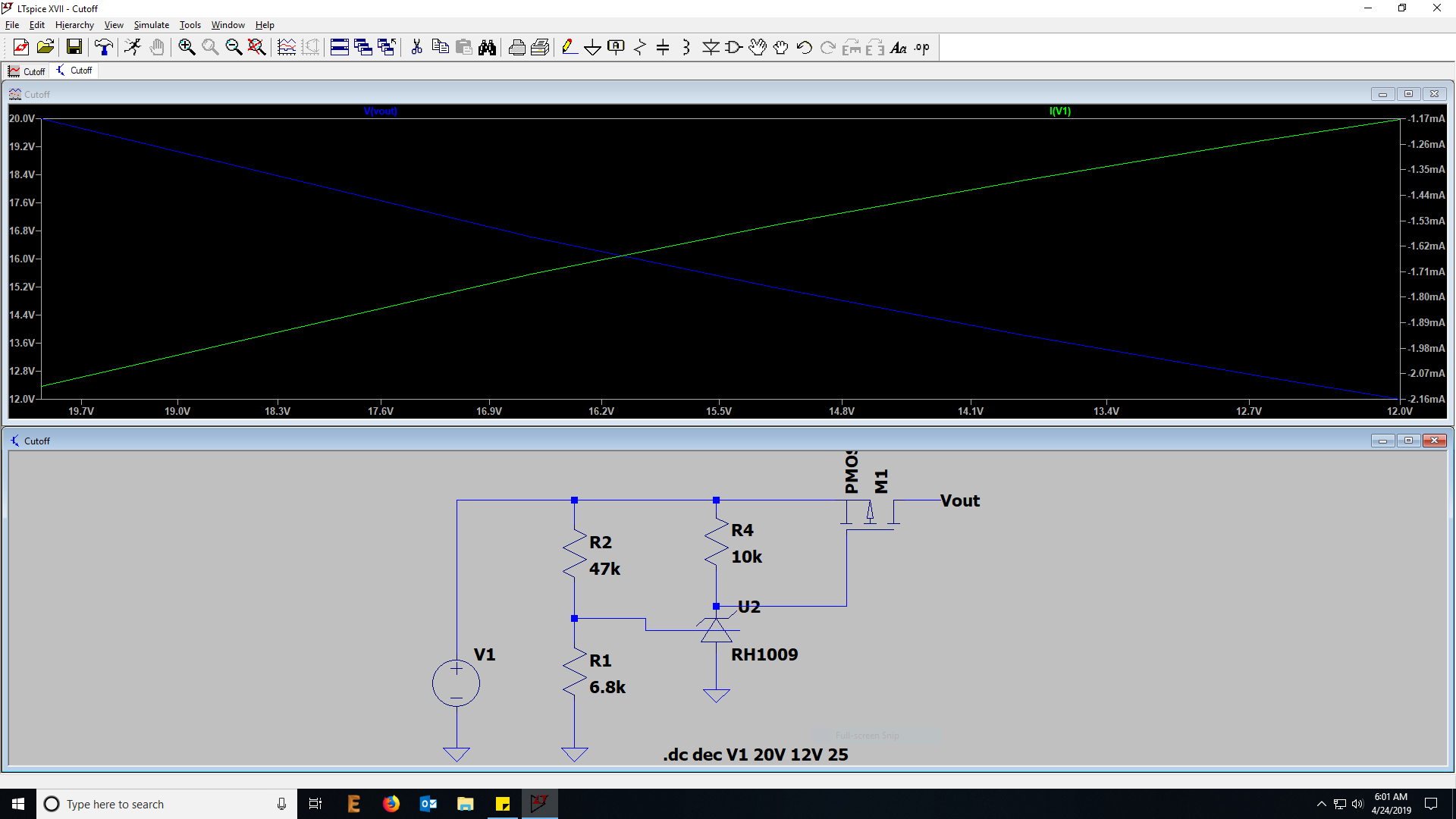

I am using this exact setup, except with a 10k resistor, since my 10 ohm burnt to a crisp...
It does not shut off until about 12V...
These are the links to my parts I bought...
https://www.digikey.com/product-detail/en/texas-instruments/TL431CLPR/296-1290-1-ND/404938
https://www.digikey.com/product-detail/en/on-semiconductor/FDS4685/FDS4685CT-ND/2094417
https://www.digikey.com/product-det...cs-inc/RNF14FTD16K9/RNF14FTD16K9CT-ND/1975110
and then I just used my own resistors...
Can anyone tell me why it doesn't shut off at 16.1?
