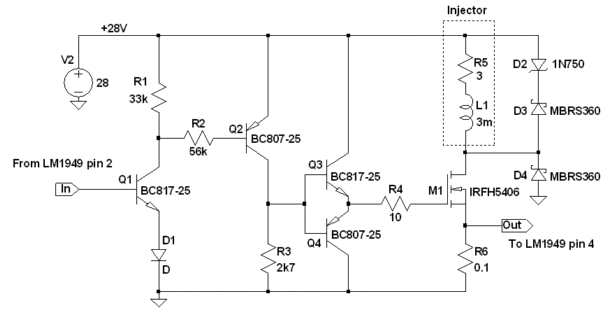

I have to build a low impedance driver. The LM1949 is ideal for this application but I would like to use MOSFETs instead of DARLINGTON transistors to drive the injectors. I am not sure which changes I have to make to achieve a correct working.

I agree with Crutschow (post #9), but if you still want to use a MOSFET instead of a Darlington here's how you could adapt the LM1949 output. D1 is included so that the LM1949 'sees' a simulated Darlington. Q1 and Q2 provide level-conversion. Q3 and Q4 are a push-pull low impedance driver for the FET gate. R5/L1 are an arbitrary model of an injector. D2 reduces the FET turn-off time, at the expense of a rise in the FET drain voltage.

Alec, I think the LM1949 operates in linear mode for the hold current so the level shifter might not work.
Quite possibly. I am assuming the current sense resistor is used in a negative feedback loop, so the level-shifter would be automatically adjusted to compensate. Not having a model of the LM1949 I can't simulate the whole control loop.

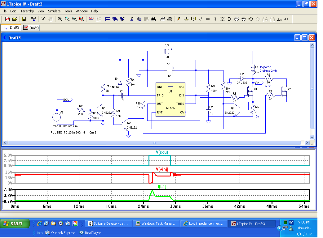

Ahh, I see your problem. The 28 volts makes the power dissipation in the darlington go thru the roof.
Here is a little circuit that might work. The power is still lost but in a resistor instead of the transistor.
In looking closer at the datasheet it looks like the chip can be run in PWM mode (though they don't push it) Have you thought about that option? I'm not sure you can get your ratios between pick and hold -- but.....
The way this circuit works is the positive going pulse from the ECU fires the timer. It is set for about 5 ms (much longer than the time it takes to get to 6 amps). At the same time the hold current is turned on. When the current gets to ~ 6 amps the timer gets reset turning off the "pick" current. The hold current stays on (thru the 5 ohm resistor) until the ECU pulse goes away.

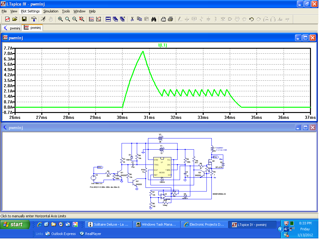

THANK YOU very much for your great help guys. I will try to build a pwm controller and check if this work. I have built my own logic control output using two comparators. Through a senser resistor I measure the voltage and using two comparators (one for the peak current and one for the hold current, this comparator with hysteresis) and some logic gates. I am not sure if this will work... What do you think?
Ronv's solution is a good workaround if you just need to relocate the heat. Is the problem that you have limited electrical power on a fuel injected engine that has a 28V supply rail? Might help to give us a little more scope on this thing.
Pwm Injector
Here is one that should do it if you don't want a chip. It's getting a little messy> If you can't read it let me know & I'll clean it up.
