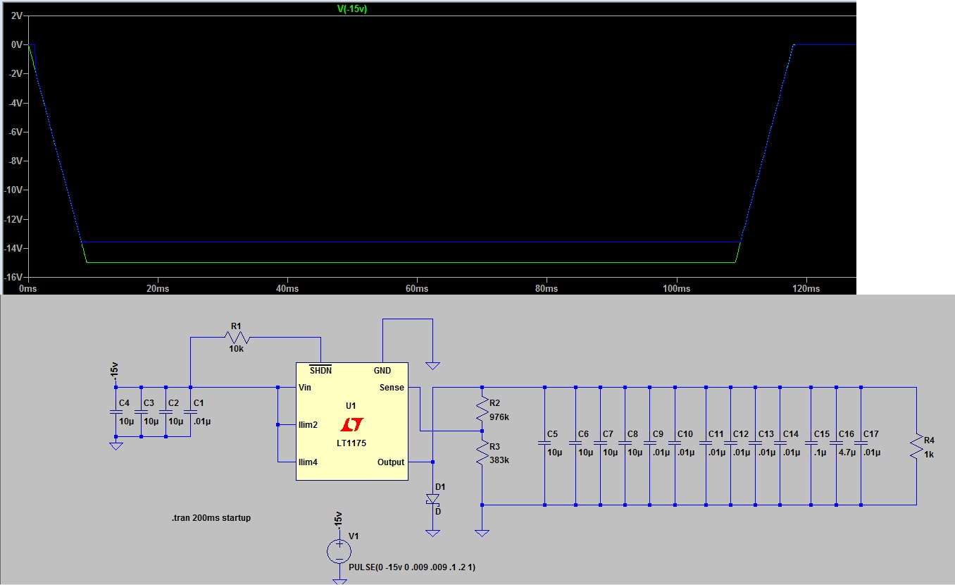

I am trying to figure out why I keep frying Linear Tech's LT1175. Datasheet here. I also attached an LTspice model as a representation of how I am using the part. The scope view is showing the Input and Output turned on and then turned off.
I am strapping this regulator as a -15v to -13.5v DC/DC. Over the past year this part intermittently fails(10% failure) and upon analysis I believe that it's a trace inside the part on the GND pin that is being compromised as when I ohm out a good part vs. a bad part that is the only difference I see between the two.

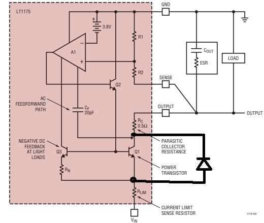

In the datasheet they talk about two ways you can hurt the chip. First is Output Voltage Reversal(page 13) which I have a diode to protect from the output being shorted to a positive supply(or backfed from a +supply). So, I don't think I'm hurting the chip in that way.
Second is the Input Voltage Lower Than Output. (Page 13) I assume that for the LT1175 they have a diode between the input/output. In my attached drawing, do I have the parasitic diode connected correctly? I'm trying to understand what they are warning about on this one. Anyone have ideas? Does it mean that when the output goes more negative than the input the parasitic diode will conduct and damage the part?

parasitic diode seems right.
Datasheet is pretty clear:
"Reverse voltages between input and output above 1V will damage the regulator if large currents are allowed to flow. Simply disconnecting the input source with the output held up will not cause damage even though the input-to-outputvoltage will become slightly reversed"

You protective diode would still destroy the LDO wouldn't it? Since even if the diode clamps the voltage at the output to ground when shorted to a positive supply, there's still 15V applied backward through the output to the input. It would be like a shorted load on the output condition with or without the diode, just.
Seems like you might be able to afford enough voltage headroom to use a series diode at the input instead.
So, for sake of conversation, if you had -15v on the output and -10v on the input the part would fry? That's what they are saying here?
IF ENOUGH CURRENT FLOWS, YES.

You could do destructive testing on some parts in different ways and see which one ohms out the same way. Or maybe you really do short the output to a positive rail 10% of the time:facepalm:
You said that it always runs at least once? Do the ones that fail fail immediately? Or only after running it a few times. I wonder...if you never actually see it fail mid-operation but only when you power it back up again, then maybe it has something to do with the shutdown.
The -13.5V is only supplying a few op-amps as the negative supply input so I'm doubtful that the opamps are shorting positive voltage...but weirder things have happened I suppose.
To be honest I don't have the data to know if it runs at least once. I may have misspoke there. But, I do know that it fails at all stages. So, the part is powered up, pasts tests but then further along the line it fails, from what it seems, totally random.
