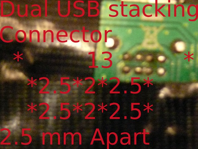

Looking for a Stacking USB type A connector.
KeepItSimpleStupid
Most Helpful Member
Similar to:
Ignore the blue which makes it usb 3. In the photo above, there are 4 tabs connected to the shield. The two i want to replace only has two tabs.
The land pattern is basically:
     *           13          *
         *2.5*2.0*2.5*
         *2.5*2.0*2.5*
The *'s are pins.  The Row pitch is 2.5 mm.
The land pattern is shown below.
All I could find is connectors with 4 mounting tabs. This particular hub got wet and the pins are corroded on two of the connectors.

Can you just bend the 4 tabs and peel back the solder mask a bit and then solder it over the board (Toplayer)?
The land pattern doesn't fit either. Most of the ones I've seen had the tabs in the middle of the double rows. Doing a look at images.google.com didn't reveal anything either.
It really doesn't matter, I got a replacement hub for pennies. Nearly all of the possibilities I found had 4 tabs.
Connectors often have annoying differences like this to avoid copy infringements for the shield.
But a 4 tab inset makes most sense for mass soldering and mechanical alignment. (did U try AUK?) nevermind 500pc min.
