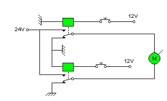

Why make it complicated?
You only need two relays per motor.
Connect them up as per my attachment.
Of course you could just use SPDT switches but the current might be too high to get ones that can easily fit inside a hand held controller.

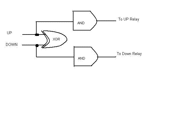

I'm going to piggy back this thread for a question, can someone show me a circuit that can run 2 motors simultaneously? The catch is that the only one motor will run at a time (ex: a motor gets to a certain point and then allows the next one to run). But the order that the motors run is reversed with the opposite polarity.
Also, if you want my suggestion, I'd use XOR or XNOR gates.

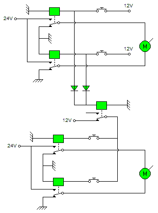

Also it would be ideal if both motors could not run at the same time as this would really tax the batteries.
That should be simple enough: use another relay or pair of switch contacts to disconnect the power to the other motor's relays when a button is presses on the other motor controller. I'll post a schematic but have a go figuring it out for yourself first.

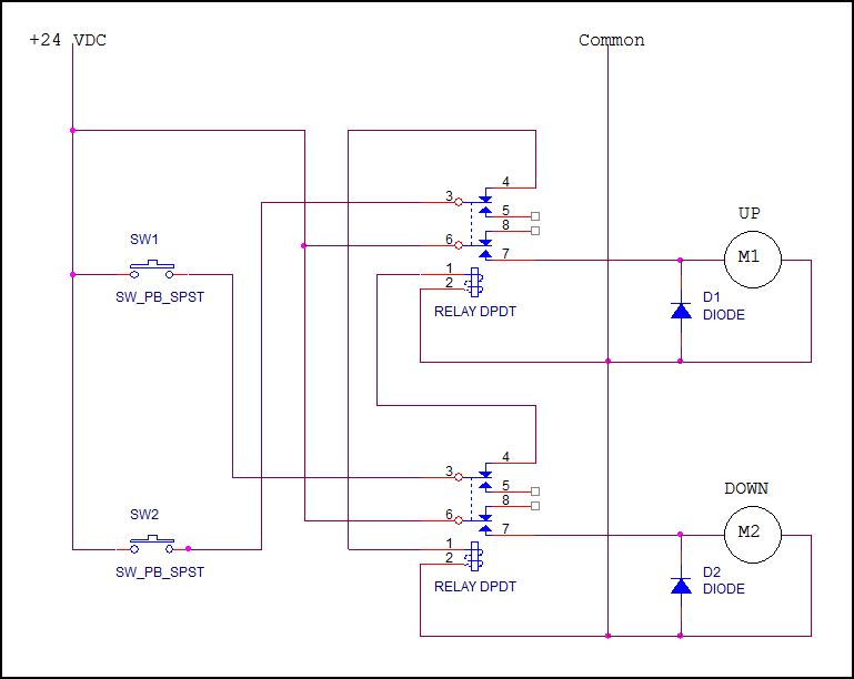

OK, I am going to make a few assumptions. My experience was with an old hospital bed here years ago. It used single motors for each controlled position, meaning a single motor handled Up/Dn by reversing polarity. You seem to imply a single motor for up and a single motor for down so I'll hold that thought.
Now when it comes to things that involve patients, invalids, and anything like that personally I would not screw with chips and logic with gates. I would use relays, simply because being mechanical they are more a definite purpose device.
Most pendants for controlling motors in cases like this have mechanical linkage to preclude any two buttons being pushed at the same time. Pressing any button locks the others out mechanically. Additionally for safety (mechanical linkage failure) they use plain simple relay logic, They are configured like the attached image (a little crude but you get the idea).
Since you mention 24 V motors I assumed 24 VDC and thus went with 24 VDC relay coils. If the Up button is depressed one motor will run. If the Down button is also depressed the down motor will not run. If you look at the drawing you will get the idea.
Ron

Hi Ron,
No mate, one motor for up & down and one for back and forwards, two motors in all, sorry if I misled you, it wasn't intentional.
As to the hand control, it is a flat box with membrane type momentary switches on it and there is nothing at all to prevent two or even all the buttons being pressed at once, that is the only reason I thought of logic.
All input appreciated.........Al

You don't need any logic gates.
You could use a couple of diodes and another relay. Obviously the other relay doesn't need to have a very high current rating.
