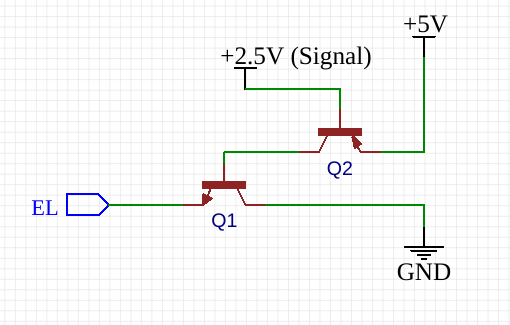

How to have EL HIGH when riding, and LOW when braking? My idea was this:
120607
I'm wondering whether this is a good solution, is it possible in the first place, does it need some adjustment or some pull-up or -down resistors?
Any thoughts or help are highly appreciated!
TIA,
Mark

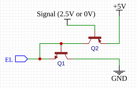

The input needs to be low (to disable it) when the brake signal is high (brake on) so an inverter is required. In you circuit above replace the mosfet with something like a 2N2222 or 2N3906 with a 1800Ω (1k8) resistor in the base line and see how that goes. Are you able to measure the current between EL and Ground in case it's not a simple pullup?

What you show should be a N mosfet not a P mosfet.
The brake signal is supposedly LOW when the brakes are on?
Indeed; when I measure voltage it is:
while active (LED is continiuously ON, this is the signal which is forked): 2.45V
while braking: (Led still ON, and enhanced by braking Light): 0.00V (maybe 0.01V, in fact LOW)
Which way around did you connect the diode?
Eventually I connected it both ways, initially conforming your suggestion. Neither worked.

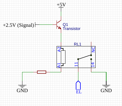

Just returned from local components shop with a bunch of 2N2222, a switching relay and some optocouplers. Hope that will do :D
Assumptions: 2.5V signal is 0V/2.5V, Relay has a 5 volt coil,
Assumptions seem to be allright.

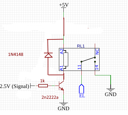

Moving the 2N2222A after the coil: I can sort of understand why.
What puzzles me is the diode (1N4148). What is it doing, why is it there?
I hope you can clearify, so I can learn.
TIA!
It's to prevent the back EMF from the relay coil blowing the transistor - it's an absolutely essential part, and a VERY basic circuit - you should never see a relay fed from a transistor without one (although it may be hidden where you can't see it - I bought some DIL reed relays recently, they have the diode built inside).

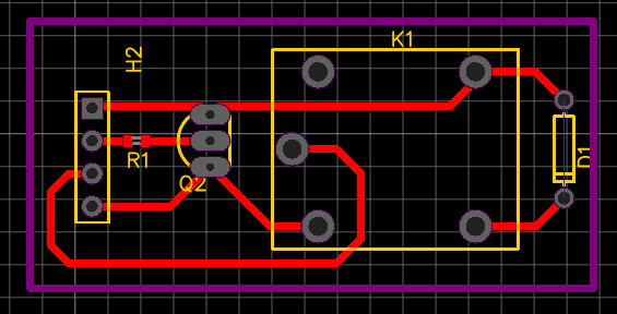

I'm designing a PCB right now, based on the schematic of ronsimpson.
If you like, you can view, review or even contribute: here.
