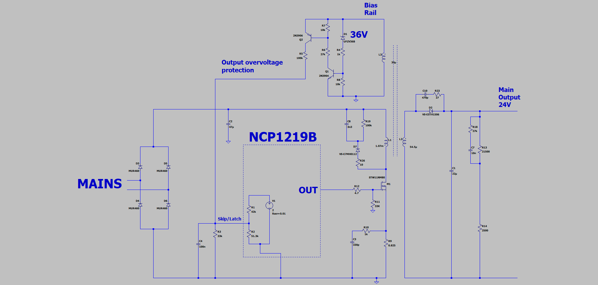

**Question 4..**
Would you say the below output overvoltage
protection circuit is OK? How much current is it safe to
put into the latch/skip pin? Datasheet doesnt say.
Output overvoltage protection for NCP1219B...
NCP1219B
