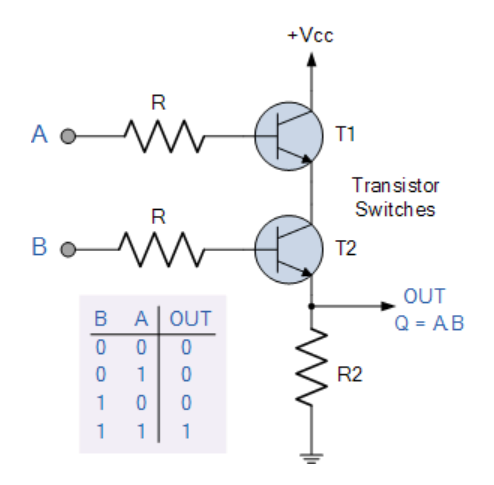

So, this is what I need to build?
120788
I do understand the working principle of this setup. But to complete it with values and types (T1,2 and R1,2) is yet another gray area to me.
Any suggestion and clarification is highly appreciated!

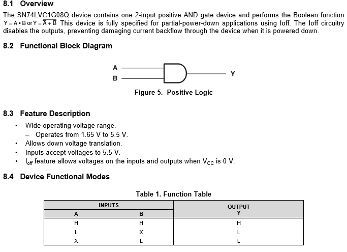

The two transistor circuit is "ok" but the output will be 0 and 1.7 volts. I think that is too small.
Data sheet SN74LVC1G08. Is a AND gate. Logic levels on input. below 1.5V=0, Above 1.75=1 when using a 5V supply.

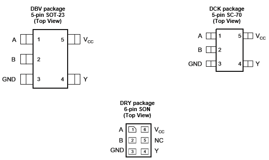

Comes in this small package. Surface mount may be hard to use.
120791
The SOT-23 package is the largest. The SON package is hell to use.
Have ordered them, going to layout a board on this chip, thnx!
EDIT: Very nice collateral pro: output is VCC, so the desired gain/amplifying (which brought me to my latest scheme) is not neccessary anymore. Looks like a briljant tip!
