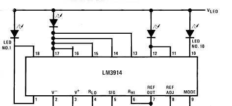

lets say that we have 10 led in lm3914
We have select it to use it in dot mode and in step of 0.5 volts
0v= zero led
0.5v= 1st led open
1v = 1st led turns off and the second led goes on ...
Lets say now that we want to inspect 0,5v 1,5v 4v and 5 volt
For that we would use the 1st, 3d,8th and 10th led and we would not connect any leds to other pins of lm3914
But in this way when have 2volts input the led for 1,5v will go off until the 4v come and lm opens the 8th led..
can we made this in order to have always the led on before the next step we want to inspect??
i think that it can be done but i am not sure if i have to place a diode to the pins in order not damage the lm3914

You can connect as per your drawing, but you will a slight dimming of the LED's as they step from one pin output to the next,,, try it.

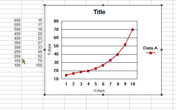

Based in gauge readings depending from resistances i placed we have :
600F = 15k
550F = 17k
500F = 19k
450F = 20k
400F = 23k
350F = 27k
300F = 37k
250F = 40k
200F = 52k
150F = 70k
100F = 150k
Those readings are non linear, it looks like a thermistor.
I will relook at the design.
EDIT:
Look at this plot, I have dropped the 150K/100F in order to expand the plot.
I think the 300F/37K is incorrect in your table..I make it 33K

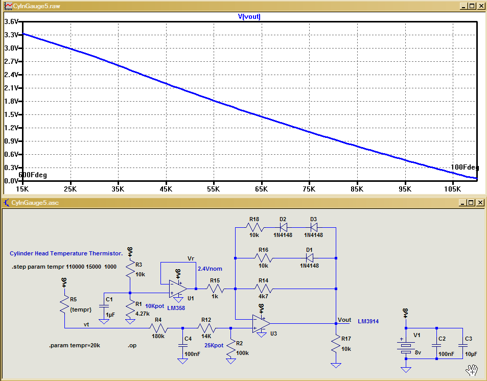

Let me know if you can power the thermistor from +8V.???
hi caslor,
Look at this with thermistor powered from the +8V [and electrically isolated from the engine block]
Set up the LM3914 to suit the Vout.

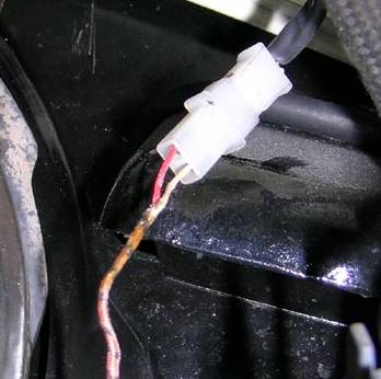

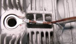

Ericgibbs for one more time you save me ;)
Yes we can power the thermistor from the +8v.
The thermistor is a washer that goes to the spark and has two wires at the end.
I think it is electrically isolated from the engine block as we havent any electrical issues until now that it was powerd with +12v
here it is 2 pictures from the sender and the wire :)
