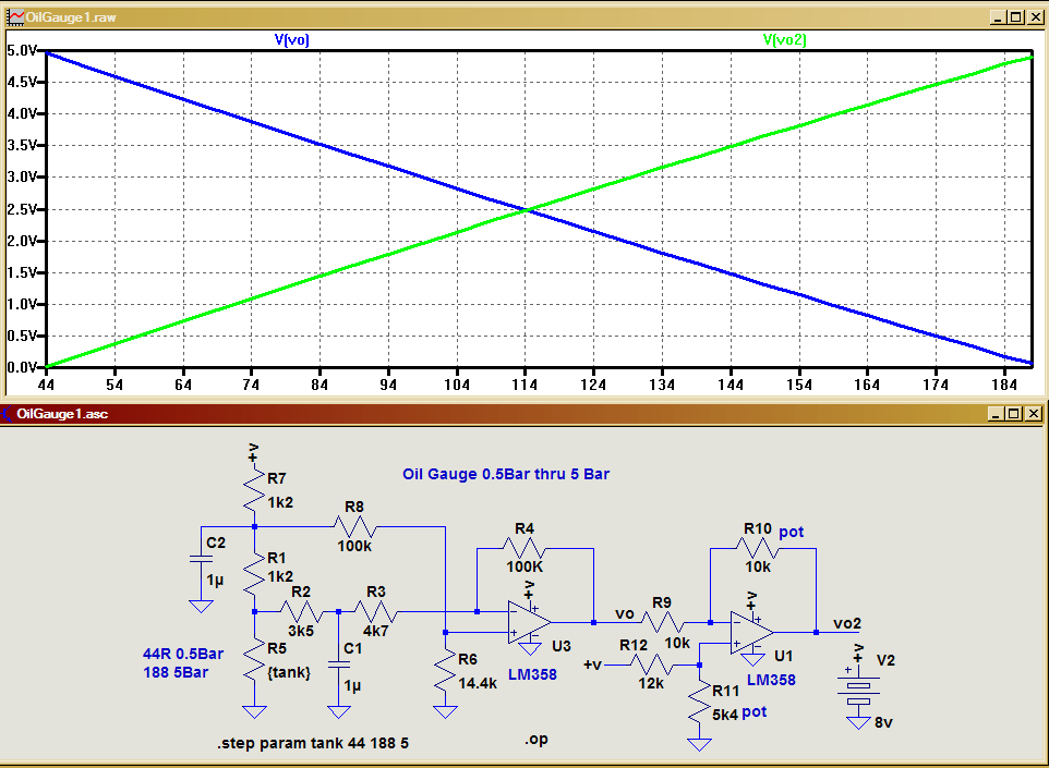

Its possible to roughly approximate the curve of the gauge by using opa's before the LM3914.
I'll take a look later on.

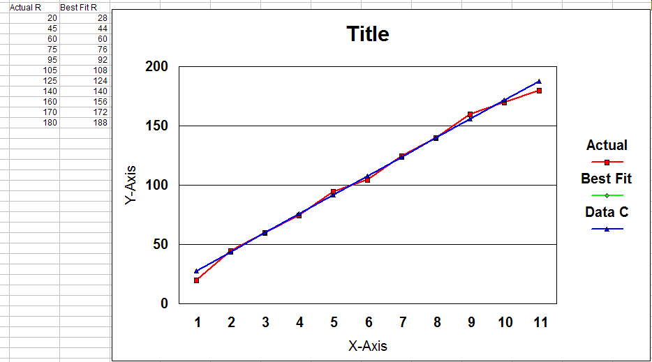

This is a plot of the actual and best fit of the oil gauge resistance.
The 20R at 0Bar could be dropped, leaving 10 values to be displayed on a LM3914.
With the exception of the 5Bar value I would say its an acceptable fit.???

Wow !!
even 5 bar is acceptable ;)
i check them with a bar gauge i have for this sender... i place the values of ''Best fit R'' and gauge shows exactly the bar for each R
it is amazing what a person can do if knows electronic theory ;)
Thanks for one more time ericgibbs for all this time you spend from your time to help me :) :) :) !!!

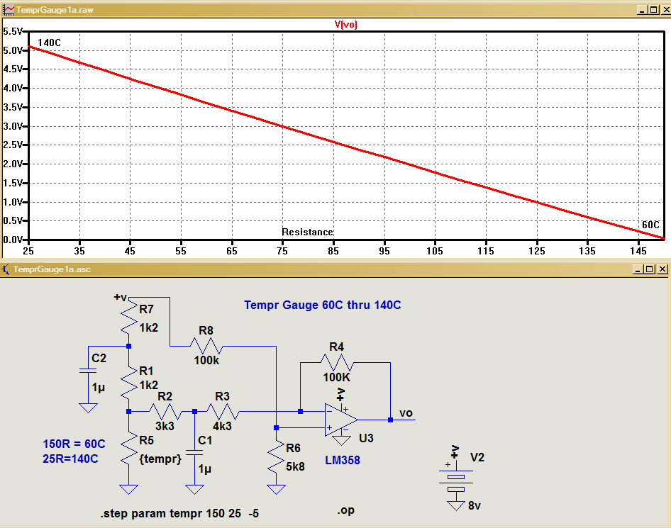

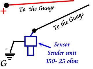

This is something similar like the oil gauge but this time is measuring temperature..
the sender unit is ground it in the engine and sends the negative to the gauge as a signal through a internal resistance it has that changes as the temp rises
could you check this one also ;) Pleaseeeeee :)

You can easily delete and replace those ca3140 in the asc file and replace them with a LM358.
Ref the Tempr, when you say negative from the tempr sensor I guess you maen the 'slope' is going down from 150R to 25R as the tempr increases.
Yes the 'slope' is going down from 150R to 25R as the tempr increases.
The ''negative from the tempr sensor'' i refer that the sender is ground to the chassis like the other 2 examples we have looked until know (gazoline sender and oil pressure )
That last circuit I posted should be OK.
Delete the CA3140 and replace with LM358 and you can try out ideas.

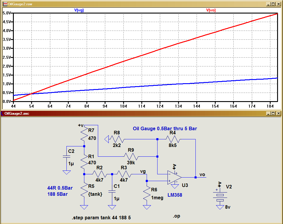

I think i find the best setup for oil-bar gauge
Based on schematic in post #67 i change the R4 from 100k to 90K and setting lm3914 to 0,48v step i think i get the best option..
specially for low bar pressure that most of the times engine runs

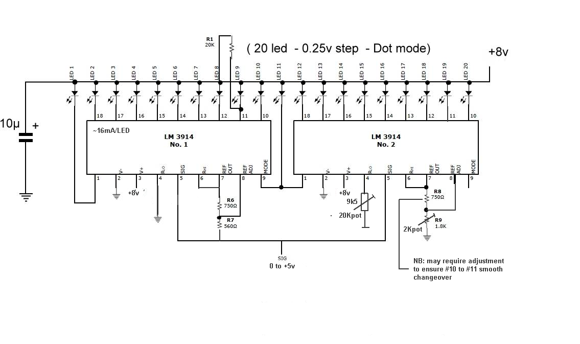

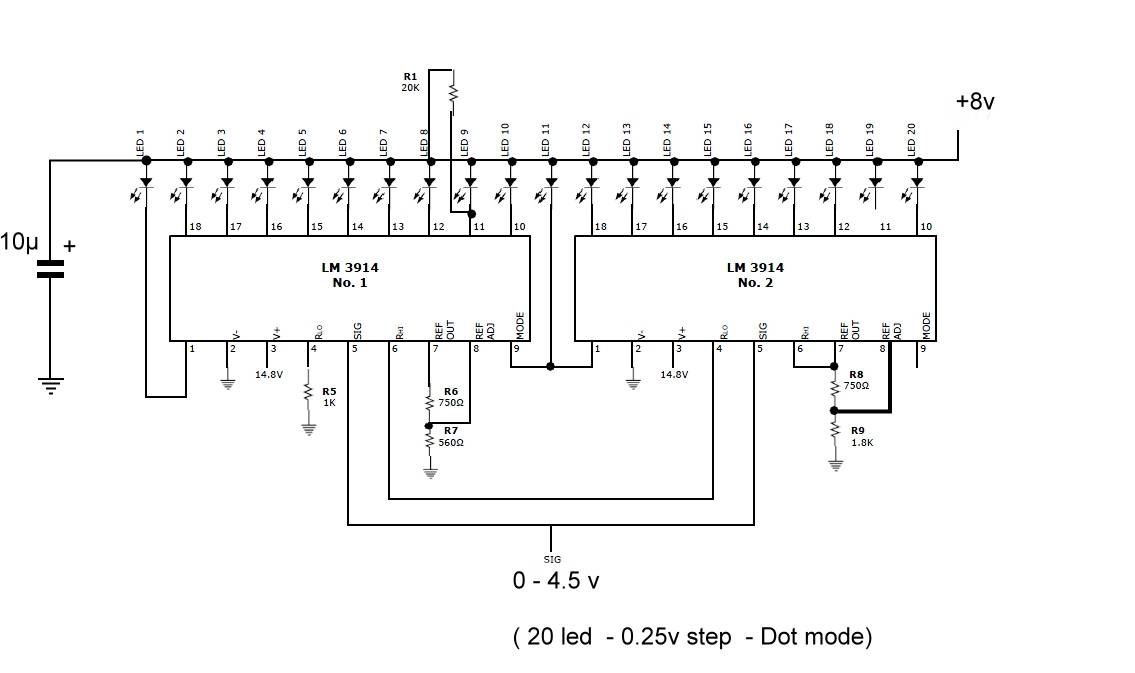

Hi
oups... here i am again :( :( for one more time asking for knowledge-help
i decide to use 2 lm3914 for temp guage to have more accurate readings .
i will not use all the leds just the ones that are close to the temps i want to display...
in the schematic what resistance should i place in order to have 0.25v step to the leds?
From program about lm3914 i saw that have to use R1= 1.18K and R2= 1.10K
But dont know if that can be used in this setup with 2lm3914
so here i am again asking your help :)

Ps : in the drawing i saw that i have left 14,8v power in pin 3 of lm
this is wrong... i will use the 8v i have for all my circuits

hi Caslor,
Look at this diagram.
Note, the LM3914's do vary in one to another, so the pots I noted will be required if you are to get a smooth transition from #10 to #11 LED's and also to maintain equal brightness from bank#1 to bank#2.
