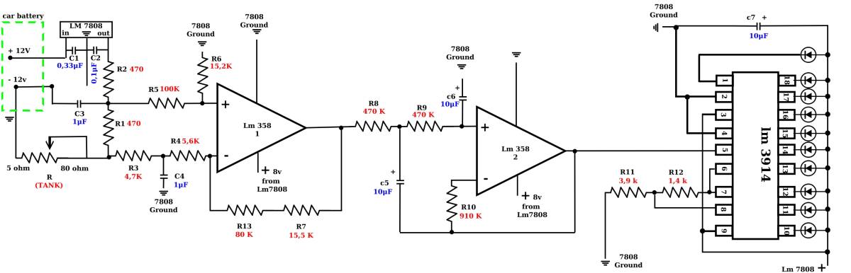

hi agu,
I have already told the OP that only one Vreg is required, post #40.
Ref using a 7805, the OP is using LM358's and he requires a upper OPA swing of +5V, thats why a 7808 has been recommended.

audioguru i use the capacitors just i remove them only from the drawing .
what about the fuse number? should i use smaller ? bigger?
(The project is to make a board that will have 6 circuits using lm3914 ( tachometer, gazoline, oil temp., voltometer, oil presure, cylinder temp. )
This is my final schematic ... i think it will work :)
Looking better.
I would add some protection to the 7808 regulator and a little extra smoothing to the +8V.
With ref to R11 and R12 if you make R12 =1K and R11=3K6 this will set the LED current a couple of mA higher and make them slightly brighter

THANKS !!! :) :)
Questions now :)
If i supply 6 circuits with the same Lm7808 have to use an other capacitor ? (the one we use for extra smoothing +8v )
The same with the fuse...if we need bigger one than the 2A

One cap near the7808 will be OK, but dont forget the 2.2uF or 10uF required near to each LM3914.
The 7808 is rated at a max current of 1 amp, so providing the 6 circuits do not draw more than about 150mA each at anyone time, [which is highly unlikely] the 7808 should be OK.
When the full system is running, check the temperature of the 7808, if it running hot, fit a heat sink.
So the 2Amp fuse should be fine, locate it near to the battery.

The fuse box i am planing to place it on the board before the Lm7808 ( the board will be powered from the cars fuse box.. so working only when the key is turn on )

I was thinking about the 2 resistors in the Lm3914 lets say that we have the R12 resistance in my drawing..
add a stable resistance of 1k and add in series with this one the trimpot with 1k so can adjust it for accurate reading
or with 100R trimer could simulate my tanks 5-80 R and didnt have to remove every time the floter from the tank to move it and see how the lm3914 reads :p

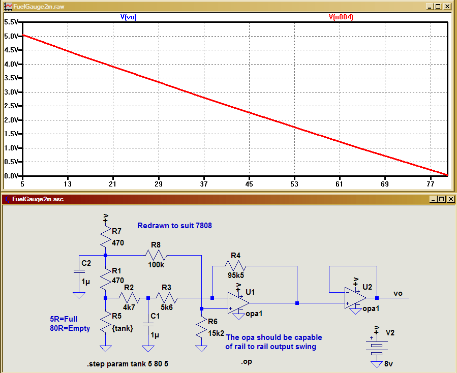

in the resistance R8 95,5K (post #42) we can use any pair of resistors we want so that can tweak the gain/slope of the sensor opa output ?
lets say 82,5 K + 13K = 95,5 K or 75K + 20,5 K
Right ?
i download the Ltspice iv - program so make the same schematics and be easier to understand them ;)
is there anywhere inside component for Lm7808 , Lm2917N 14 pin, Lm3914, Lm 358 ?
Very nice program even i dont know to work it... :p But makes drawing schematics more easy than Photoshop :p :p
Any combination of fixed resistors can be used to make the final final.
On amplifiers I prefer to split the feedback resistor into a fixed and variable section.
Its useful to have some degree of adjustment on this type of project so that the output can be set exactly how you want it.
Ref LTS, I would sign up for the Yahoo LTspice users group, its free, they have most of the models you are asking about.
I have not seen a 2917 or 3914 model, but a web search may show one up.
