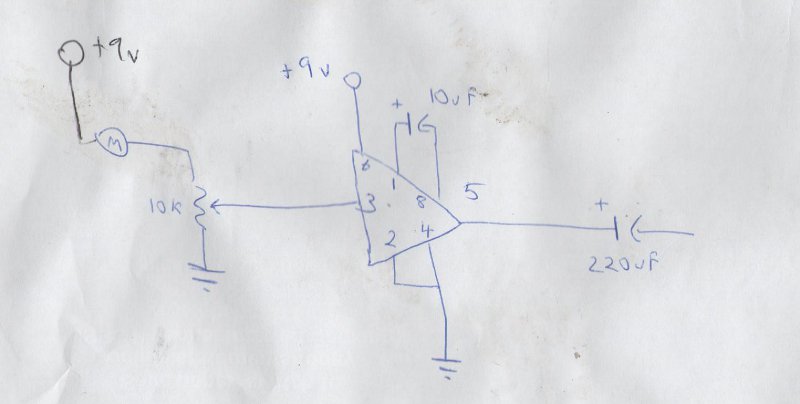

The LM3916 part is working just fine, but I've having problems with the LM386 - the output on pin 5 hardly varies from around 3.7v
I've tried stripping it down to a very basic amp, as shown in the attachment. If I place the mic an inch from my mouth and hum loudly, I can just about get a swing of 0.4v
Have I just got a really lousy mic, or is there something wrong with my circuit? With that capacitor over pins 1 and 8, I should be seeing a gain of around 200, right?
That's what the datasheet says:). So your swing of 0.4V implies a mic signal of 2mV. Maybe ok from a dynamic mic, but an electret should give much more.

Have you tried reversing the leads to the electret? They are polarity sensistive.

I didn't realise electrets has a polarity. This one has no markings on it, and legs on it are both the same length. Still, I've tried reversing it, but no improvement.
Think I'll get an electret from another source and see if it's any better
Maybe you have an "un-amplified" electret (low output). Some have a FET preamp built-in. DigiKey has a bunch.
An electret mic has its ground pin connected to its metal case.

Whoops, forgot the attachment in my original post. I was a bit skeptical of the instructables schema too, and the attached image was an alternative lm386 wiring that I'd found.
The alternate LM386 wiring is completely WRONG and is completely different from circuits in its datasheet:
1) The ground pin of the electret mic does not connect to ground. Then it connects to the input of the LM386 amplifier and it picks up mains hum.
2) The volume control has the current of the electret mic in it (0.5mA) which biases the input pin of the LM386 to a voltage as high as +5V. But the input pin of an LM386 amplifier is supposed to ALWAYS be 0VDC so the output will be saturated near ground then it will not amplify.
3) The RC zobel network is missing at the output so the amplifier will oscillate at a high frequency.
