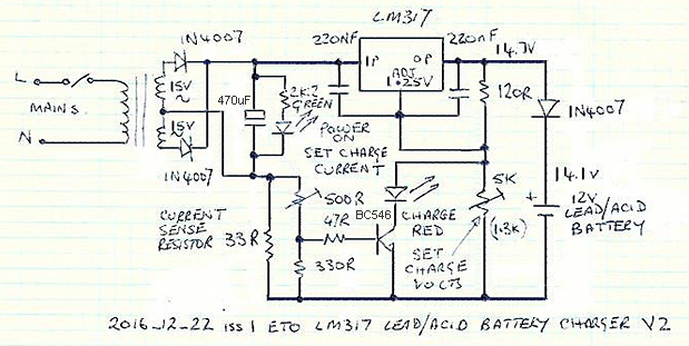

Hi again BM,
Below is a circuit I did for an LM317 battery charger for you to look at. It has reasonably accurate current and voltage control.
There is no 'Charge Complete' indicator, but when the red 'CHARGE' LED extinguishes, the battery is charged.
There is also a green 'POWER ON' LED.
spec
Spec,
Glad to see you removed the "R5 100 ohm 1/2w" resistor". Before it was inside the feed back loop. (from post #1)
I thought about moving your "120R" so it see the battery voltage direct. (post #8)
The 1N4007 could be any part in that family. 1N4002 is fine.
Looks good. With the red LED on it charges at constant current mode. Then with the red LED off it charges at constant voltage mode.

Hy Ron,
I couldn't resist having a go at this one. Using an LM317 for battery charging is always a challenge.
The original circuit was quite interesting- did you read the write-up on the original site?
Yeah, I considered sensing the battery voltage direct, but in the end thought an 1N400x outside the voltage control loop wouldn't do too much harm.
Eliminating a reservoir capacitor on your PSU design is a big size, cost, and reliability benefit.:)

Hi again BM,

Thanks again Spec,
I'll give this a try. I have some 12 and 6v batteries and the plan was to adjust the 12v charger (once I got it working) down to a 6V charger. I don't see that as a problem on your design unless I'm missing something. As far as the one I got from the internet goes, I think R1 was there just to keep the sense resistance at at least 1k. I wasn't using on the breadboard since it didn't seem needed. I now realize that the red LED is on when charging and not when complete because the Zener goes into reverse bias as soon as the voltage is high enough to charge so could never work like it was designed to. I did not have any trouble bringing the charge voltage up to over 14 volts and it does charge the battery. Except for the 1n4007, everything to the right of the schematic is useless! Well, that's not completely true, the LED emits, so I can tell the circuit is on:confused:
Thanks again Spec,
Hi BM,
no sweat.
I think the circuit will adjust down to suit a 6V lead acid battery. Just set the charge voltage to 7.05V and you are done.
The current limit, with the current limit potentiometer set to zero Ohms is 0.6V/33 Ohms = 18mA and increases as the current limit potentiometer resistance increases.
I hope the circuit works OK
spec
Just a quick update;
The charger I gave the schematic for will work as advertised if the cathode of D6 is on the other side of R5 (closer to the battery). I imagine R4 would act as the Zener's current limiting resistor. Of course it probably still has the same deficiencies that have been pointed out, but at least I got it to work.
