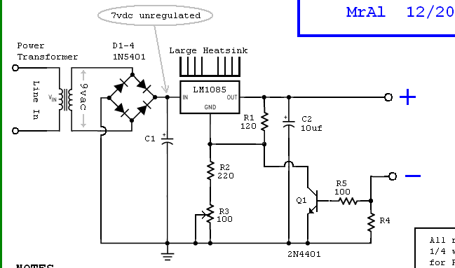

Below is a circuit I did for an LM317 battery charger for you to look at. It has reasonably accurate current and voltage control.
There is no 'Charge Complete' indicator, but when the red 'CHARGE' LED extinguishes, the battery is charged.
There is also a green 'POWER ON' LED.

Are you getting "14.7V"? What is there? I am trying to find out if the LM317 is working?
Is there 1.25 volts across "120R"?
2016_12_22_iss1_eto_lm317_lead_acid_battery_charger_v2-jpg.103224
The lm317 is working. I can adjust the voltage over a wide range. Also there is about 10v at the collector of the npn transistor .18v on the base, 9.9v between the collector and base and .18v between the base and emitter. I don't think it's biased but I can't quite make out why. I'm a bit weak with transistors, sorry.
When current flows in the battery there is the same current in the "33R" resistor.
It takes (0.03 amps approx) to make one volt.
Please adjust the "500R" to zero ohms.
A transistor needs about 0.6 volts B to E to turn on.
"500R" and "330R" makes a voltage divider.
>>If "500R" is set to zero then there is 0.6 volts across "33R" the transistor turns on and tells the LM317 to reduce the voltage.
>>If "500R" is set to 330 ohms or about half way it makes a 2:1 divider. It will take 1.2 volts on "33R" to turn on the transistor.
>>If "500R"=500 it takes even more voltage (current) to turn on the transistor.
What is the voltage across "33R"?

So the voltage is adjustable as it is now. I don't need to short the 33R to get it to adjust. The voltage across the 33R is just .2v at 20VDC in. The circuit works the same with or without the 500r pot, 47r,330r,33R, red led, and the transistor. I am using a power supply for the test at 20VDC. So I've not included the 2 1n4007s of the mains. However if I remove only the 33r instead of shorting it, the 500r affects the current/voltage and will make the red led come on with low/no current and off with high current.

The circuit sounds like it is working as it should.
After what you said, I now realise that the red charge LED will only illuminate when the circuit is in the constant current mode. With a light charge current, when the transistor will not be conducting, the LED will not illuminate. That is why removing the 33 Ohm resistor turns the red LED on when only a light current is flowing into the battery.
All the same, the battery charging function will be correct.
Can you set the current potentiometer to zero Ohms and put a discharged battery on the charger. And also connect a 470 Ohm resistor across the output. In both cases the red LED should illuminate.

Yes, that is correct and means a current of only 0.2V/33 Ohms = 6mA. But the absolute minimum current through the 33 Ohm resistor is 1.25V/120 Ohms =10.4 mili Amps.

The way to set the circuit up for charging a 12v lead acid battery is to turn the current resistor (500 Ohms) to maximum resistance. Then connect a 470 Ohm resistor across the output of the charger (with no battery connected) and adjust the voltage resistor (5K) for 14.1V (2.35V per cell) at the charger output. The voltage resistor should not be adjusted again after that.
You can then set the current resistor to the maximum constant current that you want to charge the battery with, normally capacity/10. So, if for example, you had a 500mA Hr battery you would normally charge at 50mA for a good charge and a good battery life.

Here are two charger circuits for 4.2v that have worked well in the past for various people.
Note you can change the output voltage with one resistor and supply a higher voltage input.
The transistor Q1 circuit can be used in either circuit to limit current which eliminates the need for R1 the 30 ohm resistor in the LM317 circuit.
Cant get any simpler than that.
Also, the LM317 can be used in either circuit.
You can see from the dates these circuits have been around for a long time.

Spec, Look at these two circuits. (Thanks MrAl for the second one) It will take 2 seconds to see the error in the first one.
