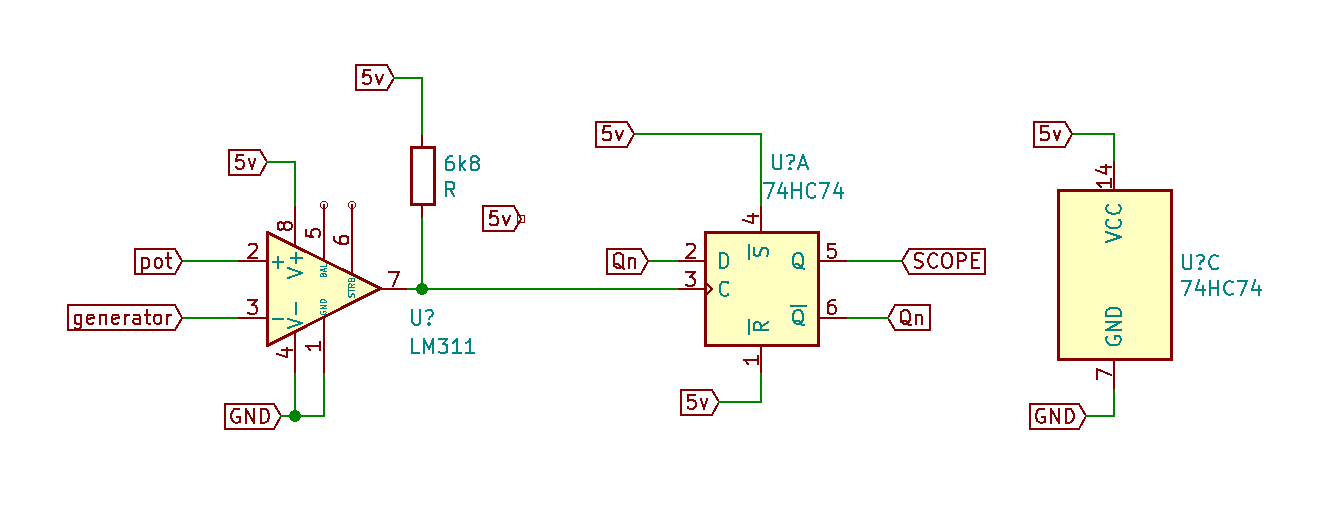

Hello,
I am having trouble with my design. Its not working. LM311 is switching fine but i got just tiny pulse as response at Q 74hc74 output. When i apply signal (square wave) directly to flip flop it changes state. Using FY6900 as signal generator.
Do i missed something? LM311 Low logic VOLT is 0,25V , LO on 74hc74 is higher (up 1-2V i guess).
Check the clock risetime requirements for the 74HC74.
It's maximum at 5V is about 0.7us.
Is the LM311 output at least that fast?
A CD4013 is a slower device and may work better in your circuit.

The problem is that the input can spend too much time at a voltage level where the slightest bit of noise can cause the output state to change again. That noise can come from the output changing, so you can get the flip flop oscillating.

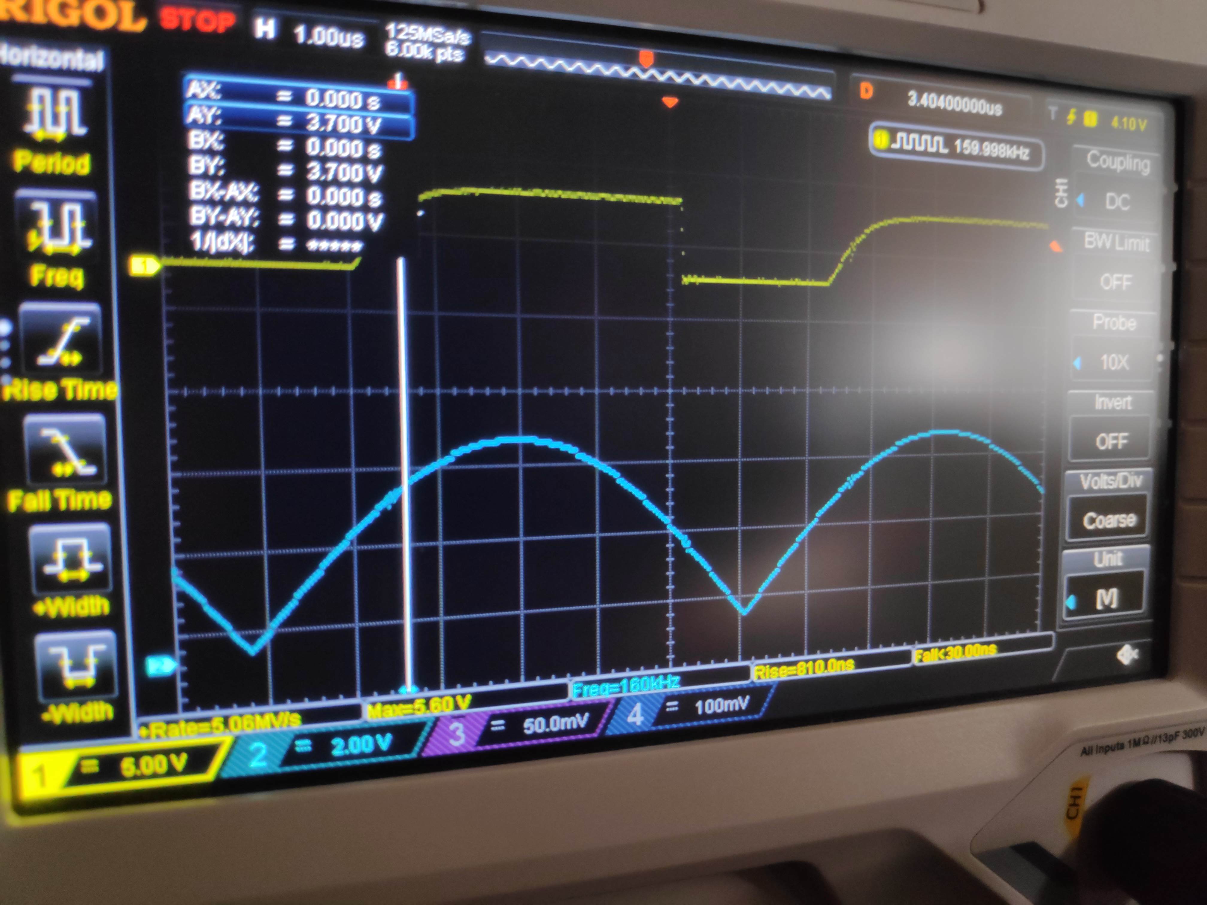

The LM311 isn't particularly quick so it might be too slow for the 74HC74. The specification that I found for the 74HC74 is 139 ns/V maximum, so 810 ns is a bit too slow.
You could try a smaller pull-up resistor, or you could try some positive feedbac.k from the output to the +ve input. You might need a resistor in series so that the feedback resistor has an effect.

The FF triggers at a certain voltage level but it is edge-triggered not just level-triggered, and needs a minimum risetime for proper operation.

Cause i am an amateur :).

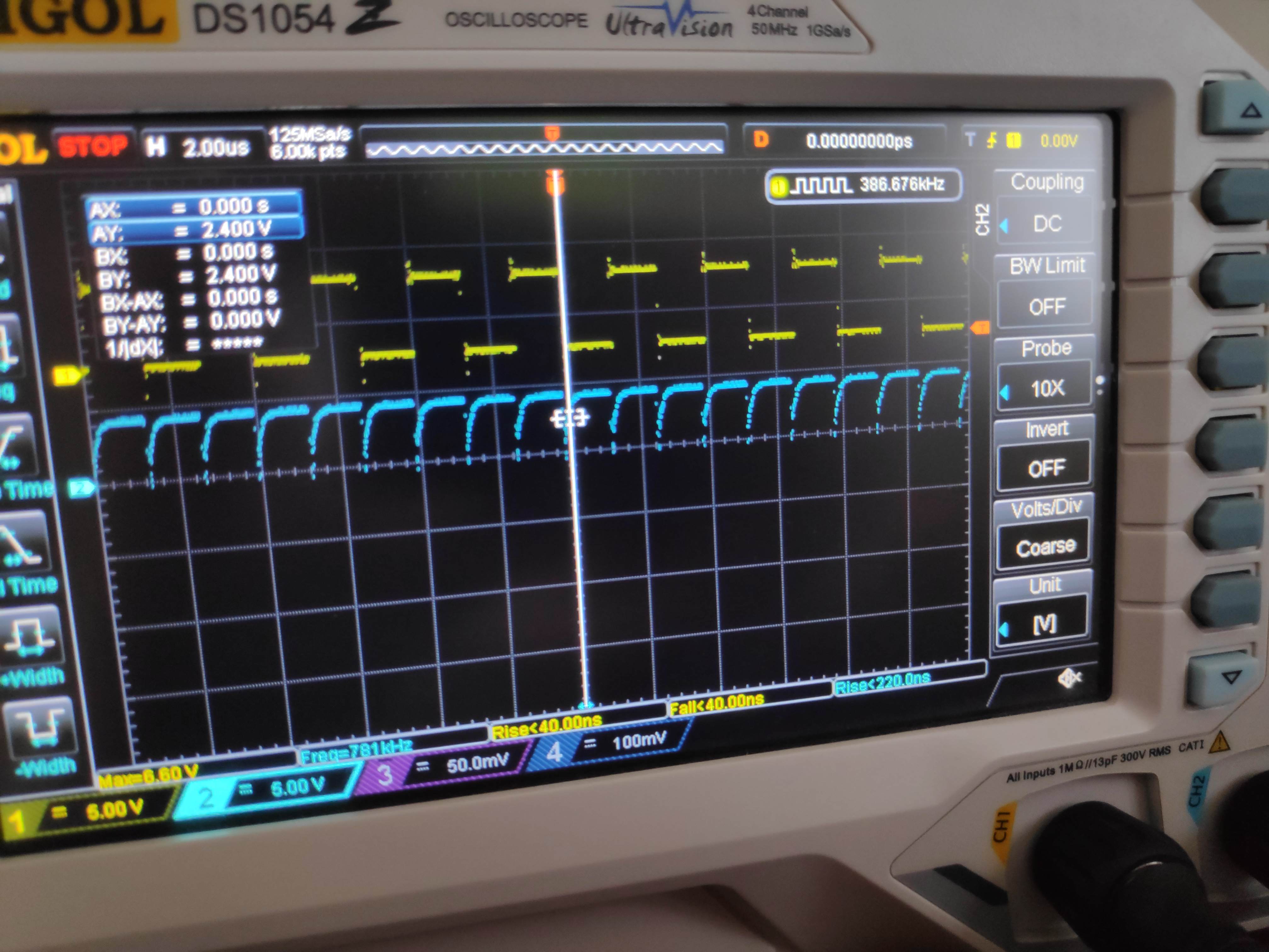

I just played a little bit with exponencial function on dds generator . Yeah it start works when rise time is under 220ns.
So my design was stupid.
