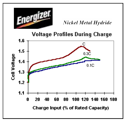

On Energizer's website there is a Ni-MH Battery Applications Manual that shows this charging voltage graph:

I seen that before.
How do you charge it from a solar panel when the current can randomly vary between 0mA up to 200mA?
How would you know that the sudden decrease in voltage is caused by the battery being fully charged and not by the sun going behind a cloud?

The short answer is that you dont know what the decrease in voltage is from, but then again you dont have to know this anyway. If the voltage decreases, that will shut the charging off anyway in both cases. If you really want to, you can monitor panel voltage and current. Note also that temperature measurement may or may not work, because 200ma, if that is even available, may not be enough to heat the cell up much. If the current is lower like 100ma that may not do it at all.
The real question i think is how would we detect end of charge anyway? Notice the graph that audioguru was nice enough to post in his previous post. In that plot we see that for a charge rate of 1C the charge 'hump' is quite pronounced, but for lesser current levels it is barely noticeable. That's very typical of NiMH cells and so that presents yet another problem with charging these kind of cells with a solar panel where the max current is much less (200ma) than the typical 1C charge rate (1000ma to 2500ma depending on cell size and capacity).
This leads me to believe that NiMH cells are not the best choice for solar applications like this. Li-ion are better anyway, as long as the charger is designed right. If the user still wants to use NiMH then perhaps just build the simpler charger with the diode and resistor and let them overcharge once in a while, if that even happens since the cells will probably be used day to day.
Another idea is to use a micro controller and monitor the charge time and discharge time and try to charge the cells only until they are full and that's it. Wouldn't be perfect, but it's a start i guess. Cells would still have to be allowed to overcharge a little, but not as much even if the cells were not used every day. We could also think about this for a while and maybe come up with a better idea.
