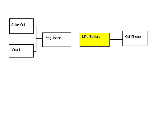

No. I meant the LiPo battery i'm using to charge the mobile phone.. U know, the battery i charge using the Solar and crank shaft. Does it require any special circuit to discharge without getting heated?
I've attached a rough schematic.. I'm talkin abt the one highlighted in yellow.
I know i'm asking too many questions.. I'm a beginner in electronics u see...
What we mean is that there is no need to have a battery between the cellphone and the regulator.
The cellphone has its own battery and charging control. If you supply it with 5 V it will charge, and it won't overcharge.
If you want to store power in a battery, and at a later time charge a cell phone from the battery, it is a lot more complicated.
