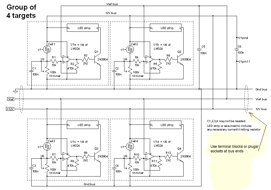

This depends on the physical layout and usage of your targets/panels. If you are going to move the panels frequently then plugs and sockets would be better than terminal blocks for most of the connections. Will the LED strips be remote from the rest of the circuitry, or will each strip be close to it's associated photocell? I can't visualise your layout. How will you avoid paint splatter getting on to the LED strips, or doesn't it matter? Can you post a sketch of your proposed set-up?
BTW, I've edited '9' to read '6' in post #18.
Resistors are 2k2 (=2.2kΩ), 10k and 470k as shown. Axial-leaded type, through-hole 1/4 or 1/8 Watt.
Here's how I envisage 4 targets sharing an LM324 :
Four such groups-of-4 would occupy one 4'x4' panel. Inter-group connection of the 3 buses within a panel would be via pcb-to-wire terminal blocks. Inter-panel connections would be via plugs and sockets. All 64 targets would share 1 Vref generator (cell + potentiometer).
Yes to the diagram, looks good. I could not figure out how to send a diagram but I envision 4 - 4x4 panels in 2x2 formations making up 2 sides butted up together to make an 8x8 wall. Each panel would have 16 targets - in a 4x4 pattern, so your vision is correct as to how to wire in groups of 4.

Ok, here's a list with suggested Digikey order codes for one prototype target :-
2 off photocell PDV-8103-ND
1 off opamp LM324NFS-ND
1 off 100k pot CT2268-ND
1 off 100k trimmer 3319P-104-ND
1 off ceramic cap 399-9776-ND
1 off 2.2k resistor CF14JT2K20CT
1 off 10k resistor CF14JT10K0CT-ND
1 off 470k resistor CF14JT470KCT-ND
2 off 3-way terminal blocks A98334-ND
1 off 100 ft reel 24AWG hook-up wire C2003B-100-ND
1 off small pack 60/40 rosin-cored leaded solder 473-1160-ND [Observe health precautions when using]
Total list cost (excl shipping etc) = $27.48.
The most expensive item is the wire ($14.83). You will need only 2 ft or so of this type per board for jumpers between components, hence ~ 32 ft for all 16 boards. Cheaper loudspeaker wire, or low-current mains wire , will be ok for running the 3 'bus' wires between boards and for interconnecting the 4 panels.
I could not find a suitable strip-board listed by Digikey so you would have to source that elsewhere.

With careful component placement, and mounting the resistors 'on end', you'd hopefully get 2 circuit boards each 100mm x 80mm out of that strip-board. You can do a dummy layout before soldering anything.
64 of those will set you back $1248 (incl shipping). It's not clear from the spec whether light switches the relay coil current on or off. If on (which would be my guess), then there will be a continuous total current drain of 23W just for the electronics of 64 targets, so battery life would be ~halved. The electronics I proposed draw negligible current.
