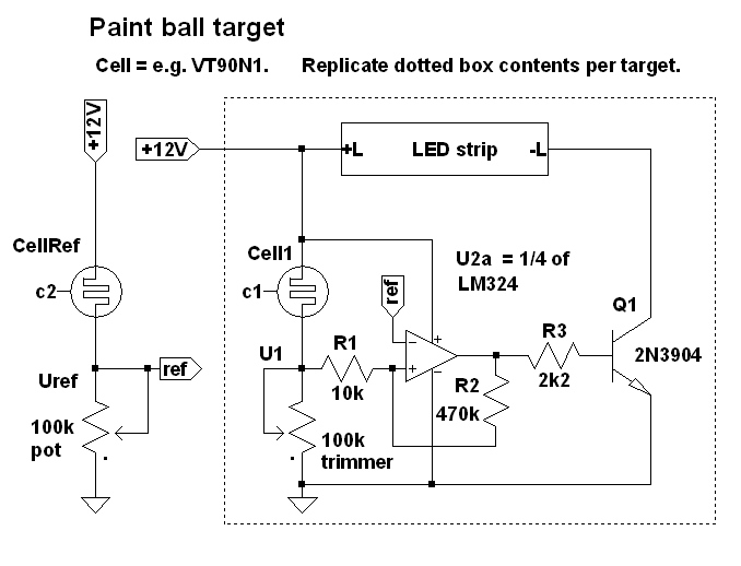

I am designing a target board for my paint ball game. I plan on using an ambient light sensor to actuate a small led light strip to either come on or go off when the light sensor is covered with paint. I have a light sensor made by Vishay (TEPT5700) that may work. The tech at Vishay stated that it only needs light to work, though the documentation sent to me stated that a load resistor of 10 ohms will produce 3-5 volts. I do not want to damage it so I am asking if anyone may know the size load resistor I should be using. The led lights work off of 12v and produce 24watts of power. I used an online calculator to get the other 2 answers - 2 amps and 6 ohm load resistor. Is this correct? I am not an engineer, I know enough, not even, to be dangerous..thanks for the help..

The device will allow a very small current to pass when it is illuminated. When it is covered, less current will pass. You will need to invert and buffer this current with some device(s) (e.g. some transistors) to drive the LEDs
Your calculation of 6 ohms is not relevant to your LEDs. Most likely your LED strip has the appropriate resistors installed to allow it to be connected directly to 12VDC. You should look at the data that applies to your particular LED strip.

Unless you have already bought them or can buy them very cheaply the TEPT5700 is less than ideal for this task.
Something wrong there. Fig 3 of the datasheet indicates that with a collector-emitter voltage of ~ 3-5V the current at 20 lux would be typically ~ 10μA, so a 10Ω load would produce a voltage drop of only 100μV. Do you know the ambient light level at the targets?

I'd use a small CdS cell, such as a VT90N1. This changes resistance dramatically according to light level so is easier to apply. For your purpose you don't need a high-speed photosensor.

Ok. Here's a suggested circuit for 1 target. It may or may not work without modification depending on which photocell you can source cheaply, the precise properties of your LED strips and the range of ambient light levels. I have assumed that a 6" LED strip requires 750mW of power, hence a drive current of ~ 63mA.
I strongly recommend you buy only enough components to build and test one of these initially, before committing yourself to major expense for 64 targets. If any component proves difficult to source we can consider alternatives.
The circuit uses an LM324, which is a quad opamp IC; so one '324 could be used with 4 targets providing they are placed reaasonably close together. If your targets have to be far apart then it would be better to use individual single-opamp ICs instead of the '324. To cater for various ambient light levels one photocell (CellRef) and a 100k potentiometer (Uref) are used to provide a semi-auto-changing reference voltage which can be used as the reference (ref) for all 64 targets. Each target has its own 100k trimmer to cater for the wide sensitivity tolerance typical of photocells.
The photocells would need to be protected from paint contamination by transparent plastic windows/sheet, and if a '324 is shared by 4 targets each cell would be remote from the '324 so would need twisted-pair or screened cable to connect it to the circuit.

That target spacing looks ok for 4 targets sharing an LM324.
Digikey list many photoconductive cells. The cheapest seems to be the PDV8103, which should be fine.

One 0.1μF ceramic capacitor, not shown in the schematic, per LM324 (but if noise pick-up on circuit wiring proved to be a problem you might need 6 per group of 4 targets), hook-up wire, housings for the project boards, terminal blocks, solder, resistors (1/8W or 1/4W rating), strip-board (circuit board).

Depends how long you will be operating the system between charges. Your LEDs need 24W, which equates to 2A. The circuits draw ~8mA per target, amounting to ~0.5A for 64 targets. So in theory a 10Ah battery (for example) would have a life of 10/(2+0.5) = 4hrs. In practice you wouldn't want to run the battery flat so you'd probably get only half that, i.e. 2hrs. I guess a 10Ah battery would therefore be inadequate?

Search 'LM324N'. You get 12 hits. Digikey part no. 296-1391-5-ND would be my choice on cost and minimum order quantity grounds.
Noise pickup - please explain?
Lengths of wire from cells to circuit board act as aerials and pick up radio waves. Capacitors can be used to suppress the unwanted effects of these waves. One cap per strip board is essential and is connected directly across the power supply pins of the LM324. Hopefully the other caps would not be needed, so you should defer buying them until you have tested a prototype target. The caps are the ceramic type, radial, voltage rating >20V. (The higher the voltage the more expensive the cap).
Trimmers are single-turn, top adjustment, carbon.
Potentiometer is single-turn, top-adjustment, carbon, >= 0.05W.
Resistors: carbon, axial lead, >= 1/8W, 10% tolerance.
Terminal blocks: barrier blocks, pcb mounting, board to wire, >= 0.5A
Stripboard: Veroboard.
Those two batteries should cope.
