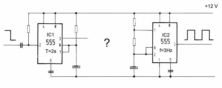

Do you have schematics for LED strobe: 2 seconds continuous light and than blinking with f=3 Hz?
I tried with two 555's but without success. How monostable 555 can trigger bistable one?

Are the LED On/Off times in this drawing what you require?
How can I start IC2 with falling edge on pin 3 IC1?

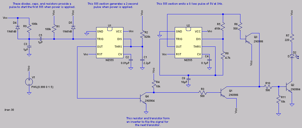

Hi again,
Turns out my idea had just about every potential problem I had thought of and some I hadn't. I also couldn't get Ron's idea to work (at least, not in LTSpice), but I did manage to get one idea working. See the attached image. The other attachment is the LTSpice file if you want to simulate it.
Note that this idea works (or is meant to; I haven't tried it in the real world) on power-up only; that is, when power is applied, you get the LED on for 2 seconds, after which the LED should flash for 0.1 second every 3 seconds until you remove power. It should work with a low-going trigger if you remove D4, R9, and C3 and just put the trigger into the left side of C5.
Anybody have any thoughts? Too complicated? Seems like there must be a simpler way to do this.
Anyway, that's my idea. Hope it helps!

Hi Torben,
You have the collector and emitter reversed for the PNP transistors Q1 and Q3. The emitters should be connected to the positive supply.
Since Q2 doesn't have a current-limiting resistor in series with its base then it will blow up. Q2 also needs a resistor from its base to ground to turn it off.
The diodes don't do anything.

audioguru said:
Hi Torben,
Excellent. Not the screwups, but the pointers. Thanks!
Torben

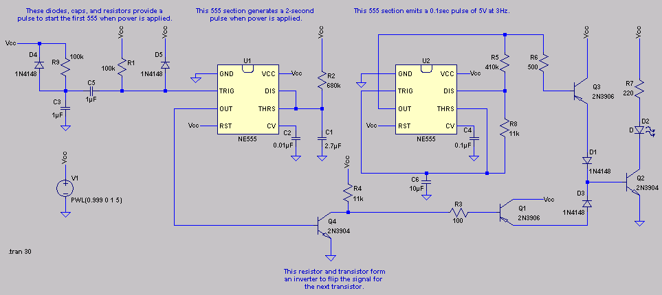

OK, family is in bed and I sat down (with a book and a calculator this time) and worked in audioguru's fixes. I also changed some resistor and capacitor values to be standard values. This circuit should be more reliable.
And as Lefty noted, you could do this with fewer parts and more configurability and precision with a microcontroller, if you have access to a programmer.
Torben

Hi Torben,
Now your circuit looks good.
I have never seen a 500 ohm "standard" resistor. 470 ohms and 510 ohms are standard.

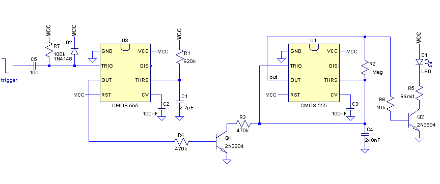

I gotta defend myself. Better late than never. I was out seeking gold with my metal detector yesterday (found 2 little dinks).
Anyhow, my design works, unless I misunderstood the requirements. Here's the .ASC file for LTSpice.
