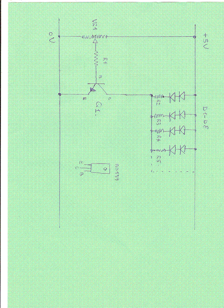

schema
Attached is a simple schema with ¼ or ½ Watt potentiometer driving via a resistor through the base of a BD139 transistor.
This can control a bank of parrallel strings of leds with their own current limiting resistror.
If you want to control the colours independantly make this circuit up 4 times.
VR1 is 2k5
R1 is 470 ohms
Q1 is BD139 (NPN)
D1-D8 LED's
R2-R5 series resistor ( values as per earlier post )

So I need A resistor for the voltage then one for the current? I am confused.
No, you only need one to limit the current. The LED provides the voltage drop.
An LED is a semiconductor so does not behave like a typical resistive load. It will draw as much current as it can if it has enough forward voltage applied, and if that current is large enough, it will happily draw enough current to kill itself. You use the resistor to limit the amount of current it can draw.

Move some (or all*) of the Ohmage of R2, R3 etc to below the transistor emitter. Improves light power stability as transistor warms up. (How much heatsink is required?)
* connect the LEDs in parallel, with a small ohmage in series each LED chain if required to 'balance' LED voltage drops

Will these values change if I add more LEDs, or use a different voltage LED?
resistors
The R2, R3, R4 values only change when the colour of the LED's changes.
For 5 Volts dc
2 red leds in series (2 x 1.7 = 3.4 Volts). 1.6 Volts to get rid off. at 20 mA U=IxR ... R = 80 Ohms, use 100 Ohms 1/4 watt.
2 orange leds in series (2 x 2.2=4.4 Volts). R=30 ohms, use 47 ohms.
The UV blue and white leds are have usually a 3.0 - 3.6 Volts drop.
design it for 3 Volts so 2 volts to get rid off. then a 100 ohm resistor is needed here. use 120 ohms to keep current below 20 mA.
You don't know the exact voltage of your LEDs. It is a range of minimum to maximum voltages.
You must have about 2V extra for the resistor to allow for the variation in voltages your LEDs might have.
If you don't want to waste 2V in the resistor then you could measure and sort your LEDs then calculate a suitable resistor for each one or for each series string.

But in this case it will be fine to run 2 LEDs and not have to check them all?
Simply calculate the "worst case current" of LEDs with minimum voltages then calculate with maximum voltages.
If the resistor does not have enough extra voltage and both LEDs are minimum voltage then they might burn out.
If both LEDs have max voltage then they might be too dim.
