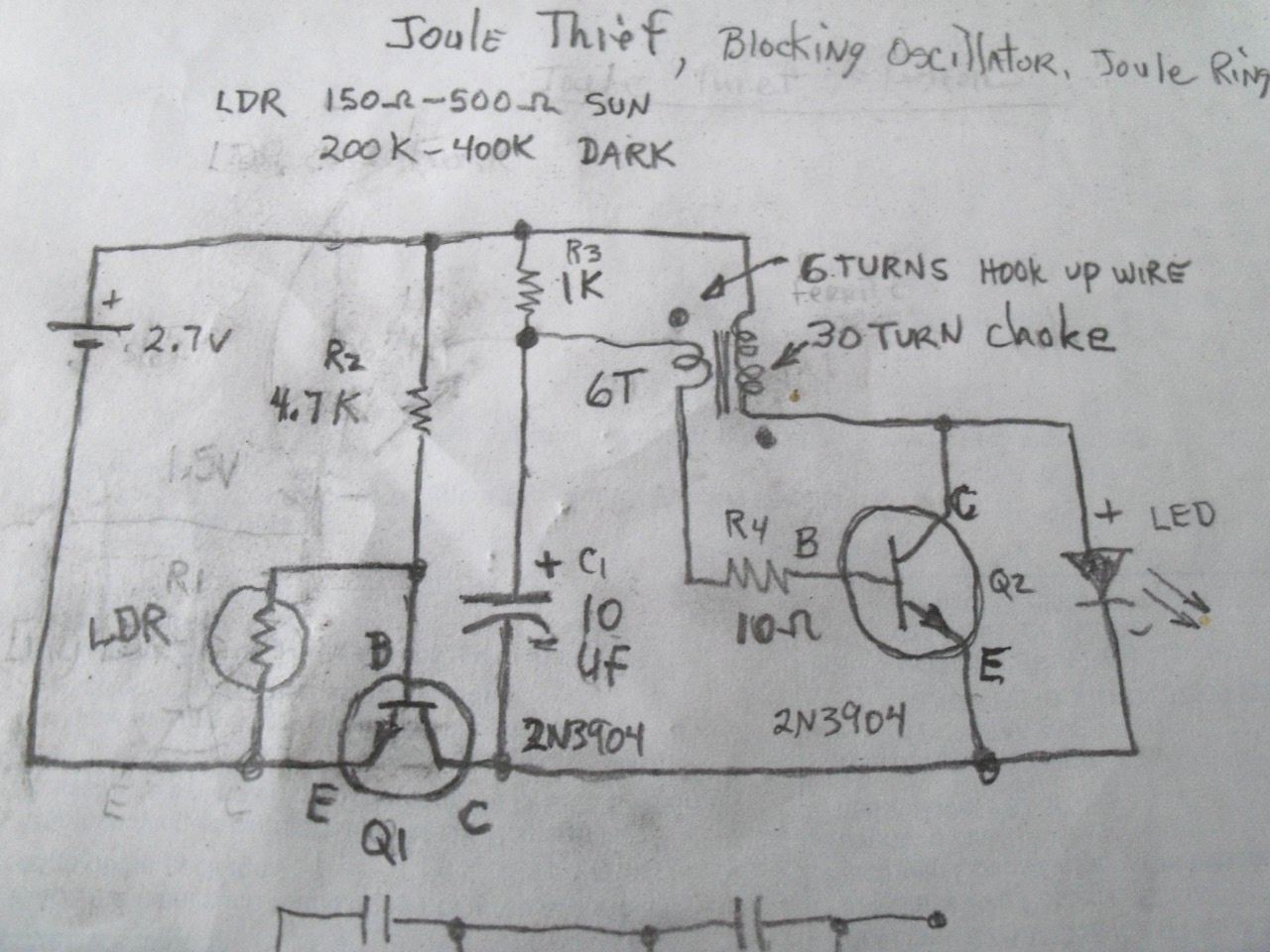

Gary, in your Joule Thief circuit with the added LDR transistor, R2 turns on the transistor and R1 turns it off.
If the battery is 2.7V, R1 is a high value and R2 is very low at 5k ohms then the base current in Q1 is (2.7V - 0.7V)/5k= 0.4mA. Then the datasheet of the transistor says it will saturate very well with an output current as high as 4mA which is much more current that a Joule Thief needs.
Maybe your transistor has its base destroyed if the 100k pot resistance was turned too low or maybe the transistor emitter and collector are wrongly swapped.
The only way I can get a 5K resistor is five 1K in series so I used 4.7K. I tested the once used transistors with a meter they test good. I swapped transistors in bread board circuit to double check they are good. Transistors are all good. I built this circuit Q1 still will not work. I tested voltage to the Joule Thief it = 0. I put a jumper wire across Q1 E to C joule thief comes on.

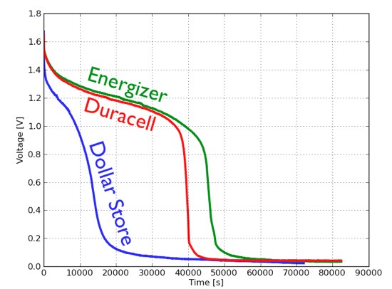

Gary; Normal batteries start at 1.5V when new but decrease in voltage steadily as they are used, ending up at around 1V before being completely flat and the voltage suddenly dropping rapidly.
At 2.7V for two, 1.35V each, they still have over a third of their capacity available; possibly half or even more.
See discharge curve plots below:
If the power switching transistor does not turn on with a base resistor of 4.7k to 22k then maybe the LDR is not dark enough.
Remove the LDR and replace it with a 200k resistor to see.
What is the Base-Emitter voltage on Q1 under the different operating conditions? Is it enough to turn the transistor on when it should? And is there enough base current to saturate Q1?
Remember that all the current through R2 will flow through the LDR when the Base voltage is below Q1s turn on threshold. After that the R2 current will split between the LDR and the transistor.

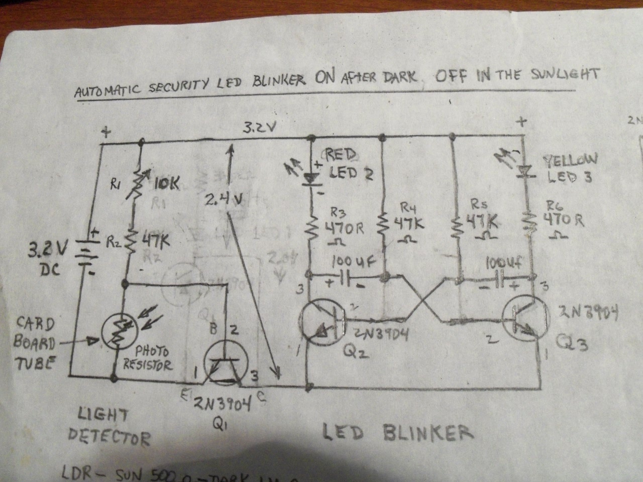

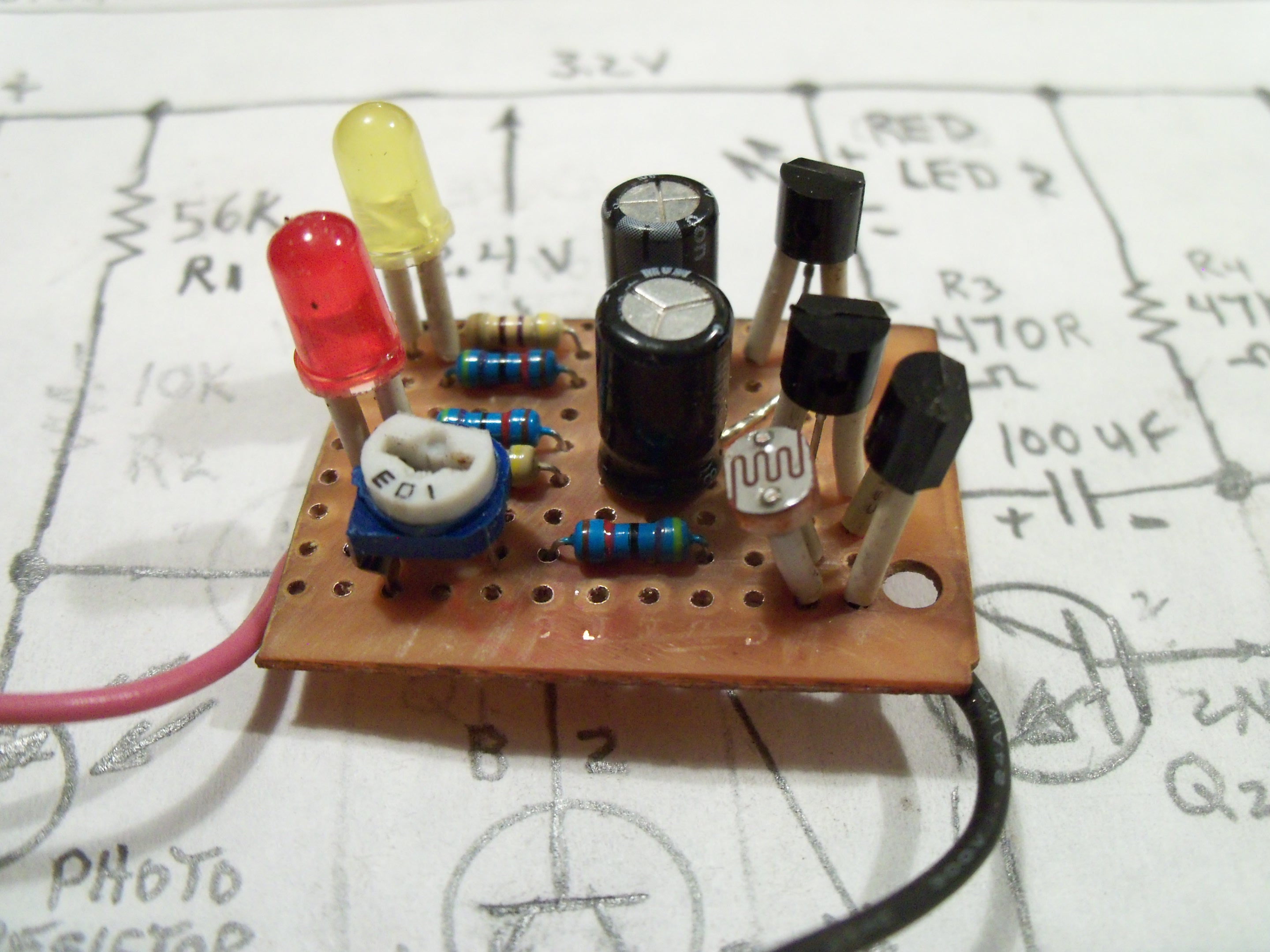

I made a new 2 LED circuit & made an interesting discovery. The new circuit works good on 2.7v. The rusted wire circuit would not work on 2.7v. Maybe rust gets deep into the wire and changes the wire resistances. Also rust from rusty wires gets on the PC board that could be making a short circuit for all the parts. Maybe if I spray new parts & board with Clear Coat it might prevent rust. I wrote 2.7v on the used batteries with 12/7/2020 date. Now I wait to see how long 2.7v batteries last and what the voltage is when they die. I made a change to the circuit, 56K resistor has been changed to 47K fixed resistor plus 10K variable resistor. At the moment total resistance is 57K circuit is working good. The original circuit had a lower resistance I change it to 56K because if a bark cloud passed in front of the sun the LEDs would flash & a cloudy over cast sky LEDs flash all day. The original circuit could have been 47K but I don't remember. 56K keeps the circuit off until about 15 minutes before total darkness. Sun has already gone down today so I will test it outside tomorrow 30 min before dark.
For the moment I have given up on the Joule Thief 1 LED 1 battery flasher the LDR will not work.
