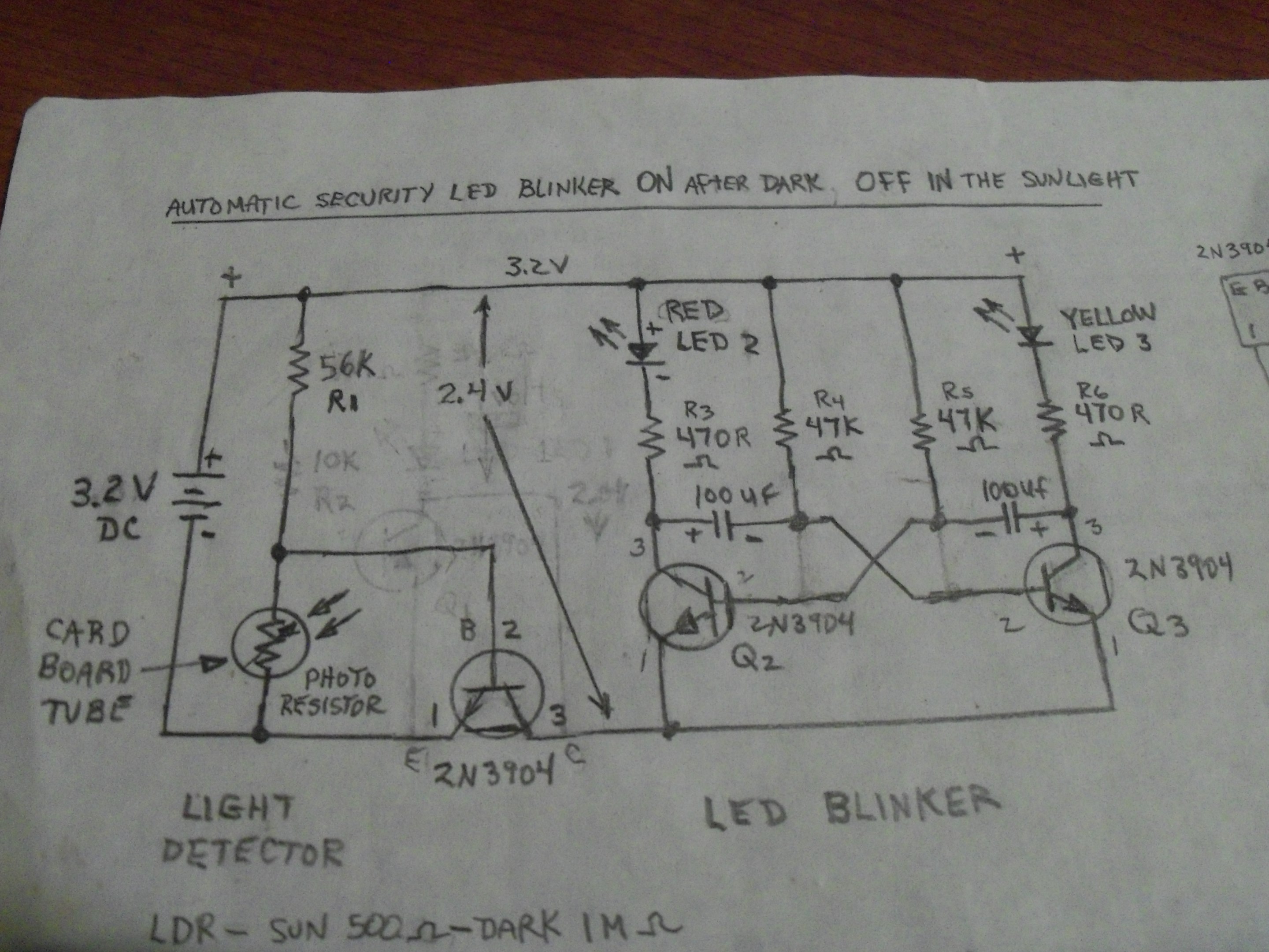

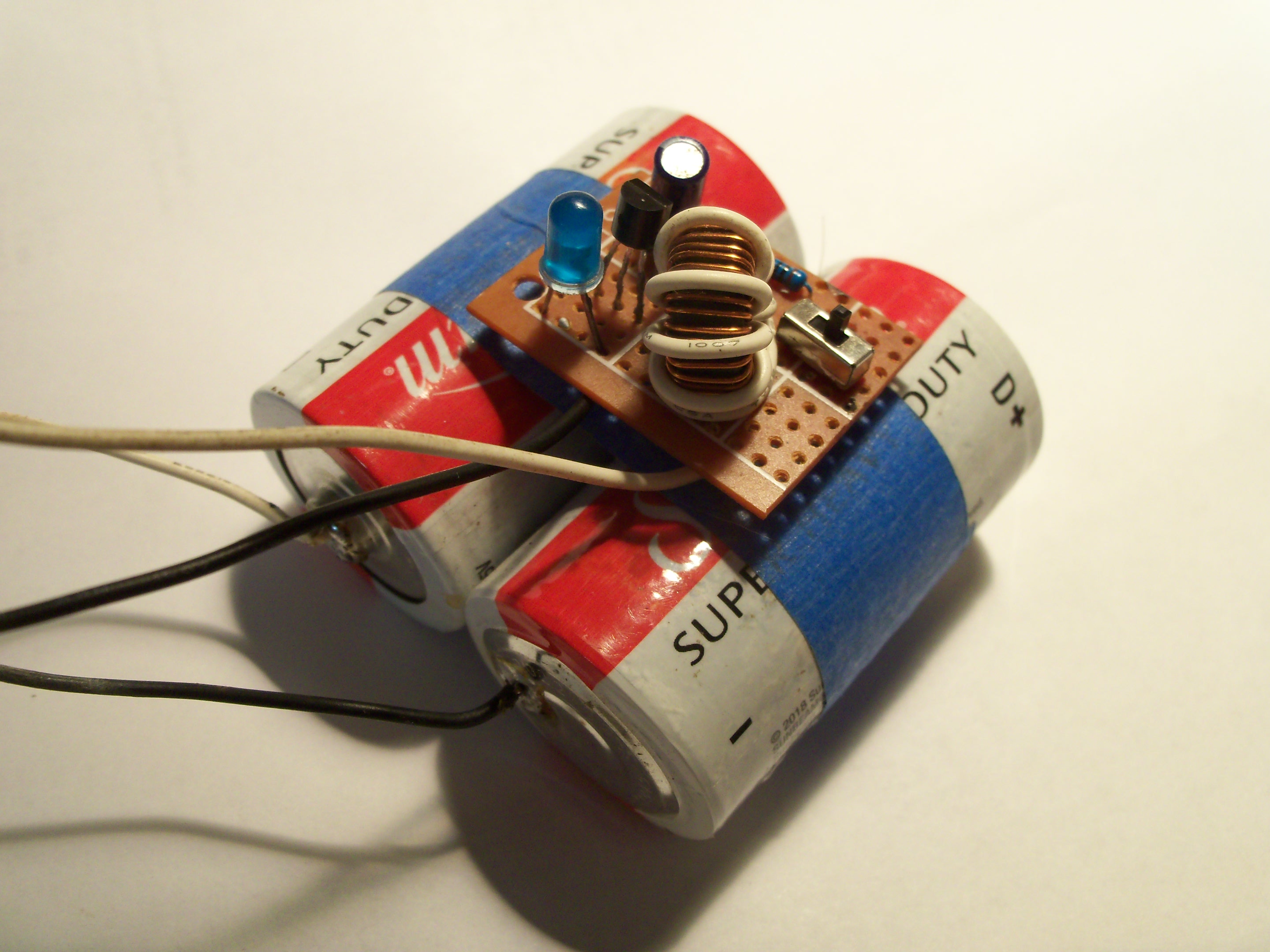

I started making a new circuit today with, new parts, new 60/40 solder, new batteries, new PC board, then I got side tracked.

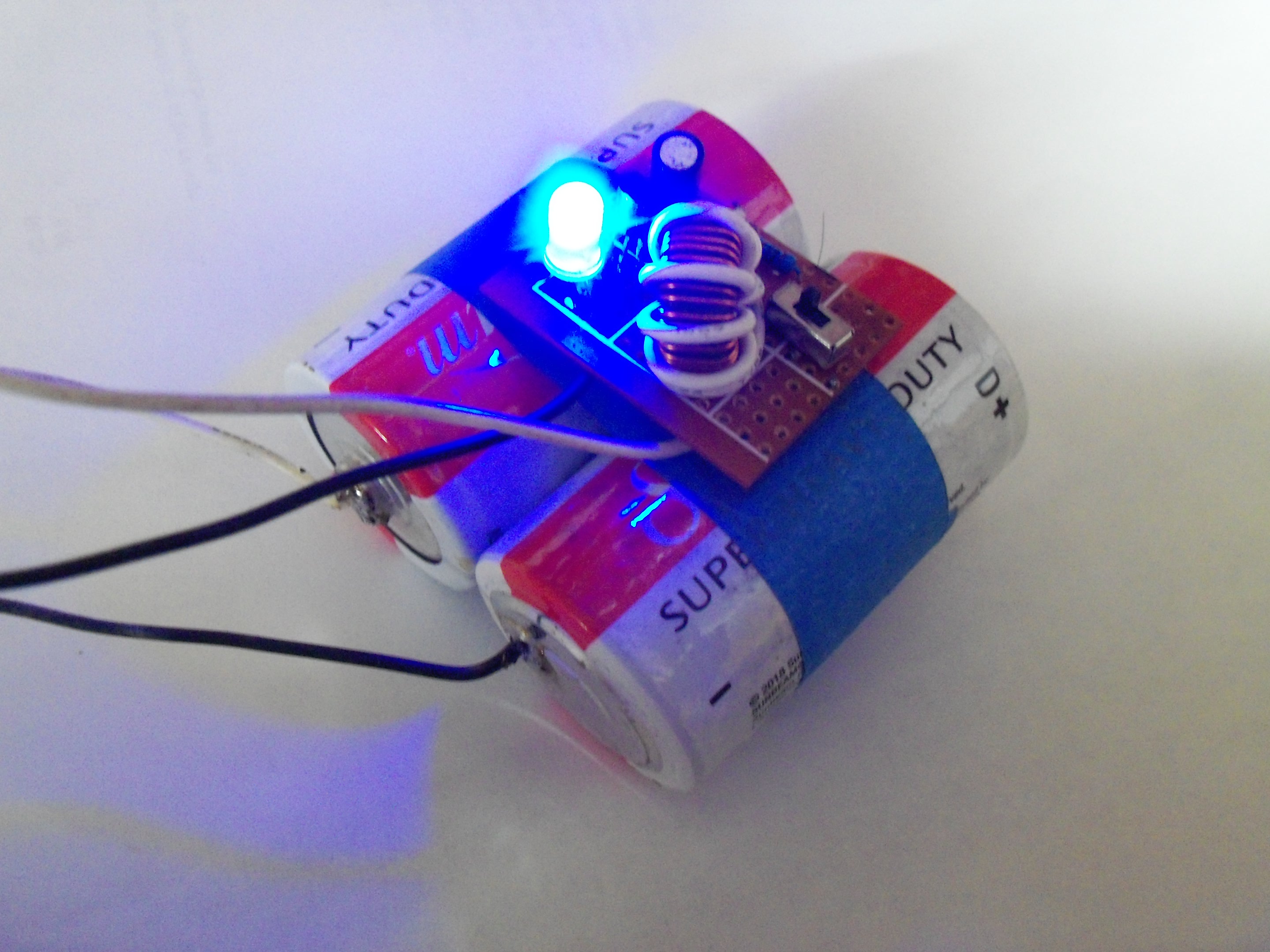

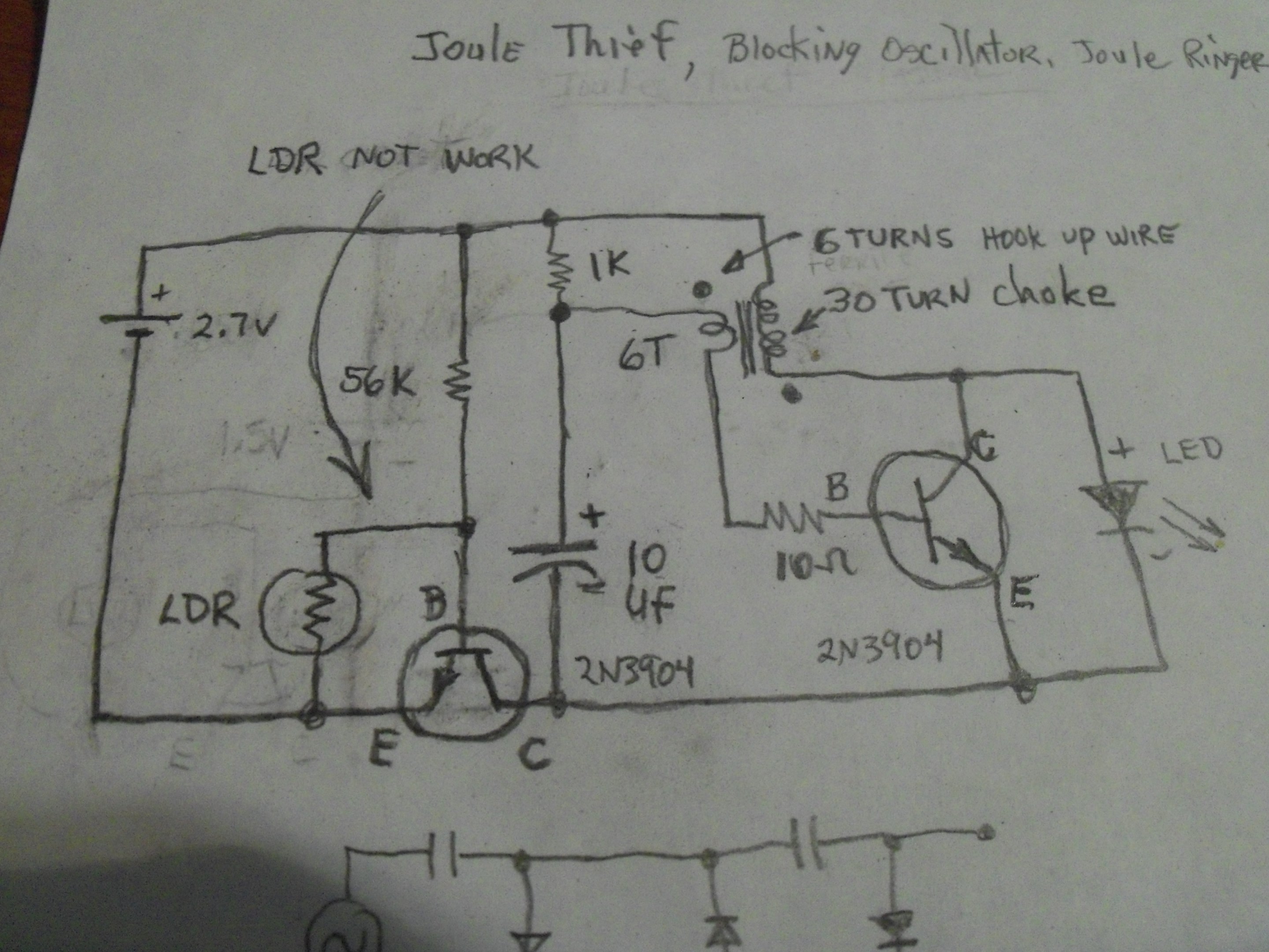

2 old batteries in series are 2.7v I connected them to the joule thief circuit the LED lights up good. Joule thief works good on 1 new battery or 2 old low batteries. Joule thief circuit allows me to use all the old batteries & not buy new batteries for a while. Problem is joule thief needs an LDR so I added it to the circuit and it does not work with 2.7v. I changed the 56K resistor to 30K it still does now work.
I wonder how much power is left in 1 year old batteries that voltage has dropped from 3.2v to 2.7v. Joule thief so on and working good outside at the moment it will be interesting to see how long old batteries last. Tomorrow morning I will turn the switch off. Dark I will turn switch on again. It would be nice if LDR worked. WOW this Blue LED sure is bright it appears to be several times brighter than Red LED.

I suggest throwing a 100k VR in there instead of the fixed 56k resistor and adjust to find the threshold.

I fixed the typo thanks for pointing that out. LDR works good on this circuit so I added it to the other circuit but forgot voltage is not 3.2v like the other circuit.

The 56k value for the base resistor of the power-switching transistor on the LED Blinker circuit is too high. If the batteries are brand new alkaline then the 3.2V supply minus the 0.7V base-emitter voltage drop produces a base current of only (3.2V - 0.7V)/56k= 45uA. The datasheet for the 2N3904 and nearly every other little transistor says that for it to saturate as a switch then its collector current shall be 10 times the base current. Then it will conduct well for a collector current of only 0.45mA which would cause the LEDs to be very dim.
The circuit has 470 ohms in series with each LED. Then the switched voltage is 3V which is turned on with the multivibrator driving a 2V red LED drawing a current of (3V - 0.2V - 2V)/470 ohms= 1.7mA (very dim LEDs). So the base current should be 1.7mA/10= 0.17mA and the base resistor value should be (3.2V- 0.7V)/0.17mA= 14.7k. Since the resistor value of 56k is too high then the switched voltage of only 2.4V shows the the transistor is not saturated.
Since the currents are very low, I think the resistor values were designed for the circuit to be powered from 9V to 12V.

This circuit works good. When batteries get low about 2.8v to 2.7v it stops working. So maybe I need to test circuit with a lower value R1 resistor with 2.7v batteries. Maybe I can increase battery life a little bit more by lowering R1. I will test this in about an hour.
I increased the original value of R3 & R6 to increase battery life from 9 months to 12 months. After dark I walked 180 ft to the street to look at LEDs they were very bright with the original R3 & R6 values. I reduced LED brightness so they could still be seen easy this increases battery life. R3 & R6 are perfect now. I think the original value of R3 & R6 was 330 ohms.

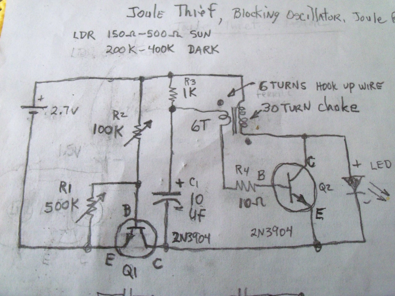

I tested several LDRs they are not all the same. In Light they test 150 to 500 ohms. In Dark they test 200K to 400K.

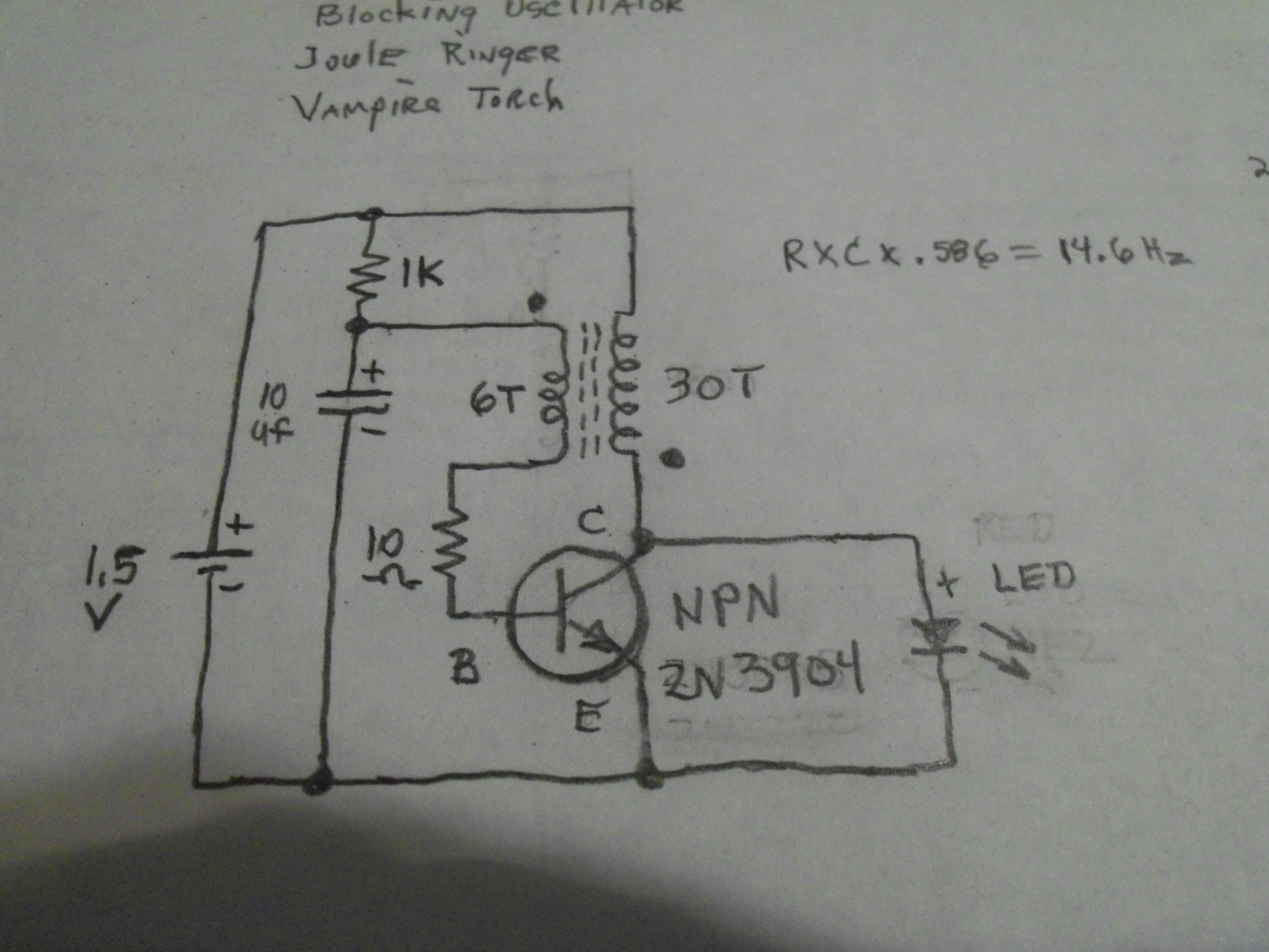

Now I am talking about the Joule Thief circuit with only 1 LED. This circuit works perfect with 1 new 1.5v battery. If I use 2 low battery from the (other 2 LED circuit) on this 1 LED circuit the Joule Thief circuit work perfect on 2.7v batteries. 2 low batteries 1.5v Joule Thief works perfect.
The Joule Thief circuit will not work with the LDR circuit. I tested the Joule Thief with 2.7v it works good but when I add the LDR, resistor, transistor, it stops working. I replaced R1 & R2 with variable resistors I can not make Q1 on the circuit work. I tested several 2n3904 & several 2n2222 transistors none of them work. I tested the transistors with meter they test good. With R1 at 500K no value of R2 will turn on Q1. Lower R1 value no value of R2 will turn on Q1. Remove, Q1, R1, R2, then the circuit works perfect on 2.7v or 1.5v.
