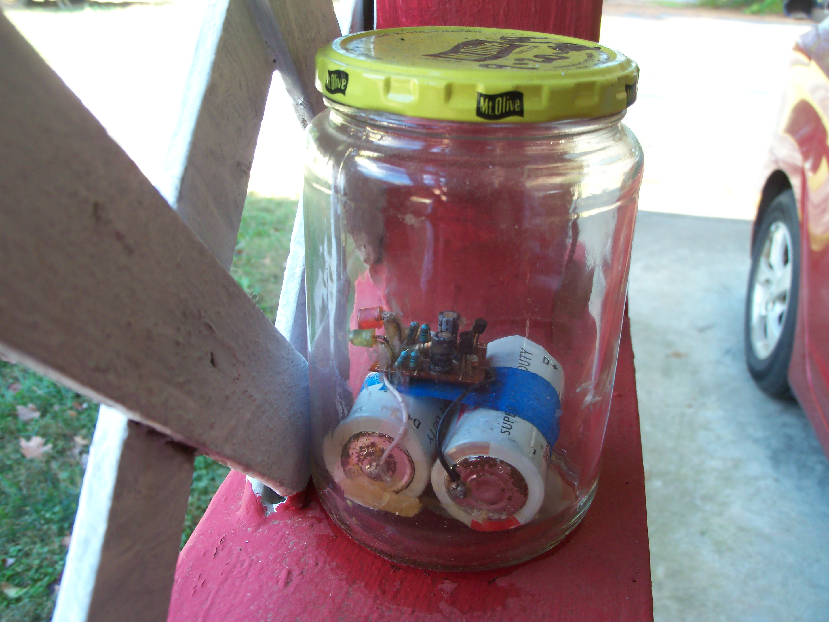

LED Leads & Transistor Leads are rusting away.???
gary350

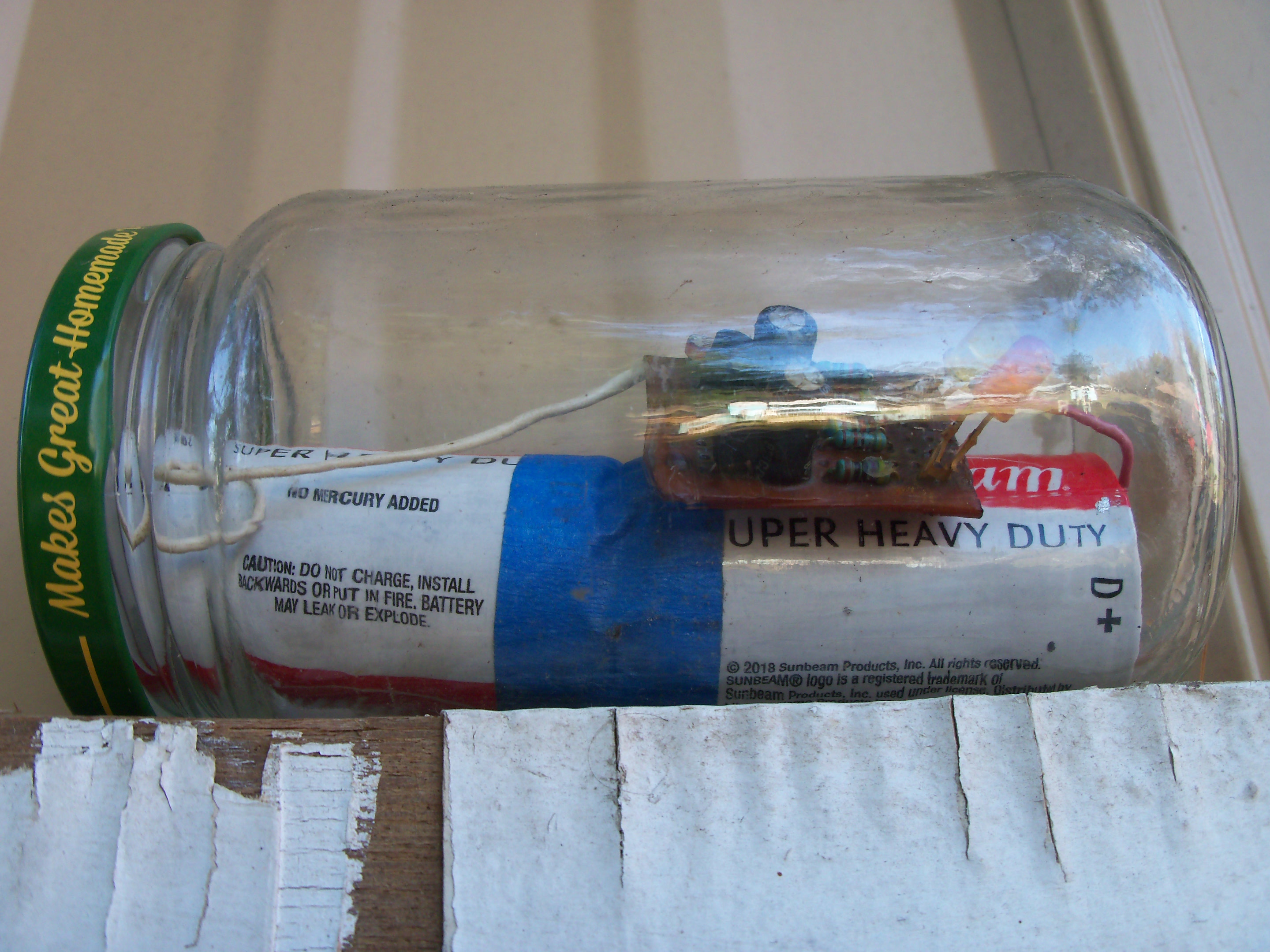

Every year I have to make 20 new circuit boards because the old ones are worthless. 2D batteries last about 1 year and LED wires rust completely through about the same time batteries die. Transistor wire rust completely though too. There never seems to be much rust on capacitors that is strange? Zip lock plastic bags were terrible now I use glass jars with air tight lids but still rust away. I tried open jars in AC in low humidity put new PC board with new parts & new batteries in the jars the screw lids on tight they still have water condense inside jars and parts all rust. I have tried incasing circuit boards in candle wax but wires still rust away.
Something interesting I noticed, circuit boards laying around on the work bench and shelves in the open air never rust but parts in jars do? That seems crazy to me.

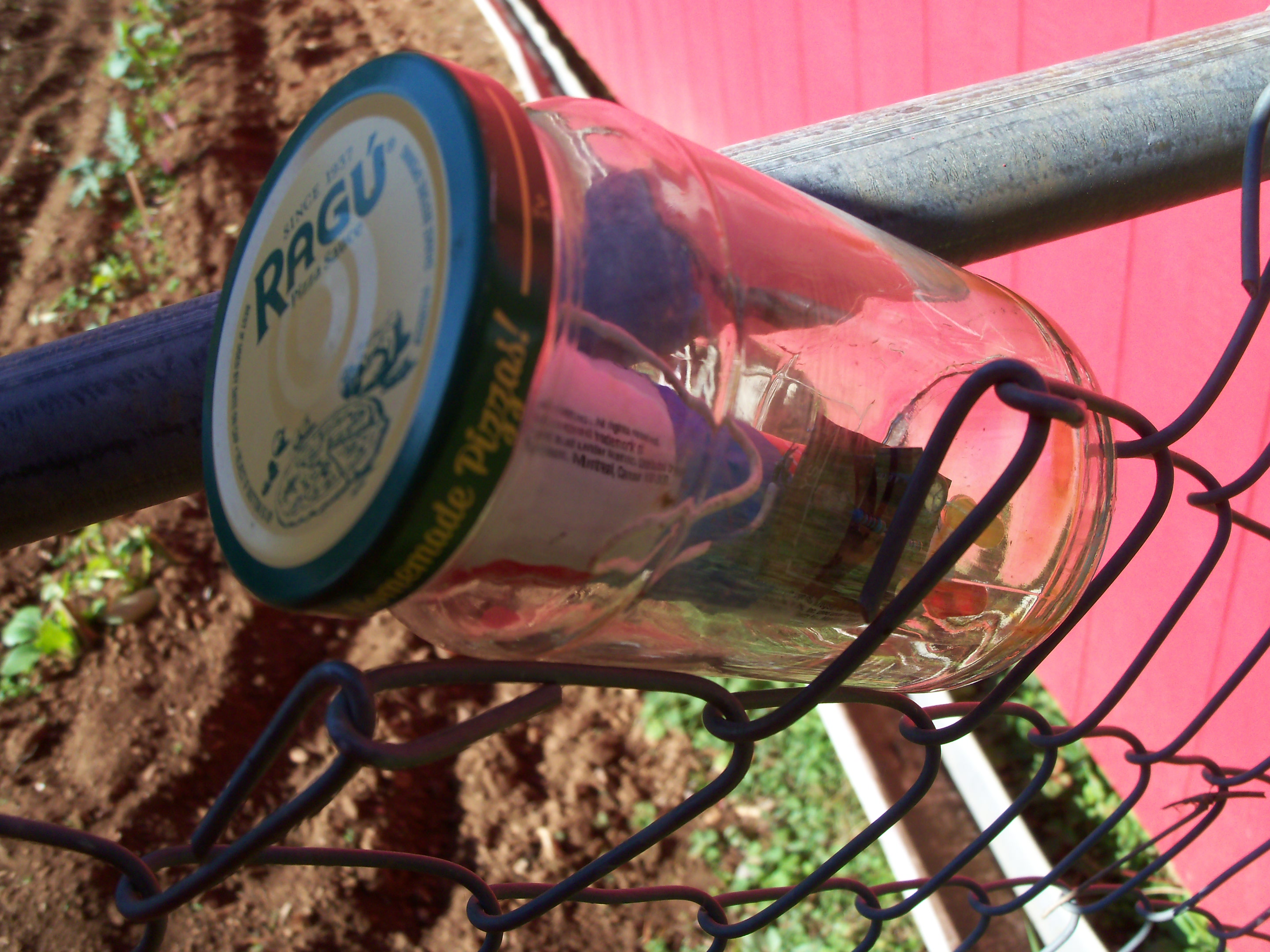

LED flasher security lights are all outside in the weather 6 months of rain all winter & spring. You can see water condensed inside some of these jars. I was thinking about putting jars, batteries, PC board, lid in the freezer then open freezer and screwing on the lids quick, not sure if that will work or not?
Jars are working much better than zip lock plastic bags wires on PC boards have no rust but LED wire & Transistor wires rust completely away & those parts fall completely off of the PC boards.
Any ideas?

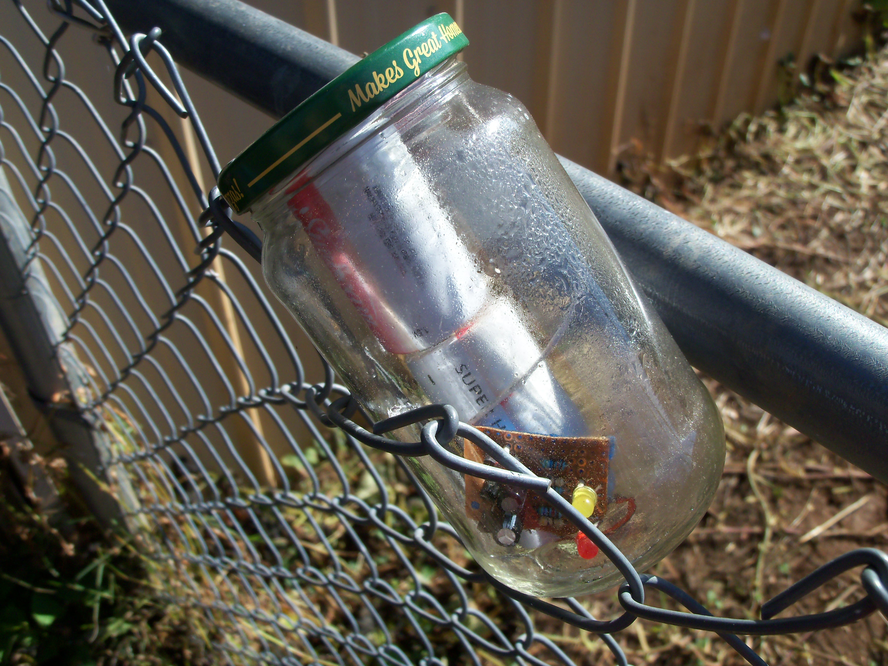

In one of your pictures the jar is obviously full of condensation, so it's got water inside it - hence the components rust, you can even see rust on the batteries.
Even assuming the jar is actually air tight?, there's moisture in the air inside the jar when you seal it. You might try some silica gel packs inside, see if that helps?.
You're also using really crap batteries - use alkaline ones instead, which will last much longer and be better value.

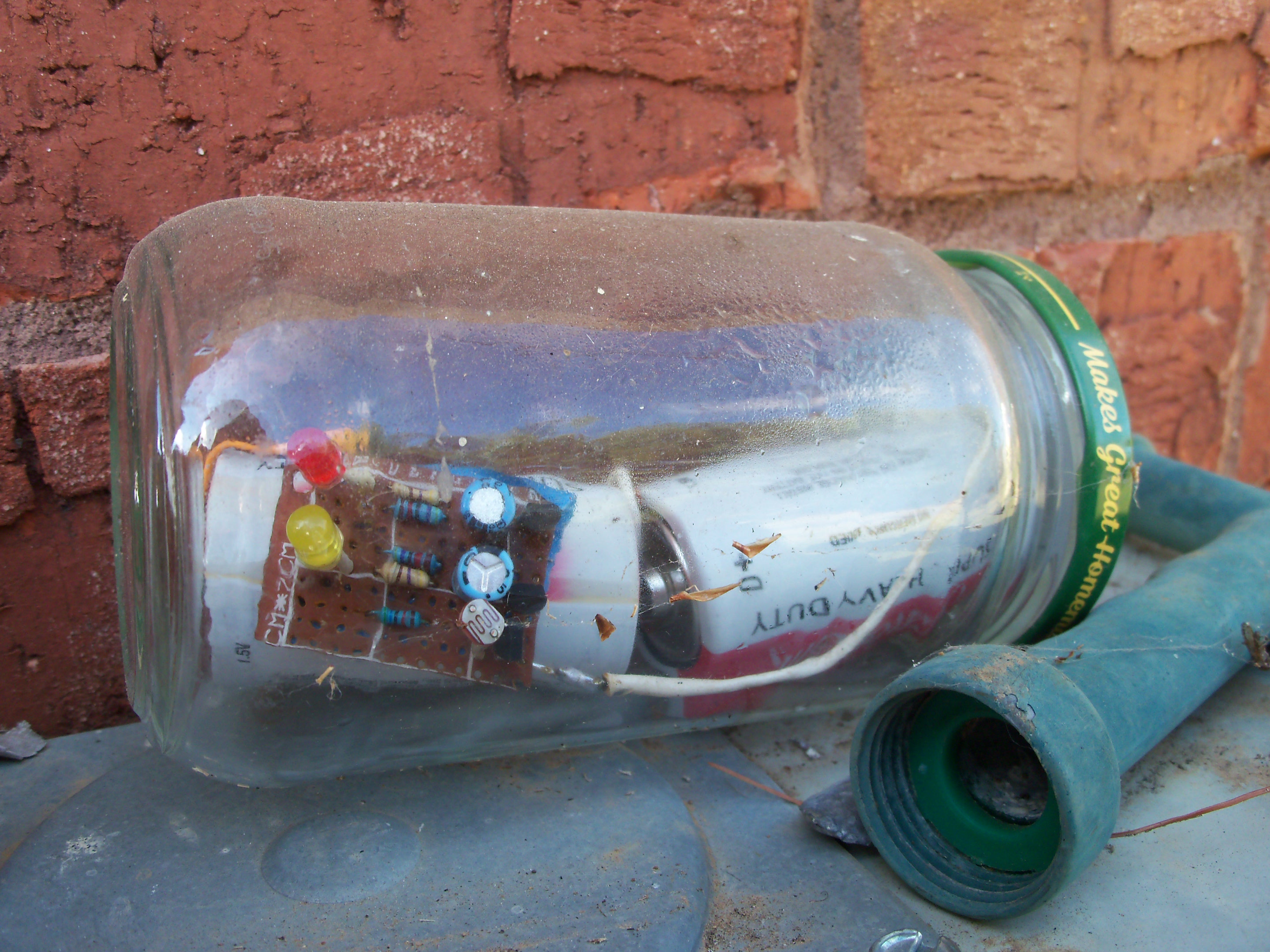

Silica gel packs inside the jars would be good if I had some. We live in TN average it rains 250 days every year, humidity is 100% most of the time. It is strange LED wires rust, Transistor wires rust, other wires no rust. YES I am using crap batteries they last 1 year and are 33 cents each. I can't see paying $2 each for better batteries they will need to last longer than 6 years to make them worth the extra cost.
My thought would be that the batteries themselves are releasing some vapour that causes the corrosion?

Why strange?, steel wires rust - the wires are steel. Try a magnet on a resistor!, or on the wire from a resistor.
If the cheap crap ones last 1 year, then the alkaline ones will probably last 6 years!.
go to a gun store (yes, really) and ask if they could sell you some silica gel packs. the silica gel packs that ship with rifles are usually pretty big ones.... they may also just have some for sale for people to use in gun safes, especially in such a humid climate. if the silica gel gets saturated, you put them in the oven at 125F for about a half hour or so to drive the moisture out, and you can re-use them.
I checked wires with a magnet they are all steel except the ceramic capacitors that I am not using on this project. I wonder if some wires have a coating and LED & Transistors don't?

If you seal a jar in a high humidity environment and the jar temperature drops below the dew point you are going to get condensate. Seal the jar in a dry air environment and place a small desiccant packet in the jar. Next you may want to try spraying the boards with a light coat of polyurethane as mentioned above.

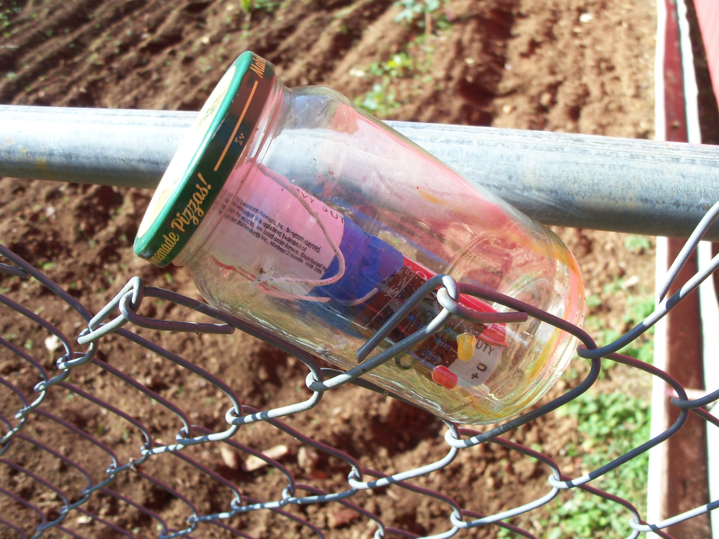

I have been keeping jars with the PC board & batteries in the house in AC overnight then put lids on next morning. AC air is the best I can do for low humidity. Sometimes it works better than others. I notice a jar outside in full sun heats up like a green house moisture is always inside the jars I wonder if something is being cooked out of the batteries.

Actually, silica packs are not an infinite sink for humidity. To reuse them properly, you have to dry them out. If they are used in a critical application, you have to dry them out per a specific procedure and follow-up testing. Had to deal with this for a MIL project. There is a thing that looks like a MIL 38999 circular connector that is a bi-directional air vent (bleeder valve) with a silica pack built-in. When air pressure equalizes as an unpressurized aircraft ascends and descends, the air that is intaken during descent is dried.
The driest ambient air available to the general public is inside a walk-in refrigerator or freezer at a restaurant. Buddy-up with a local McDonald's manager, take your jars and some new, sealed silica packs inside the walk-in, wait a minute, assemble and seal everything. Outside, when the jars warm up the internal pressure will be greater than the outside ambient. Crack the lids just enough to let the pressure equalize, and re-tighten.

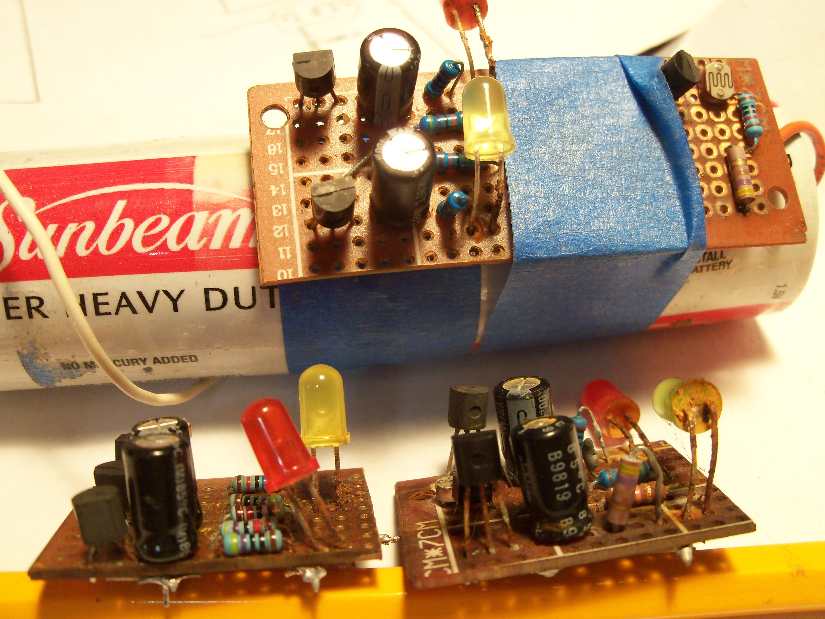

Careful about what flux you use while soldering them to the perfboard. Some fluxes, if not cleaned well, will continue to eat away at certain metals. Try no-clean flux or, even better, thoroughly clean the board after soldering to remove all flux residue.
Your circuit has only 2 LEDs and an LDR to turn it off in daylight. Then why are you using HUGE D cell batteries to power it?
Your circuit appears to be a simple 2-transistors multivibrator that does not blink the LEDs, instead it alternates the LEDs so that one LED is always turned on all night draining the battery.
