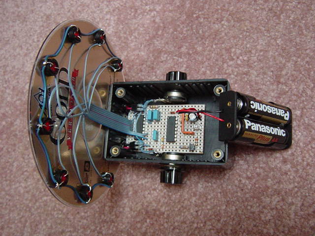

LED Leads & Transistor Leads are rusting away.???

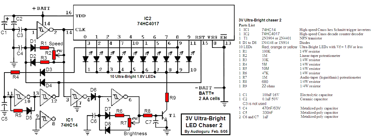

Here is my 3V chaser circuit that blinks around and around all the time:

Careful about what flux you use while soldering them to the perfboard. Some fluxes, if not cleaned well, will continue to eat away at certain metals. Try no-clean flux or, even better, thoroughly clean the board after soldering to remove all flux residue.
Plumber's solder generally has acid flux and CAN NOT be used for electronics. It will eat through the leads like there's no tomorrow. You NEED to use proper electronics flux, otherwise your leads will just keep rusting.

I do not have a simple circuit that flashes 1 or 2 LEDs. The circuit I posted blinks 10 LEDs one-at-a-time around and around in a chase circle a few times, then it pauses for a couple of seconds before chasing again. Part of the circuit blinks each LED for only 30 milli-seconds which is a short duration to save the battery power but is long enough for our vision to see its full brightness. Another part of the circuit times the chasing and pauses it, again saving battery power. Its two AA alkaline cells last for 3 months and it operates continuously day and night.

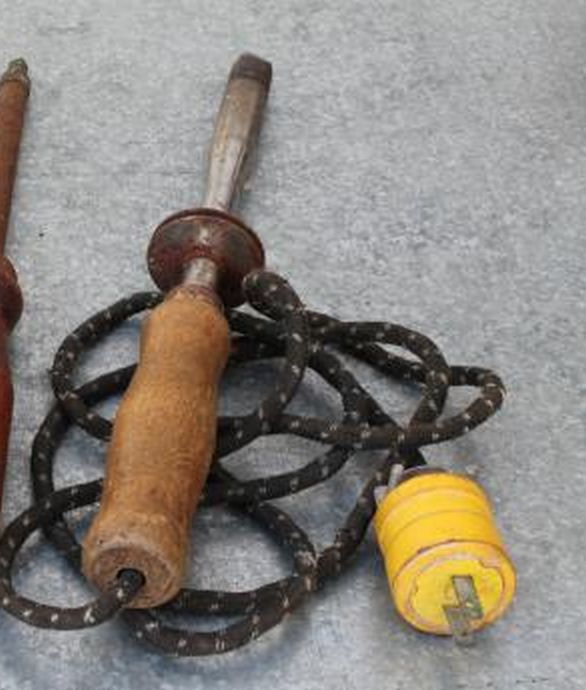

Unless you're using one of these irons,

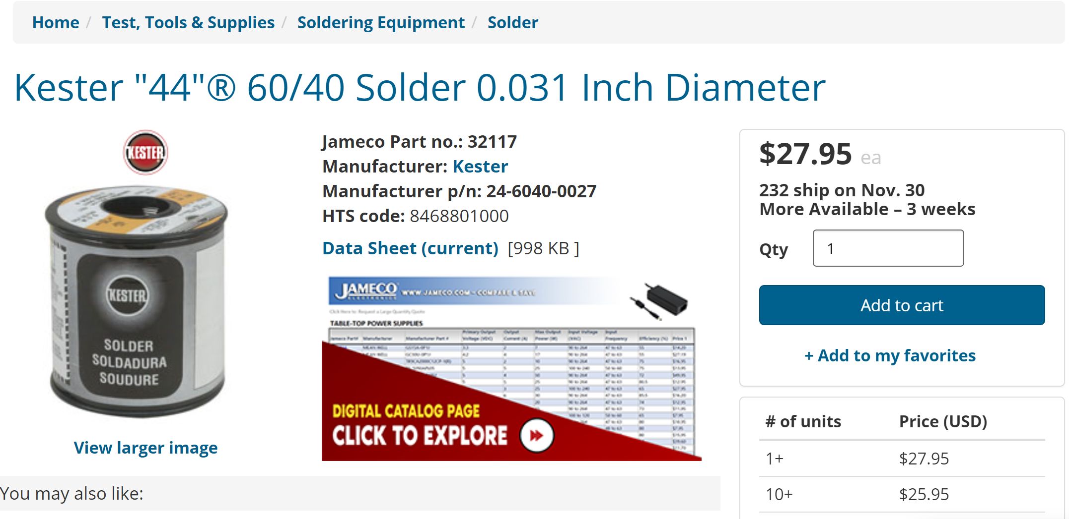

throw away the plumbing solder and get some quality solder. You can find cheaper solder than Kester, but Kester is a known and proven good solder that won't let you down. This picture is from Jameco Electronics but any electronics distributer will have it. NOT Lowe's, NOT Walmart. NOT ebay.
Get the real thing and save everybody a lot of grief.

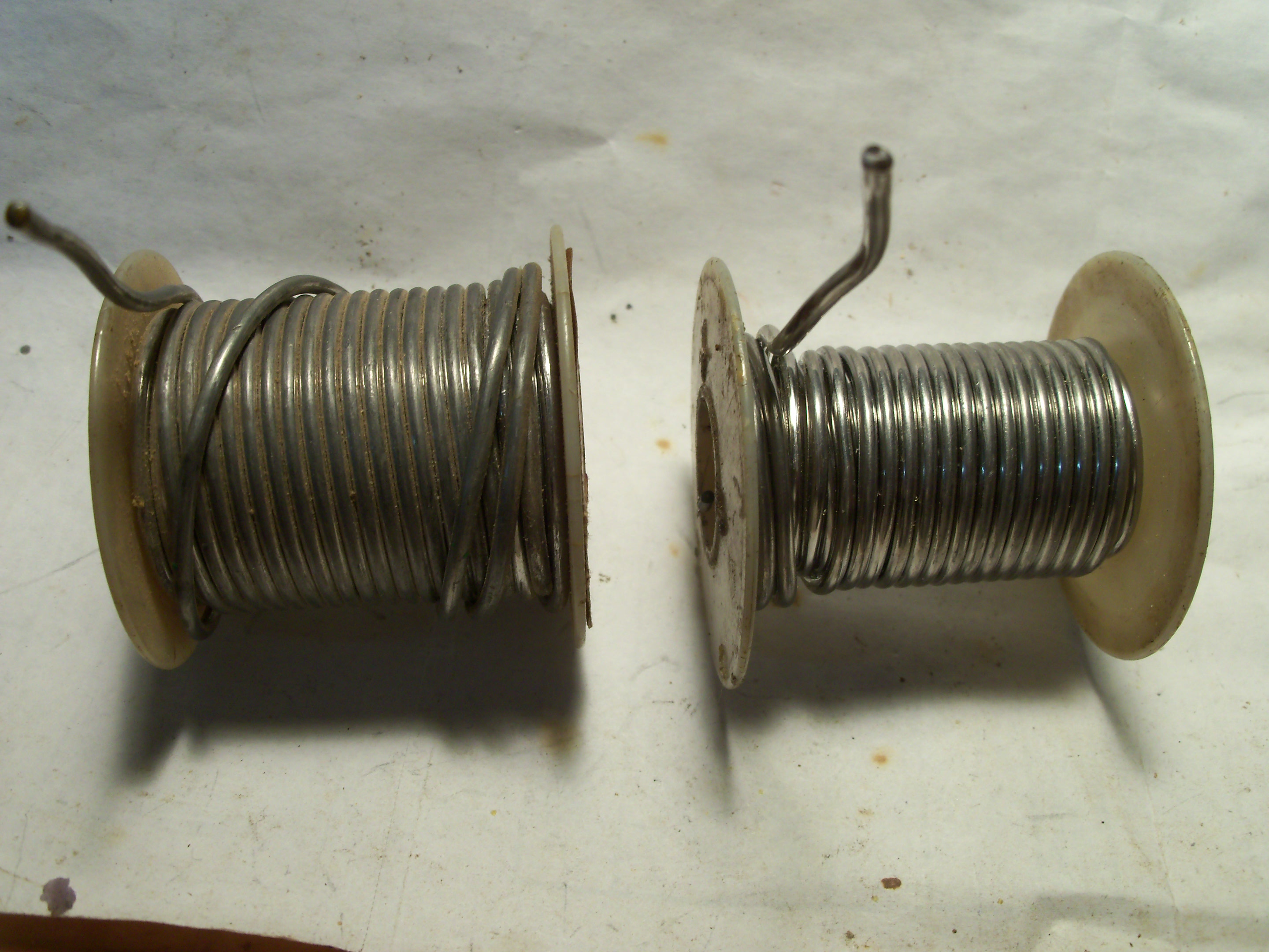

If my google-foo is working correctly the reel of solder shown by Visitor contains 1lb of solder, and since the diameter of the solder wire is 0.031" there will be a very long length of it.
How much solder do you need to make a joint?
On the other hand, the two reels of solder which you show probably have the same mass of solder but a much shorter length of wire because of the much larger diameter.
It seem to be the type of thing used by followers of the philosophy "The bigger the blob, the better the job!"

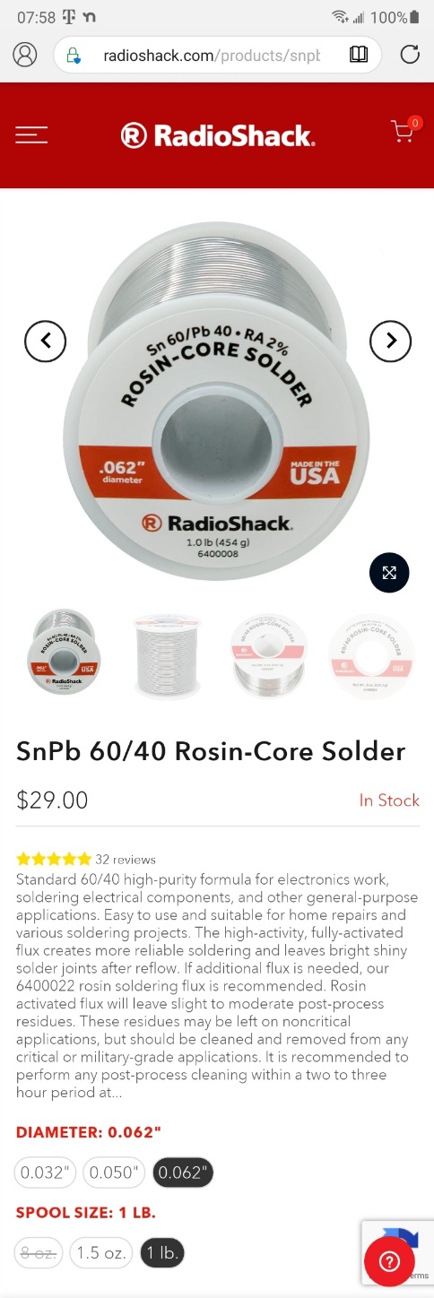

Actually, Radio Shack is trying hard not to be dead. Don't know how long they may survive as a mostly online store. A 1 pound spool of Radio Shack solder costs more than the Kester 44 I posted at Jameco.
I didn't mean to imply The Shack is long gone, I just meant our OP's understanding of inflation seems to be non-existent. Your post of a $29 pound of solder (at Radio Shack) proved my point.
