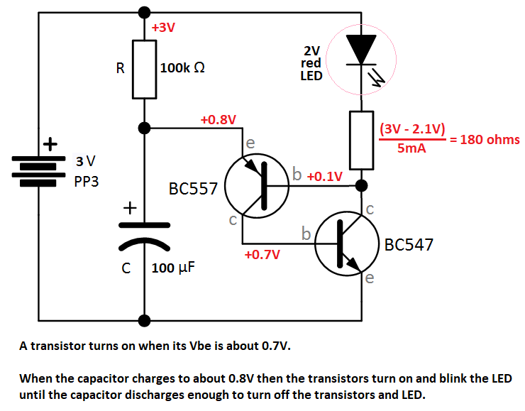

You can test the transistors in the circuit. When a transistor is turned on by its 47k resistor on its base to +3V then the capacitor turns it off.
make the test by simply shorting the base to 0V and it should turn off.

You said you tried connecting LEDs in parallel. They both will light only if they both have exactly the same forward voltage but the forward voltage varies between LEDs even if they have the same color.
You show the schematic that is missing the very important current-limiting resistor. Then the LED and/or BC547 might burn out and the flash duration will be so short that the LED appears to be dimmed, as you found.

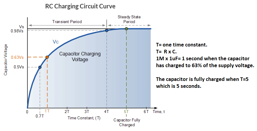

I don't know how to design the circuit, I only know how to build it. I can experiment with parts to make circuit better or worse. I understand the capacitor charges through the resistor. Larger resistor makes capacitor charge slower. Larger capacitor charges slower than small capacitor. Larger capacitor holds more charge than small capacitor. I have no clue how 2 transistors make the LED flash. I can see when 3v is turned ON circuit does not flash for 3 seconds until capacitor charges through the resistor. Capacitor discharges through LED then the cycle starts over. I have forgotten the formula to calculate how long it takes for resistor to charge capacitor, I can not find it online probably because I don't know the correct search words to find it. I wish I understood transistors better when I was in college we learned tubes, every thing was tubes then.
I looked in Google for Capacitor Charging and found this graph that shows that R x C= one time constant which is a 63% charging voltage.
The capacitor must charge to about 0.8V for the transistors to turn on then discharge a little for the transistors to turn off.
The capacitor does not discharge through the LED, instead it discharges through the transistors.

I built this circuit, with 3v it blinked every 10 seconds. I was surprised to learn with 4.5v it blinks every 15 seconds. LED is very bright. It needs to blink faster about 3 seconds. I have no 180 ohm resistor so I used two 100 ohm in series.
