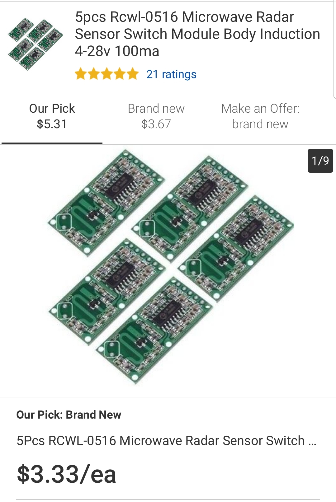

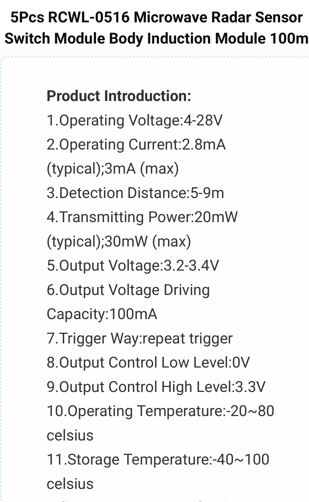

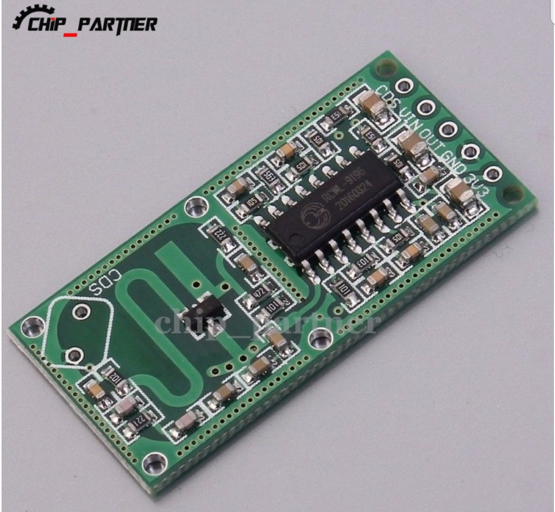

These cheap microwave radar sensor modules could be used to switch on an LED when a person is detected. These modules have a wide, non-directional detection range, and are designed to stay on for a minute or two when motion is detected.
They operate from 4.5 volts, with a quiescent current of 3mA, with an output that will provide up to 100mA at 3-point-something volts which will be adequate for a red LED (current limiting resistor required). This is probably the most practical solution in this monumental thread and actually addresses the problem it's meant to solve.
I've played with these modules. They will detect a person through a sheetrock wall with no problem. I did a few tests to see if I could limit the field of detection without any luck. Even in a tall narrow steel can with one end open, detection was omnidirectional.
Note the price shown is for 5 boards. They are less than a buck a piece.

As I stated, the module can supply about 3.3v @ 100mA. If this won't power whatever LEDs you want to use, you could use the output to control a transistor or FET switch.

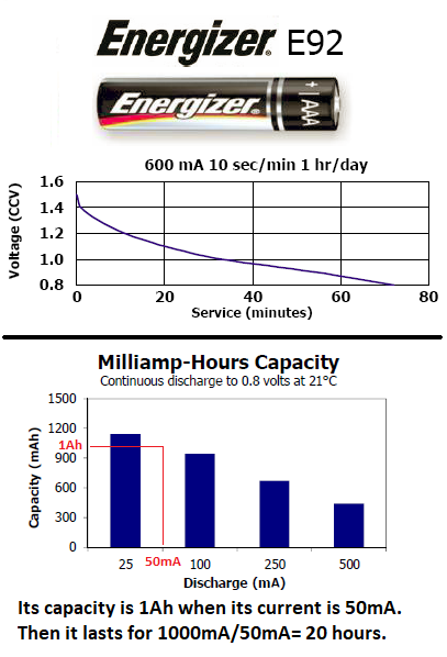

I have several Harbor Freight free flashlights with bad switches. There are 11 LEDs in a flashlight it runs on 3 AAA batteries. 3 batteries is 4.5v about 1a.
I seriously doubt your flashlight is drawing an amp. At any rate, my previous comment stands.
Batteries are 1a but not the 11 LED lights. Online datasheet says 20ma for white LED = .02 x 11 = .22a that should work.
Last time I checked, 20mA × 11 > 100mA. Verify the current draw of the flashlight before connecting it to the module output that can supply a maximum of 100mA.
My calculator says, .02 x 11 = .22 maybe that is maximum and not what it really is when the lights r ON.
0.02 AMP × 11 = 0.22 AMP
20mA × 11 = 220mA
Measure the current draw because you are just guessing what each LED may be drawing. If it's more than 100mA total, bye bye magic smoke.
Name-Brand AAA alkaline batteries can produce 1A for only a few minutes with the LEDs dimming during the discharge. The capacity is rated at 1Ah when the current is only 50mA.

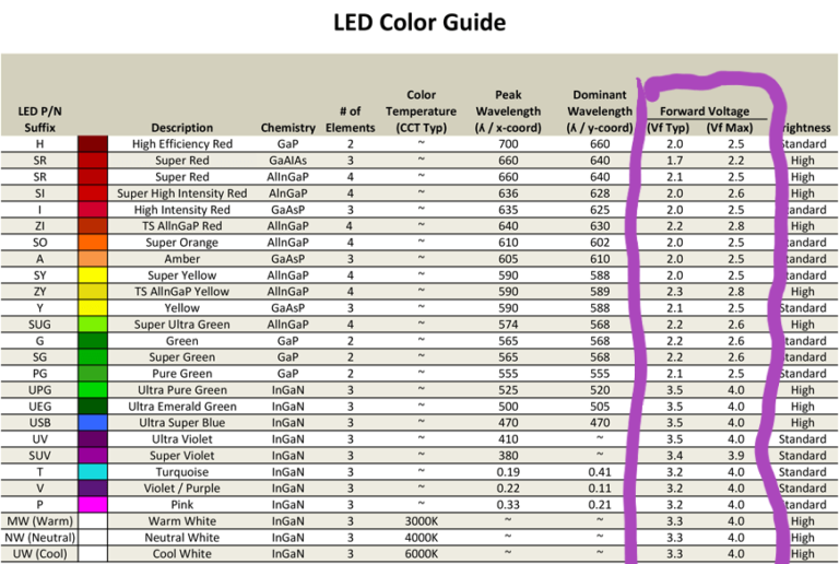

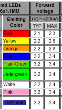

I am out of 47k resistors & out of 470 ohm resistors too. I wanted to build 2 more flashers before dark and I wanted single LED flashers. Now I have learned 1 LED flasher is not so good. Today I experiment with changing 10uf capacitor to 100 uf to see if LED flashes brighter. I have 47K & 470 resistors on order they should be here Friday. I have trouble testing LEDs they are not all the same voltage. No problem with Red LEDs, sometimes Green will flash & sometimes not, Yellow, blue, white will not flash on 2 AA batteries.

The forward voltage of an LED depends on the chemistry used to make it. Different chemistries result in different colors. So different colors of LEDs have different forward voltages, called Vf. The voltage applied must be greater than Vf for the LED to illuminate. This table is a simplified example of Vf vs color.
It's really even more complex than the table above shows. For example, green LEDs can have a number of different chemistries, so Vf varies over a wide range depending on the chemistry.
Vf for green LEDs can vary from 2.0 - 2.3 volts for most types, but can be 3.5 volts for some types.
Vf for red LEDs range from 1.7 - 2.5 volts. Almost every type of red LED will work from 2 alkaline batteries.
For an LED to illuminate in Gary's circuit, the battery voltage must be greater than the LED's Vf + the voltage drop across the transistor which can be as much as a volt. With a 2 battery supply, any LED with Vf greater than around 2 volts is pretty marginal.
