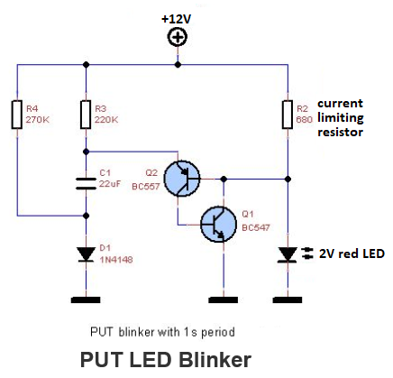

If I want a single Red LED blinker I need to build this circuit. I don't believe 9v is correct my other circuit said 9v I tested with with 1 battery then 2 batteries. Wait a minutes I can't build this I don't have these transistors.
There are hundreds of transistors almost the same as BC557 and BC547. But your circuit will blow up the LED because it does not have a series current-limiting resistor like your other circuit will blow up the LED with three 1.5V batteries, because it is also missing a series current-limiting resistor.
I made circuits something like that 45 years ago where the two transistors are in one package called a PUT. Look at PUT LED Flasher Circuits in Google.
Some circuits by students on the other side of the world DO NOT WORK. Here is a circuit that probably works:

This circuit does not work on 3 volts the LED light stays ON all the time. I put a current limiting 470 ohm resistor in series with the LED. Assuming 1uf capacitor is too small and LED is flashing so fast it appears to be ON all the times I changed capacitor to 10uf then 100uf there is no change LED stays ON. I changes 1M resistor to 470K and 47K no change LED light stays ON. I tried different color LEDs they all stay on. I swapped out the transistors to different values several times LED is still ON. I have a bag of brand new general purpose transistors, I found an NPN and PNP the LED stays ON. I tested transistors they test good circuit still no work. I have 50 transistors from old TVs I tested them and found 2 PNP and 2 NPN tested them to make sure they are good circuit still no work LED stays ON all the time. I am afraid to try 3 batteries = 4.5v LED will probably burn out. LED will not light up on 1.5V
Many LEDs need a bit more voltage (over 3 volts)to turn on. Others need around 2.5-2.7V. The fact yours is on all the time suggests that the voltage drop across the LED is roughly equal to the battery voltage and that may affect the transistor drive levels. In other words, there is not enough voltage difference across some components to allow charging/oscillation/etc.
You can use 4.5V if you wish, just make sure you have a current limiting resistor in series with the LED. I would suggest a 470 ohm to start with, which will limit the current thru the LED to around 10mA - enough to see it.
Did you try the circuit in post #42? Note that is has current limiting on the LED for +12V.
No I have not tried circuit on post 42 only diodes I have are 1N4007 will those work?
The circuit in post #42 will work with a 1N4007 diode.
In post #46 you said you tried the old circuit (where did you get the BCxxx transistors that you did not have yesterday?) and the LED stayed on. Then you might have destroyed the BC547 without any current limiting. Did you use different transistors? Maybe you have the pins on the transistor connected backwards?
I don't have any BC transistors only PNP and NPN. I tried several different PNP and NPN it will not flash. I just finished trying several different voltages, 3, 4.5, 6, 7.5, 9, 10.5, 12, it still will not flash the LED just gets brighter and brighter. Even if it had worked its too many batteries wasted on such a tiny light. I can build the other circuit with 2 lights that runs on 2 batteries if I don't want 2 lights I can put tape over 1. Maybe a diode will take the place of 1 LED and still work.?????
In circuit #42, the LED is powered by the +12V directly. When the transistor fires, it conducts the current away from the LED, thus making it go out (minimal voltage across the LED - does not conduct current). Your circuit is different.

The circuit (post #42) with the 12V battery has its resistor values calculated for a 12V car battery. It will work from a lower voltage when the resistors are calculated for it. But it draws a fairly high current all the time.

The 2 LED blinker only has 4 resistors, 2 caps, 2 transistors, 2 LEDs. It has been blinking non stop for a week, lights blinking as the exact speed. I did a video when I first turned it on now i can compare blink rate by holding it next to the screen and watch the video and flasher both blink. The 2 LED blinker was dirt cheap to build I think it cost me 15 cents using 100 quantity bargain packs of parts. The second one I built took about 30 minutes.
I will try the single blinker #42 maybe today see if it will run on 2 batteries.

I got the 2 transistor circuit working. I double checked the circuit there was 2 problems. I changes 100uf cap to 10uf. This circuit will not work on 2 batteries like the 2 LED flasher. The 100uf capacitor was taking so long to charge I thought the circuit did not work. This is the best circuit so far except for needing 3 batteries instead of 2 batteries. This circuit has, 2 transistors, 2 resistors, 1 capacitor, 1 LED. Circuit #42 is the same circuit with 2 extra parts it works too.
