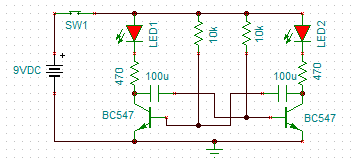

LED flasher does not work need help.
I tend to believe that the TINA simulator is somewhat less than ideal, at least in this case.
Perhaps. It simulates fine in LTspice.
The schematic is somewhat uniquely drawn, particularly the rectangular transistors - note the arrowheads outside the rectangle indicating the emitter.
yeah, that's an odd schematic symbol. did they invent that symbol or are they looking at some ancient textbook from before transistor symbols being standardized? it's similar to the "alloy junction" transistors from the mid 1950's

This particular circuit has had me flummoxed for years (yes, YEARS!)!! :banghead::banghead::banghead::arghh::arghh::arghh::woot::woot::woot:.
IT HAS NEVER WORKED! Either as a sim (both LEDs ON, no flash). 0r as a real ckt on a bread board.
View attachment 116103(Texas Instruments "TINA")
That very same circuit here.
What am I missing (if anything)?
And, yes, I have changed component values just to make sure that my math skills haven't gone kaflooey...
Anybody else care to comment?
When you click on the component in Tina, to adjust parameters, I think you can set an initial value. Try setting the initial voltage of one cap to 1/2Vdd (3v for a 6v power supply).
Thanks a ton, gophert!!
That did the trick. So did making one of the 10k resistors 5k. But that, of course, created an asymmetrical timing situation.
