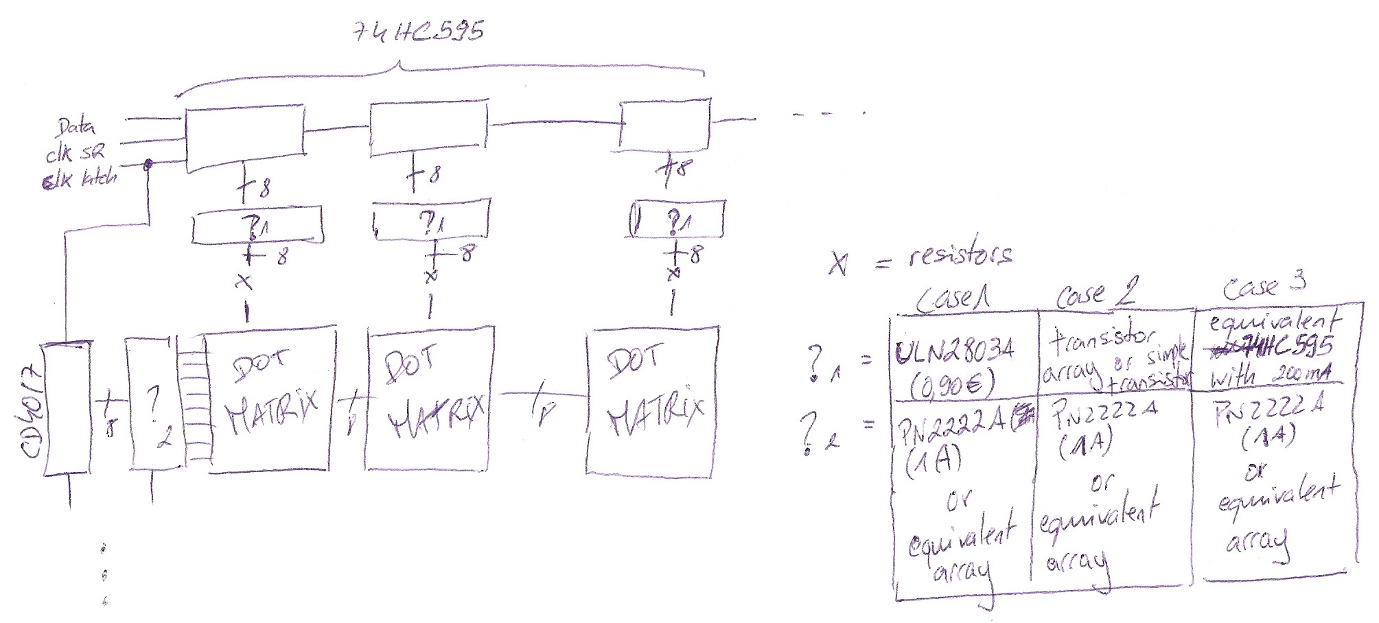

Freiheit
Here you have it.
Note:
Case 1 has sink elements at ?1 and power elements at ?2
Both cases 2 and 3 have sink elements at ?2 and power at ?1
I havent drawn the resistors in the "draft-schematic" just to keep it simple. Dont worry, I wont forget them ;)
btw, I suppose that the cheapest cenario would be the case 1. If you have a different opinion, please share it with me =)
Thanks a lot!

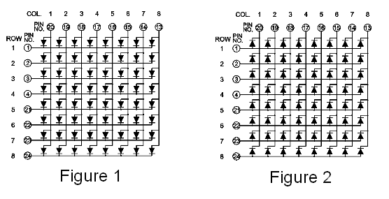

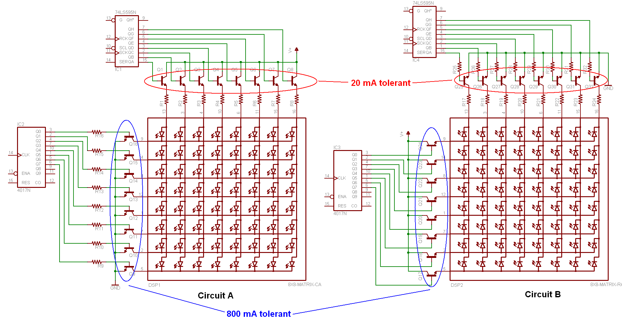

Circuit A shows an arrangement using an 8x8 matrix where the LED's anodes are connected to the columns and the cathodes are connected to the rows. In this arrangement the transistors connected to the columns are sourcing or driving the current and the transistors connected to the rows are sinking the current. Each column's transistors must tolerate 20 mA and each row's transistor must tolerate 800 mA.
Circuit B is the opposite of A and shows an arrangement using an 8x8 matrix where the LED's cathodes are connected to the columns. In this arrangement the transistors connected to the columns are sinking the current and the transistors connected to the rows are driving or sourcing current. Each column's transistors must tolerate 20 mA and each row's transistor must tolerate 800 mA.
Do you see that it doesn't matter whether it's the columns or the rows that are sourcing the current because you'll still need the same number of components capable of tolerating the same current flow for both arrangements. Which ever power transistor array you're looking at that's too expensive to use in the rows is the same array you'd need regardless of what's sourcing or driving and what's sinking. So, I'm not seeing how one option saves money over the other.
Maybe there are some nuances to your project you haven't yet shared which could clarify your view point?

About the sinking and sourcing elements, i didnt meant that it was easier for us, but its easier to the manufacturer of IC's to make sinking IC's than sourcing IC's. I don't know why either, its just what I have read.
I know that leds only allow current to flow in one direction, they are like diodes.
About the wiring thing:
Lets assume we have only 1 matrix common cathode.
you arrange them in 3x10 (total leds: 24x80). And then you would source the columns and sink the rows. But lets rotate this display 90 degrees. Now you have 80x24, and for "our eye" we are sourcing the rows. But obviously, the matrix rows/columns switched places.
I hope that this will help to clarify what I wanted to say.
About beeing cheaper/expensier.
My displays are common anode.
So I will be sourcing the rows and sinking the columns.
We have 24 rows. If I use discrete transistors, I would only pay in total 1.75 USD.
If I use transistor arrays to power the rows, I wouldnt pay less than 12.88 USD.
Then, in the columns, If I use discrete transistors I would pay in total 2.9USD
But if i use transistor arrays, I would pay in total 3.94USD.
To eliminate the biggest cost, I would use in the rows discrete transistors and the whole project would be cheaper.

The point about you switching back and forth what you call rows and what you call columns is an important one if you want someone to understand your though process.
