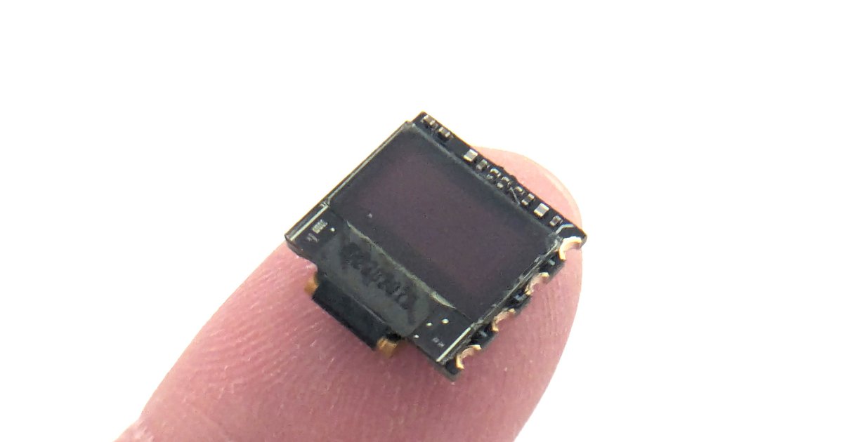

I'm wanting to design a small circuit that uses a digital potentiometer in place of a mechanical one but I can't come up with a tiny (fit-on-the-board) display that will give me some indication of the wiper position of the digital pot. Any suggestion for a simple means of indicating wiper position for the digital pot?
I'm greatly restricted in the total area for the circuit board. The digital pot, its push button adjustment and whatever display needs to fit on a one by two inch board. Any type of display, volts, amps, resistance, just something that give indication of the wiper position would be good.
Displays that require a complex wired control board are probably outside my abilities. I know nothing about electronics or circuit design. I'm reasonably good at reading a circuit diagram and soldering tiny components onto a circuit board.
Any help, advice or suggestions you might have would be greatly appreciated.
0.96" OLED displays are common, easy to use and quite cheap.
eg.
Other than that, there is a 0.42" one - but around 4x the cost:
Those do need a microprocessor to drive them..

If you do go for a lil tiny micro and the I2C 0.42" LCD then all the drivers will be found on the arduino system
You won't have to do much other than read the feedback, then monitor and change the pot value.
I should imagine the tiny micro could be hot glued to the display so all you need is a pin connected to the "feed back" voltage and the two or three wires to the digital pot.
