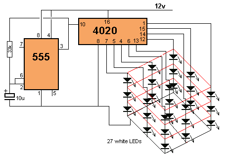

Is there a way to make an LED Cube (3x3x3 to keep it simple) that lights up to the sound of music (maybe hooked up to a speaker), create different patterns with a variable resistor and maybe using 555 - 4017s??? without having it to program on the computer.

To make it do everything shown in the video without a micro controller would be pretty difficult. I wouldn't want to attempt it. Even if you could figure it out, I'd think all the ICs required to drive it would take up way more room than the LEDs themselves. I don't want to discourage you. You could make an LED cube without a micro controller it just won't do everything in the video. Also, this would be a good project to learn micro controllers with if you're so inclinded.
It's not actually that complicated... Use a shift register to drive the LED's. Then you can use other shift registers and logic to generate patterns, mind you this will cost you MORE than actually using a micro controller.
The development software for many types of micro controllers are free, generally their either ASM based (device dependent code) or C based with some device dependent additions. The hardware and software for a programmer can be relativly simple and inespensive. I'm not sure if Nigels site covers it but. may help with basic PIC usage. There are other types of micro controllers available on the market if you want to investigate further.
It depends entirly on the amount of effort you want to apply to your project and how willing ou are to stick with it when you have to learn something new that will more than likely frustrate you to some degree.
You can put a mic on the front end of the 4020 to make the LEDs appear to flash at the rate of the misic.
