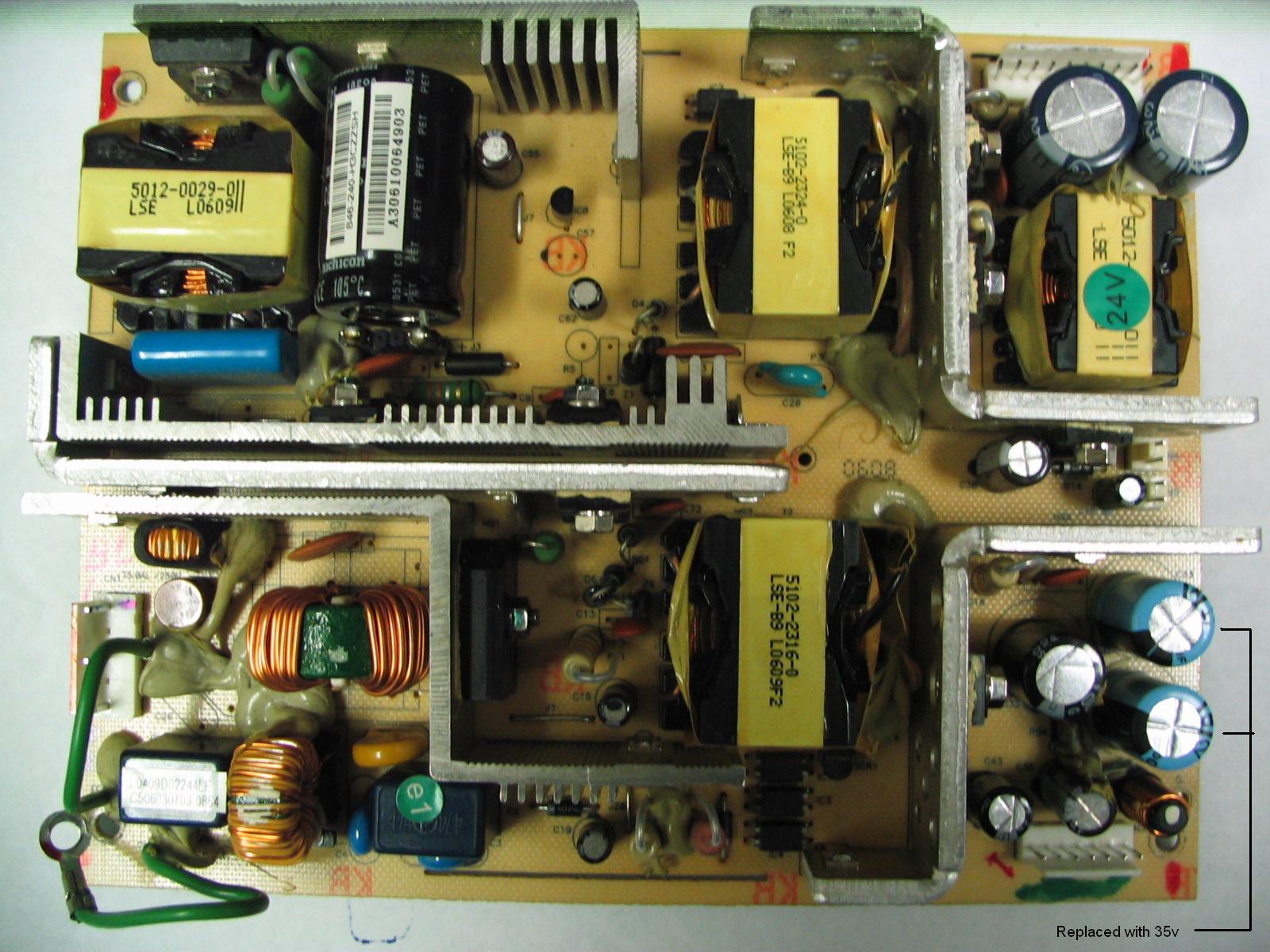

In yourphoto the 2 caps lower right are in the 24 volts supply and should be replaced with 35 volt caps. They produce the symptom of shutdown after a few seconds.

The five I replaced already (in the lower left, in the larger of the two photos) were 100uF, 220uF, and three 1000uF. All 35v to begin with, so I replaced them all with 35v.
The two on the right are also presently 35v, 2,200 uF. Haven't replaced those yet.

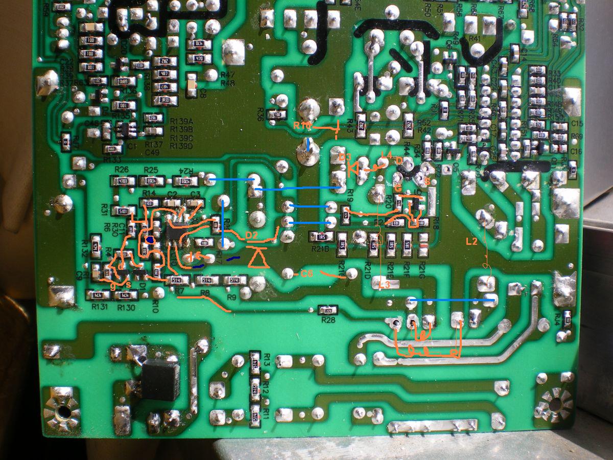

That is not the power supply I have but if you have a macro camera, a photo of a partial trace such as this would help. Notice I am using direct sunlight.. The jpg is imported into paint and traced.

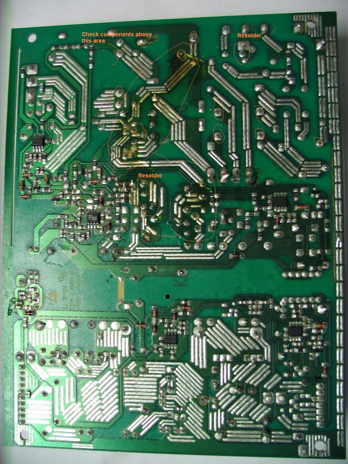

THANKS karyoker for the quick respond, I am an armature 62 years old with electronics, but very good at soldering and paint program, I hope this pics represent your board.

Initial observations Check components above discolored areas Resolder circled joints
