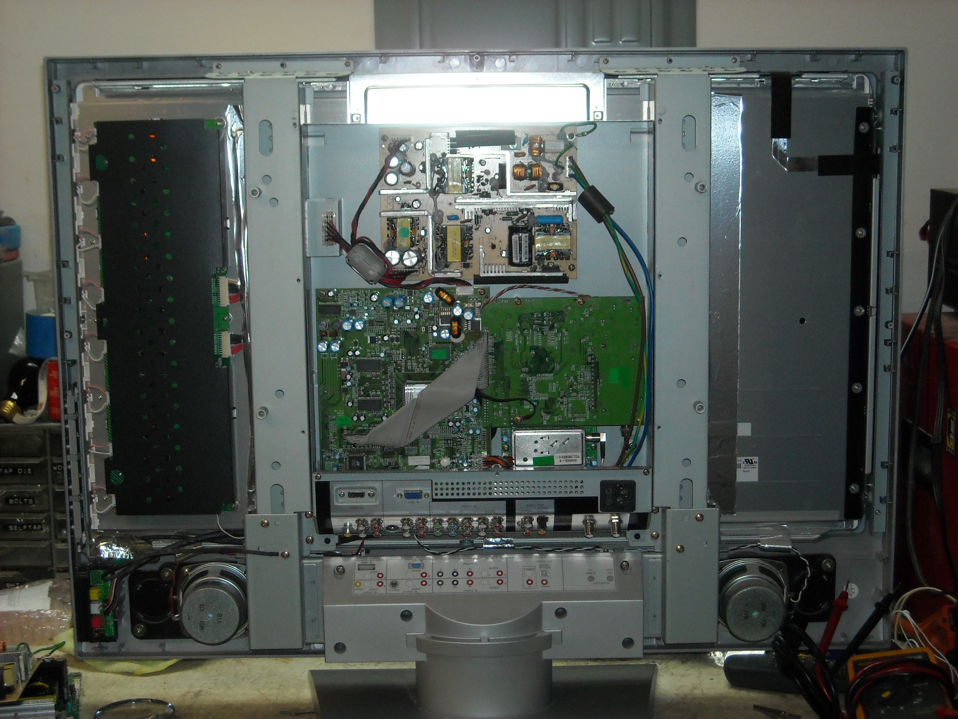

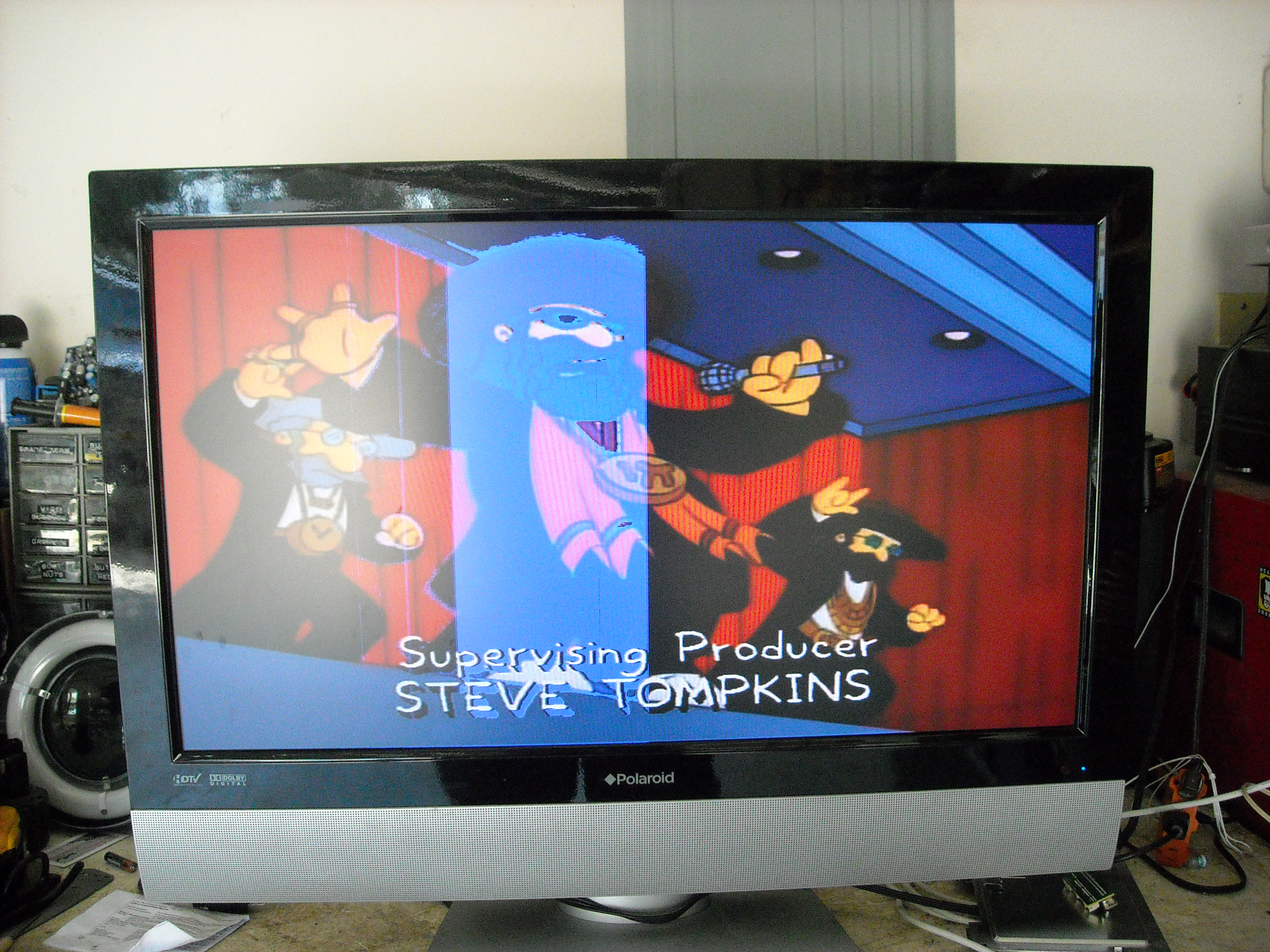

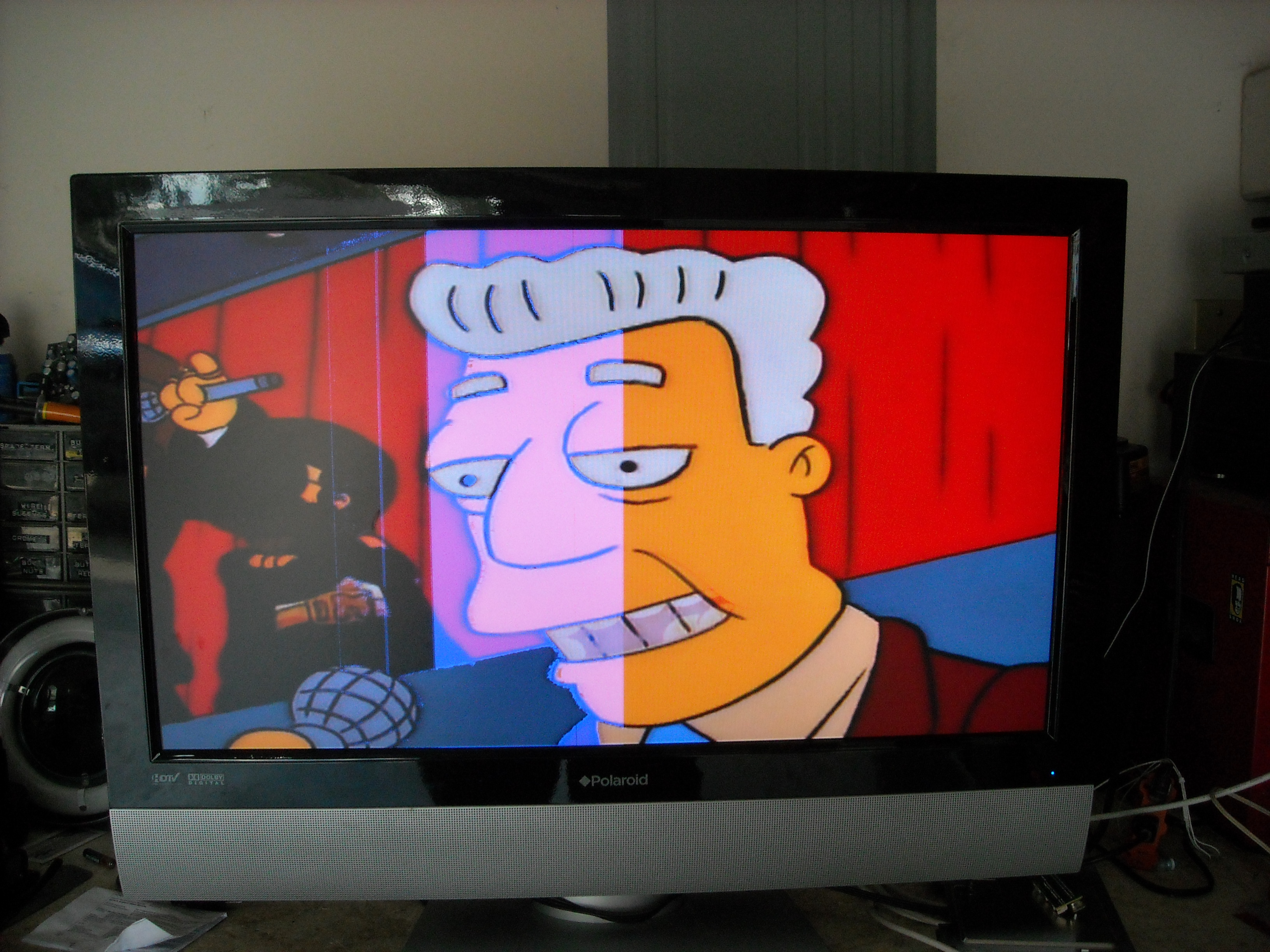

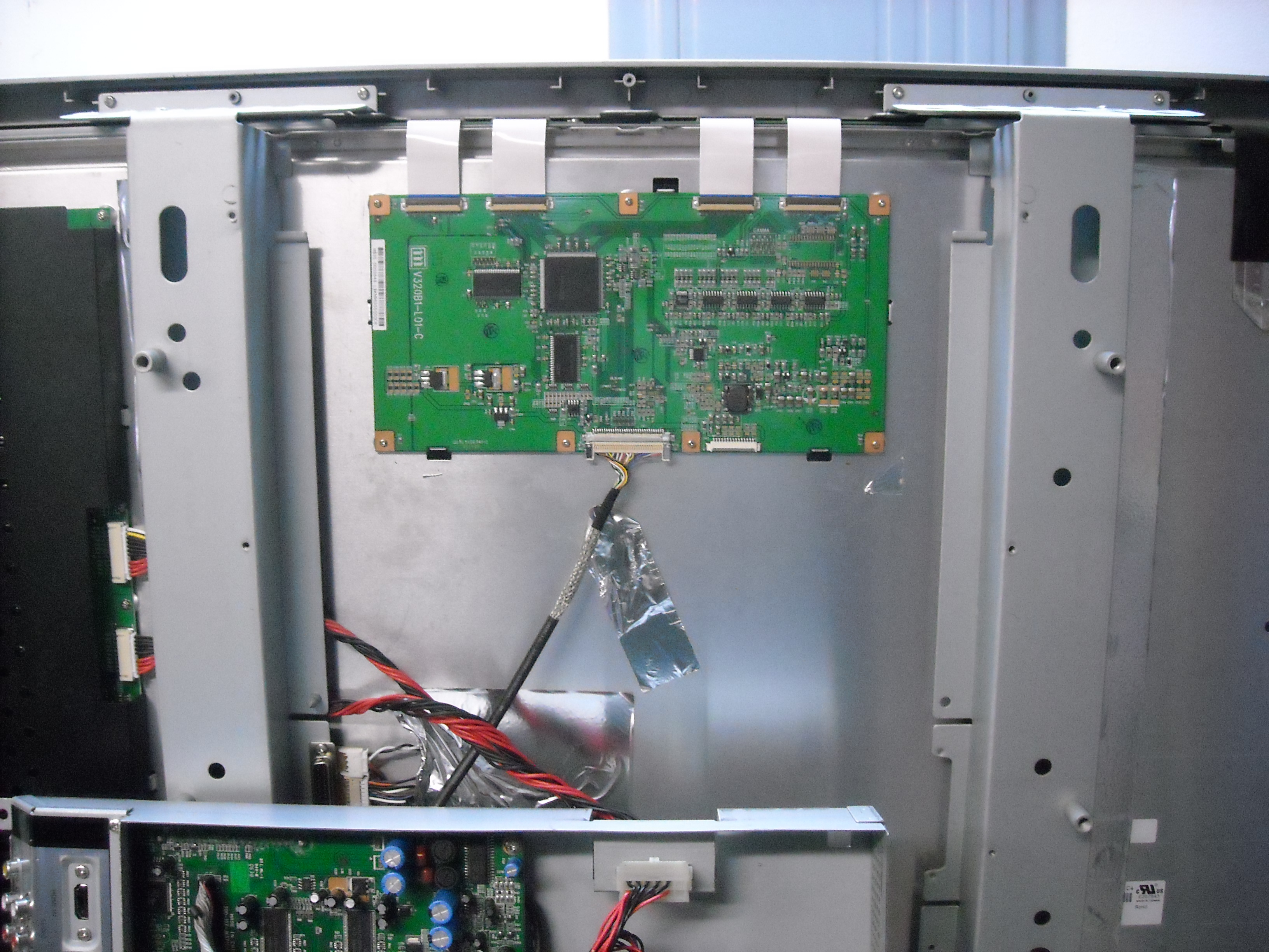

Ok...I have changed the power suppy. Tv powers up. Had no picture so I put in a used Main Board. Tv then had a tye dyed look to it. I then changed the T-conn board on the back of the LCD Screen behind the control box. Got a good picture except for the 6 wide spot where there is no red color. I then ordered a new main board and swapped it out. Thinking the main board I got was bad I RMA'd it and got another only to have the same spot with no color. I do not know where to go from here. I am into this tv for 175.00 (repair parts) and dont know if it is worth spending another penny on. Anyone had a similar looking screen that was able to be fixed? If so what part did you change. I have checked all of my connections by wiggling while the tv is powered on and it makes no difference to the bad spot on the screen. Note: When the tv powers on and flashes the polaroid logo the screen is perfect. Pictures included

That's a pretty obvious sign of a duff LCD panel - it 'might' actually be the LVDS board, but that's not normally available separately, but comes as part of the panel.
Is the LVDS boaed the same as the T-conn board? I have changed this already. Board that is mounted on the back of the LCD with with 4 ribbon calbes that run to the top of the LCD Screen. Also has a small multi wire cable tat runs to the main board.
