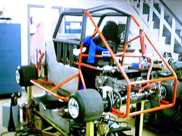

I can't help you with the radar but I can tell you how I build a speed read out 20 years ago. About 20 of us raced go-karts and we wanted to know how fast everyone was going. I used an industrial device from work that counts parts on the conveyor belt assembly line. This device sends a beam across the race track where a reflector sends the beams back to the receiver. There are 2 of these devices setting a 8 feet apart. When a go-kart breaks the first beam it starts a number counter that counts up 0 to 100. When second beam is broken it stops the counter and holds the number for a few seconds before it resets. My go kart use to stop the counter at 87 mph that was my top speed. You need to do the math to determine how far apart the beams need to be. Beams need to be exactly parallel. There is probably much better technology available today. The device I used did not count mph it counted in micro seconds.
Here is a picture of my go-kart it has a 4 cylinder 65 hp mercury outboard motor on it. Gear ratio 3.2 to 1. Water cooled with disc brakes.

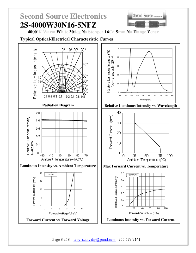

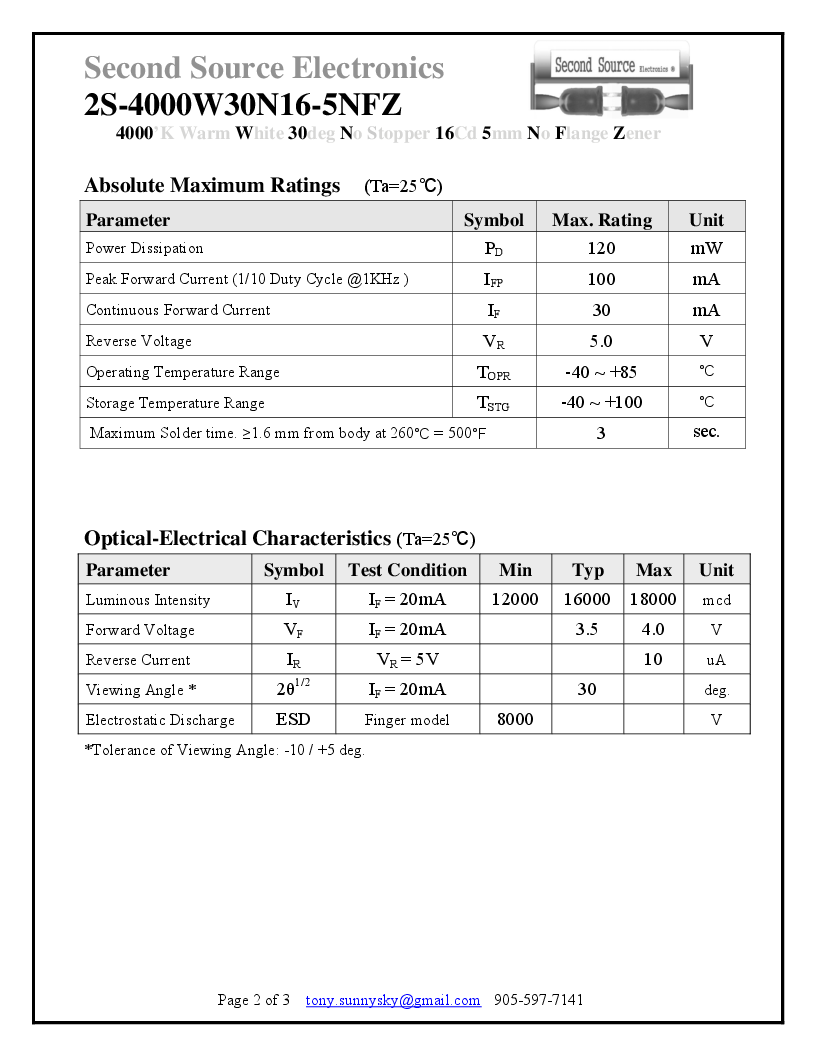

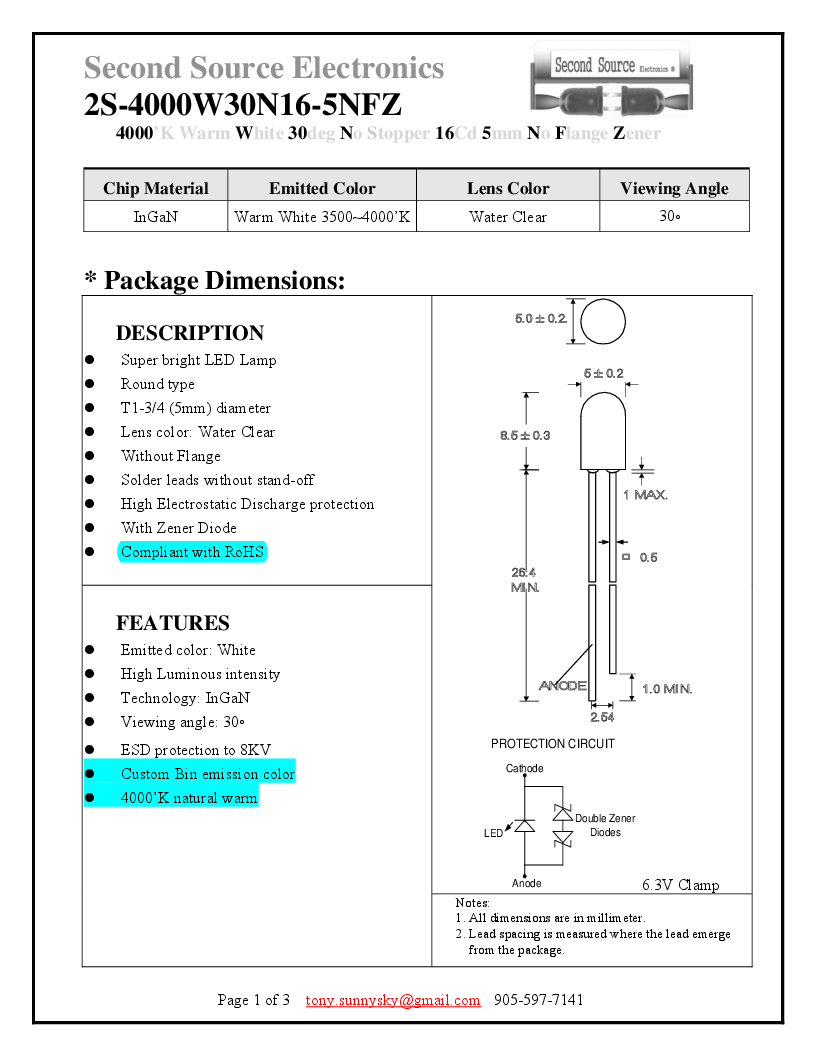

It is trivial to make any size LED digits. get 12V LEDstrips and cut into segments then a 7 segment driver with for each segment using 1A Nch segment drivers and 5A Pch FET digit drivers. using 12V CD4000 logic. or whatever you can do better. Then adhere to black background . Boost to 14V if not right enough. Or use 5V RGB with SIO control. Then cover with Clear or diffused colored film from an art store if monochromatic.
If you need 16 Cd 5mm 30deg LEDs they will be 10x brighter than a stripLED at 20mA ea. I have a ton of surplus in WHite, Red Yellow
I also have 30 Cd. These are old specs. the Vf is now 3.15 +/-0.1 @20mA 16Cd~20Cd
ph # is obsolete.
