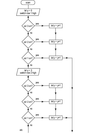

does anyone know where i can get a pic basic pro sample to display a key being press then display on the lcd. i'm using pic 18F452 chip to do the job.

you can follow this flow chart...it gave me such a hardtime to finish a project just like yours. so giving you this chart to followe...it helps a lot...study well and good luck..

thanks..for the flow chart...it help a lot. if i were to output the key pressed on to the lcd. Can i just set a temp file to stored the key file and lcdout?
