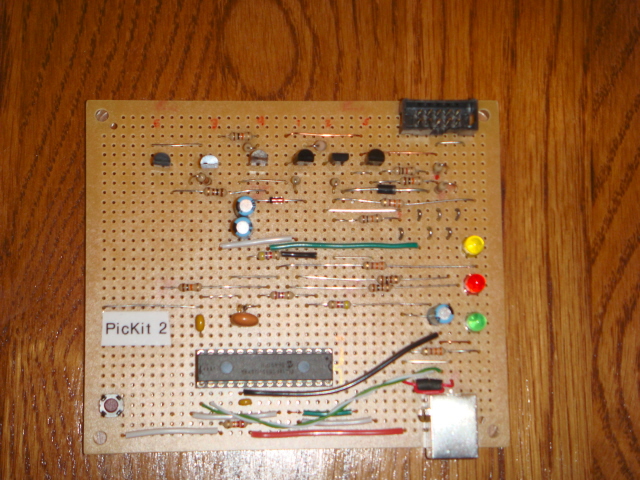

Hi, guys!
I've made a Junebug (just the programmer & debugger part) on a test board. Used a modified JDM to write PK2V021000.hex in the pic18f2550, but I still get "USB device not recognized" message when I plug it on my PC..
Measured 5V on U5V, and 3.3V over the 0.47uF capacitor. If I press the bootloader switch the red led blinks: I guess the oscillator is running, so is the firmware inside. Maybe some configuration bit was set wrong (but how!)?
I overchecked the connexions and it appears to be ok.
What should I do? :|
On an early version of the schematic the USB D+ and D- lines were swapped. Try reversing them. They are correct on the PCB and the current Junebug manual.
Yes, you're right, the D+ and D- pins were swapped (because I didnt't verify this in the pic's datasheet..). Thanks, Bill!
My Junebug it's not the best looking one, but is small and it fits in a 7x4 (cm) plastic box. Now it seems to work fine (it passed the troubleshooting test in Pickit2). I just need to build a test board for it (maybe Unicorn ?).
I'll attach a picture of it (while it is connected and running ):
Nice job August and the scavenger. You should also consider adding (or building seperately) the tutor part. It makes trying out ideas so much quicker.

blueroomelectronics said:
Looks pretty neat August, my first prototype was point to point using 30guage Kynar.
Looks nice from the top Bill, how about a picture of the bottom?
