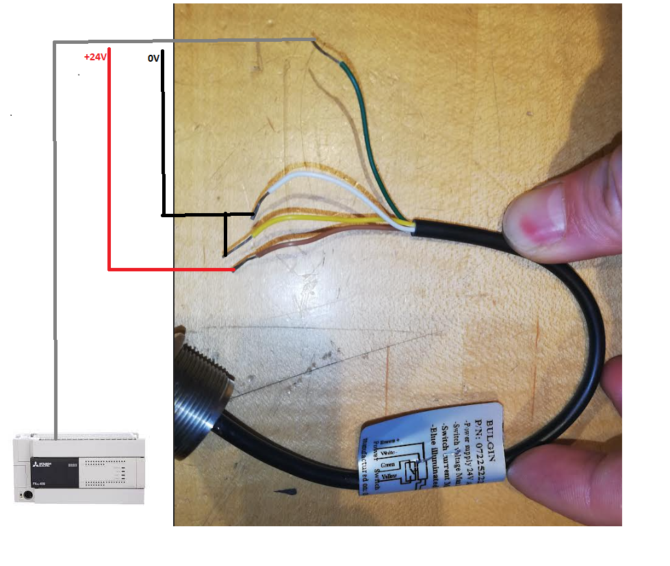

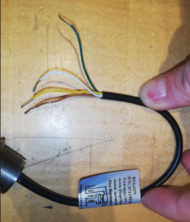

This is the pinout:
This is how I connected it:
If you look at the datasheet, the switching contact is rated at 24VACDC 1 A.
It seems that I have destroyed 3 buttons.
There is a short between brown and yellow.
What did I do wrong???

I agree with JimB. The colour coding SEEMS to suggest that the contact wires are grey and the supply wires to the LED are black and red. These colours do not seem to match the colours of the wires on your switch. I think you will have to contact Bulgin to explain why the wire colours on your switch do not match the colours shown on the data sheet. I think the wire colours should also be shown as text as well as coloured wires on the data sheet.
Les.
The wiring colour code is on page 4 of the data sheet.
For the 4 wire 19mm one, brown and slate are the LED, yellow and green are the switch.
(I'm guessing that the dark one in the photos is green?)
The 22mm 4 wire one shows different colours - try those?

This is how I determined the wiring:
I already have onboard a similar Bulgin piezo button, it's just 22mm instead of 19 and it is latching instead of momentary.
You can see this 22mm button and label below:
BROWN is +
WHITE is -
GREEN and YELLOW are NO contacts
I assumed the new button would have the same pinout.
I did a small test - I've connected every combination of 2 wires to 24VDC on the new button.
The only time the button illuminated was when I connected BR to + and WH to -, so I am sure what is the purpose of BR and WH.
When I connected GR and YE on 24VDC, I got a short, and damaged the button.
Regarding the YE and GR, I know they are NO contacts because, when I would connect the button to PLC input in the below manner, it would activate PLC input whenever I would press the button:
The button didn't get damaged while being connected to PLC, btw.

The picture above looks OK, assuming that's the exact switch you're using - but why not leave the 24V connection off (it's only to illuminate the LED), and make sure the switching works correctly before you try adding the LED.
What do you think of the way I connected it to the PLC? Is that OK?
You show it switching to ground? The commonest setup on PLCs (and the only option on many types) is to have inputs switching to power.
It depends on the particular PLC and, if it is reversible, whether the input common for that bank is to ground or power.
If a normal switch works in the same configuration, then the arrangement is OK.
Depending on the PLC input design, it may need an additional load across the PLC input?
If you get 20V or more across the switch when its wired, it should be OK.

PLC inputs are switching to the ground, that's why I connected it that way.
What do you mean "and additional load" - you mean a resistor? If yes, how exactly to connect it?
"If you get 20V or more across the switch when its wired, it should be OK." - between which wires?

You are completely right, the momentary switch works without 24V delivered to them.
I've connected the switch to PLC by just using the GR and YE wires on my switch (BR and WH are for LED supply) and it works perfectly.
So, I've connected GR to the 0V and YE to the PLC input. All good, let's see if any of switches burns out...
