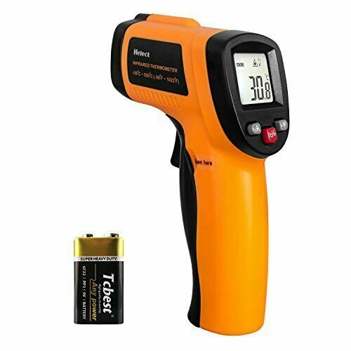

My first thought would be a pyroelectric infrared sensor with some form of automatic background adjustment to compensate the ambient reading; plus possibly an appropriate IR filter to block longer wavelength IR.
An IR laser should cause a measurable increase in the output from such a sensor? You could try that with a basic IR thermometer, this style of thing:
If the laser was modulated a different system would be more appropriate, but for a simple solution and an unmodulated source the pyroelectric type is the only thing that comes to mind.
Thanks for that rjenkinsgb, ill look into that, but ideally id want the actual system that's inside the body of the gun, in a smaller size, inside like a 50mmx50mmx55m (lxwxh) box which would be amazing.
