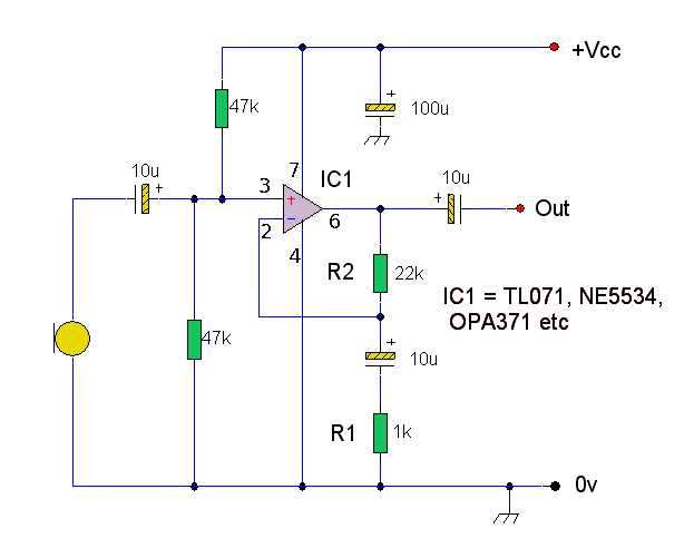

Here are 2 circuits for instance which I would like to know how to measure /calculate the input/output impedance for them?

The opamp one is simple, input impedance is 23.5K, output impedance is pretty low (which is all you need to know).

Nigel gave the correct input impedance for the opamp circuit. The feedback has no effect on the input impedance for this circuit.

In the second circuit, the output impeadance is the small amp's output impeadance parallel with the effect of the feedback resistors. The junction if R2 and R1 will remain at VCC/2, so the current through R2 due to a test voltage applied at the output is:
V(test) - VCC/2
R2.
The same current flows in R1. A KVL and a little algerbra and you have your answer.
After consulting Sedra and Smith, I have to change my answer for circuit #2. We define the inherent output resistance of the amplifier as ro, which can be from 50 ohms to several hundred ohms. Also, the open loop gain, we define as "A" Then, V- is the test voltage, Vt times the resistive divider:
V- = Vt*R1/R1 + R2. And the amplifier output voltage is Vo = -A*V-, which is: -A*Vt*(R1/R1 + R2), or --A*Vt*β,where β=R1/R1 + R2.
Now, the current due to the test voltage is: (Vt/R1 + R2) + (Vt - Vo)/ro, or using the equations above for Vo:
I = (Vt/R1 + R2) + (Vt + A*Vt*β)/ro
Finally, 1/Rout = I/Vt = 1/(R1 + R2+ + (1 + Aβ)/ro, and so
Rout = (R1 + R1)//[ro/(1 + Aβ)
The sedond term dominates so
Rout ~= ro/(1 + Aβ); where β is R1/(R1 + R2)

could you tell me why the input impedance of the noniverting op-amps in the second circuit is 23.5k??
Besides I asked a question about how to determine the value of the cap connected on the top of the R1 in the circuit? I want it to be short at AC so how determine the value of it?
In impeadance analysis, set all DC sources to zero. Then, the iinput impeadance seen by the signal source is the two 47K Ohm resistors in parallel. Half of 47K is 23.5K. For the capacitor question, you want the impeadance of the cap ot be much less than the resistors connected to it, so since one reisitor is 1K, then use the formula:
Xc = 1/2ΠFC << 1K ohm, where C is the value of the capacitor, and F is the frequecy of operation. Solving for C gives:
C >> 1/(2ΠF*1Kohm)
C >> 1/(2ΠF*1Kohm)

the + and - inputs of the op amp are separated by a theoretically infinite impedance. there are actually physical limits to this, and it's usually in the range of 10E+10 to 10E+12 ohms, so it's much higher than you need to worry about. so R1 and R2 are isolated from the input impedance of the + input. if this were an inverting amp, then R1 would be in series with the input and a "virtual ground" at the - input, and the input impedance would be the resistance of R1. R2 wouldn't matter because it would be dropping the whole inverted output voltage across it and ties to the same "virtual ground".

I know this will probably confuse our OP, but Zout of the op amp is complex (has an imaginary component) due to the gain roll off of the op amp. In other words, A is complex, so Zout is complex, and appears to have an inductive component. Zout will rise with increasing frequency, and the voltage will lead the current.

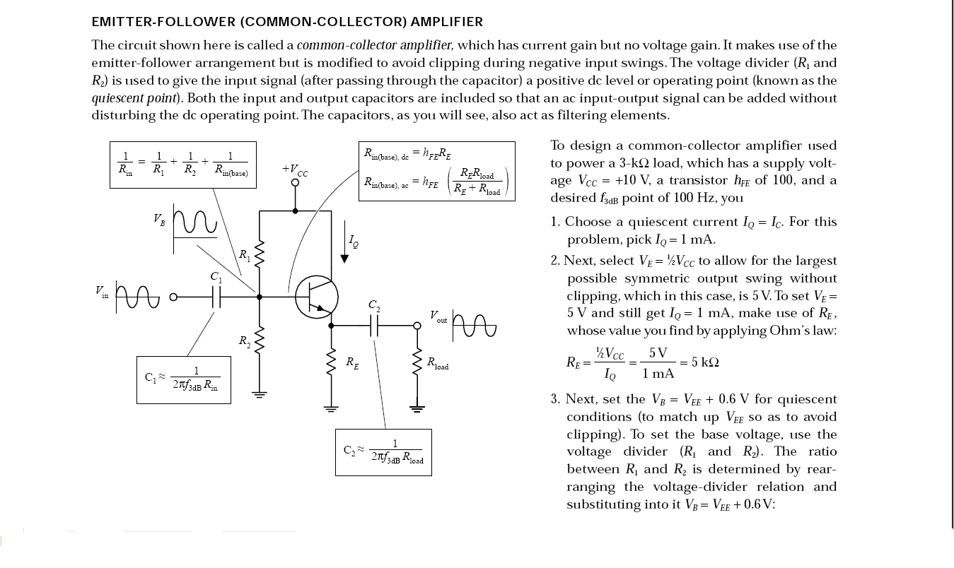

But I took a look at PRACTICAL ELECTRONICS FOR INVENTORS book and it used the formula I told (What that formula States really?) And when Is help full? What is F-3dB for an input cap which is working at 20Hz to 20Khz?
