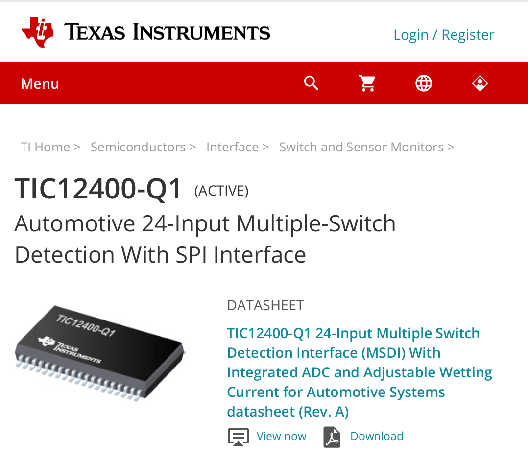

Maybe MrDEB should use this part from TI.
Seriously, not a part for MrDEB as the data sheet is 94 pages, but it is an interesting part. 24 switches which may be high or low active plus an ADC to handle several of what the call analog coded switches, which in the automotive world csn be multi-speed switches for wimdshield wipers and heater fan controls. You still have to supply the ADC values of the switch points but it relieves the micro of the ADC task and determining which step is selected.
You posted a picture that will never work can't cut and paste.
and make it work LOL
