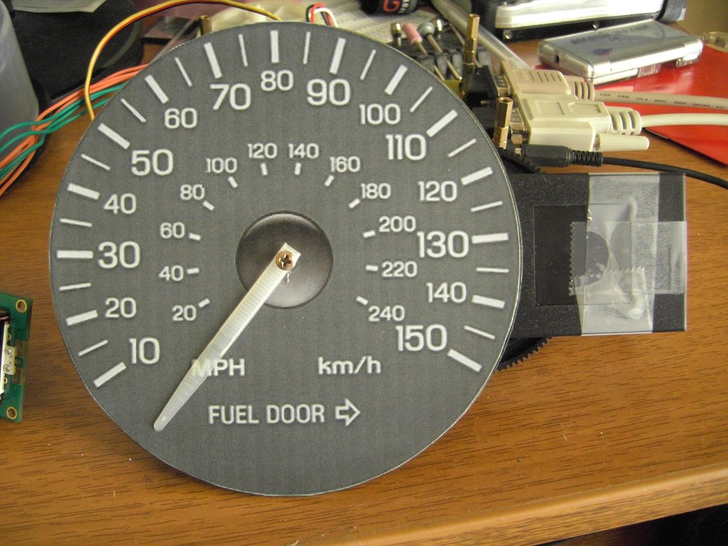

curious question?? a steeper motor instead of an anglouge type gauge using a coil and a needle for pointer?
Boy am I stuck in the dark ages!!
curious if them steeper motors can be used say for a small robot?? like a line following type bot??
Probably not. They are designed to move a pointer weighing vitually norhing over a amall arc.

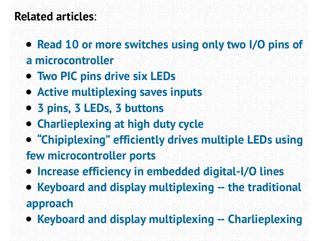

Adding some worthwhile content to this epic post, this article from EDN looks at using diode-encoded switch arrays: Encode dozens of buttons with only four lines. It provides good explanations of how diode-encoded switch arrays work, getting as many as 274 switches from just 4 i/o lines.
There are also links to a number of relevant articles as shown below. These links are at the end of the linked article above (i.e., this is just a picture - click above to find these links).
LOTS of interesting info

Before I get side tracked I had an idea using the instrument servos. Update the servo clock using 4 instrument servos
One for month, one for day, one for hour and one for miniutes

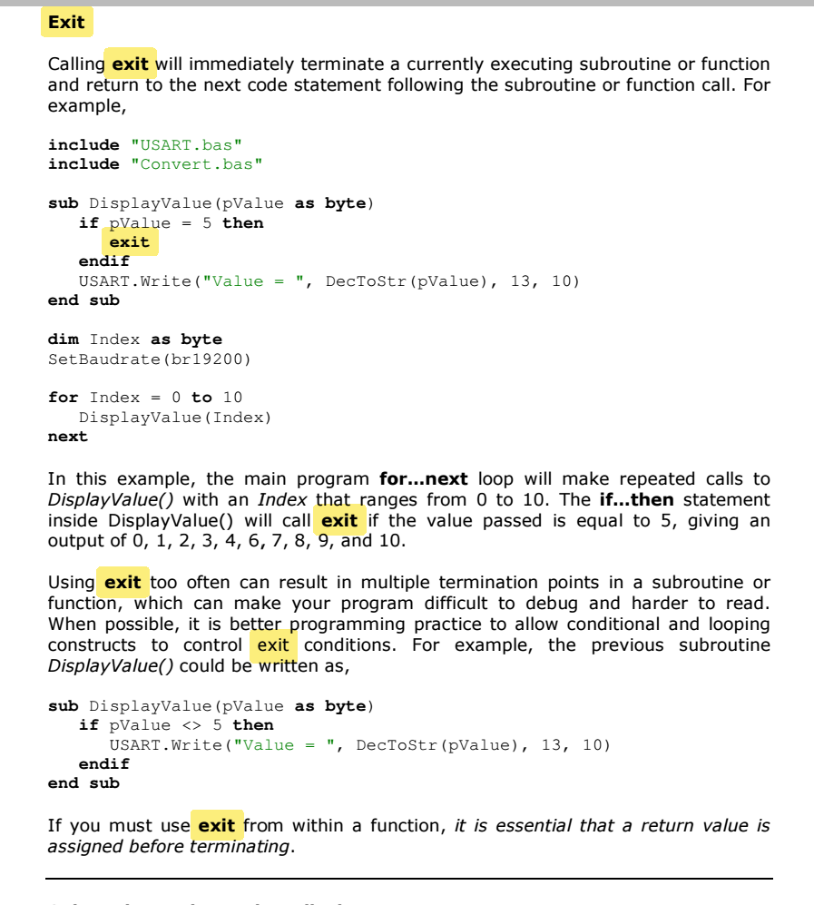

I inserted an EXIT and have the subroute as a private sub but after I depress the pos8 button, which is supposed to EXIT the sub route and hopefully save which buttons were depressed, ignoring all the FALSE logic statements. the for next statement is for designating each players button with a number. PLAY() are the leds and pos() are the buttons/switches.

I'm not the smartest guy in the boat. But do you know what PRIVATE SUB means just asking?
It means that it's private and only available from within the module it was declared.
So if you want to use it's findings somewhere else that's not going to happen you
probably want Public
Or just a plan inline sub But private kind of means private so the stuff it hold don't mess up the rest of your code.
Kind of a short way of saying it.
The code you posted would be better being a case statement.
I tried a case statement but it turned into a big mess. Am using IF THENS for now. They are one in the same anyway.
will try a public sub route.
