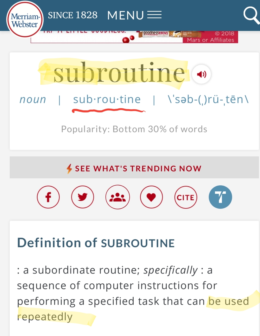

A sub route is what I was thinking this morning but had other honey do's to complete first. Will try your suggestion as well as the idea I was rolling around but would entail 10 sub routes, one per switch position.
Thanks, will run your suggestion.
....the idea I was rolling around but would entail 10 sub routes, one per switch position.....
Make some effort to understand what I took my time to write for you. I explained each step fully so you should be able to follow it.
MrDEB, I think 10 subroutines is an excellent idea:D. Nine more things to go wrong.
It is kind of special to have the code I spent my time working on snubbed by someone who thinks 10 separate sub routes would be a better answer.

Of course what I posted tequired you to fill in the details as I had explained.
If you read the code, you would see that I intended the LEDs to stay on until all players had pushed their buttons to be in the game. How else can you know you're in? When yoi press the done/ready/play button, the LEDs are extinguished as can be easily seen from the code. There's not much code there - you should be able to understand it. It's trivially simple.
You've entirely missed the concept behind subroutines. Both what the word is, and what it means.
