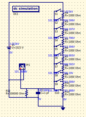

See if my thinking is correct. The ADC.read(9) outputs a 10 bit number (0-1024)
using Mikes suggestion, 1024/10 = 102. 1024/20 = 51 for no key pressed. Add 102 + 52 = 154 for first key pressed. Add 102+154 = 256 for second key press etc. This is basically what needs to be computed.
Going to solder this circuit to a perf-board with the 10 switches and add the extra circuitry as code progresses. Found writing code in snippets then combining all seems to work better.
Now just to procure some perf-board.
I was attempting to try >52 <256 for first key but it doesn't work. A larger window for the SELECT CASE.
What mike said would work if you do as mike said But you said your not getting even reading which you should be.
Add 102 + 52 = 154 is not what he said
post #131 is what I am referring to.
Am trying the usart approach but only getting 1 reading regardless what "button" is pressed.
Need to re-access what the uart is doing and looking at using the software uart but not until I figure out why it is not working right.

Am using the circuit in post #126 (has 2K resistor to grd. but will try without the extra 2K resistor
Thanks. It is close but the uart shows what button instead of having to count which LED is enabled.
I need to tweek the numbers a little as it jumps from #2 to #4 and two #7's
just some tweeking. Hopefully after I get some perf-board and solder a board together I can eliminate erratic outputs etc.
That's with Mikes figures don't work with Jons post 126
mike said 10 resistors total of 10 k jon has 12 k that changes the math

Why don't you just have a little loop that squirts out the ADC values continuously while you figure it out. I must be really smart or....nevermind.

See if the #%=& hardware works right and gives results close to what's shown here (i.e., approximately uniform steps, in order overing the range of the ADC)....then work on the software. Like rational people do.

If he uses the layout on post #126 it not going to read like Mike said
If he uses 10 1k resistors and ties the adc to ground with 100k and .1uf code I posted works fine anything else happens maybe im not the only one who can't see now days.
