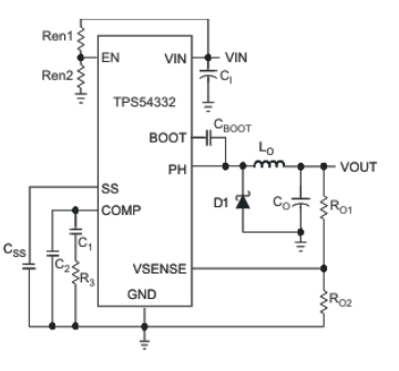

He needs simple. This project is too much for the first one. It is way beyond his skill set. One option is this circuit to make 24V and then add two simple buck circuits to get 12 and 5.
View attachment 134508View attachment 134510View attachment 134511

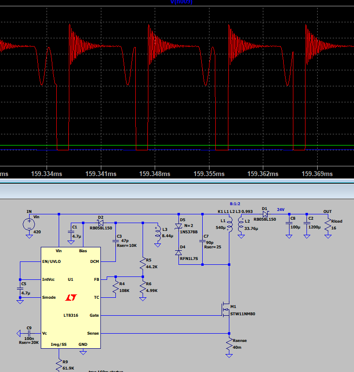

Here is a 400VDC to 24V isolated flyback. Not what you want but a start.
Attached is a file. Down load LTSPICE and put it on your computer. Then open my file.
You should see the schematic. Click on "run" and wait for a while. Click on the output voltage. It will take 150mS for it to start and make voltage.
This is a good place to learn how things work and what happens when changes are made.
Save the schematic to a different name before making changes so you can get back.
Red trace is the voltage on M1.
Good luck
