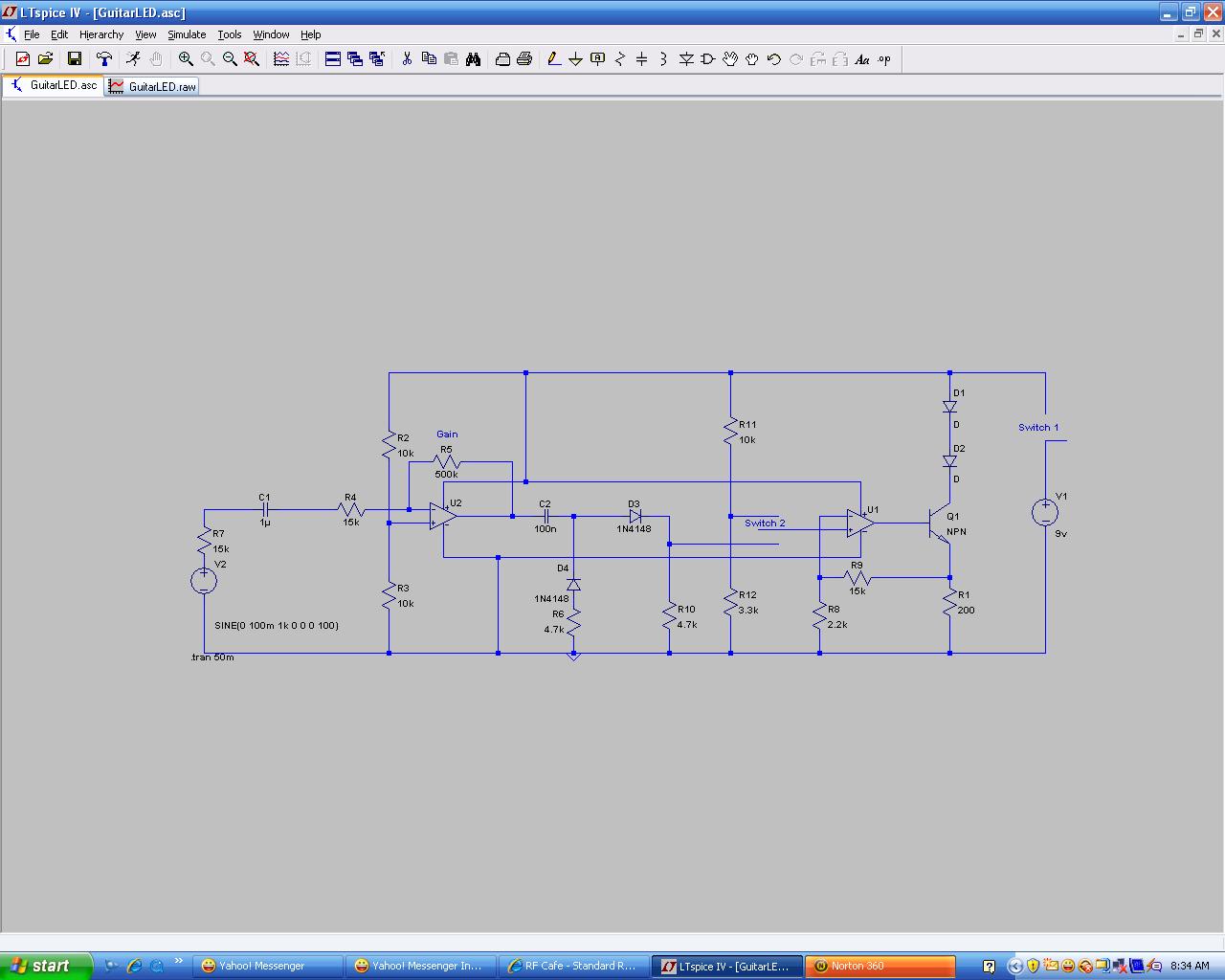

I would like to integrate a sound-to-light module below the scratchplate (pickguard)...
(mockup of the "Ghost" with Perspex body and blue LED lighting)
I know that there are sound-to-light kits readily available but I would like one with the following specs:
  • works using the output of a guitar pickup (I think it's between 100mv and 500mv)
  • needs to be as "transparent" as possible (no detrimental effect on the sound of the guitar)

If you want, I can take the circuit you linked and show you how to put in a switch for some of the effects you want. Then you can experiment and see how happy you are with it's performance.
Thanks, BrownOut, that'd very much appreciated. :) **broken link removed**
In the attached drawing, I've added two switches and a 10K variable resistor to the Musicator. The 10K resistor is R7, and acts as a fader control. The component labeled "Selector Switch" chooses either the guitar input, or the fader control. Any 10K variable resistor will do for R7. R5 is also a variable resistor, and replaces the 470K ohm resistor in the original schematic. The switch "Power Switch" disconnects the 9V.
I have no idea what the levels from the guitar pickup are, and so I'm not 100% sure is this will even work. I encourage you to build it with the standard mic and series resistor at first to get everything working, then try it with the guitar. The Gain variable resistor can be adjusted for varying input level, but if the guitar signal's impedance is too high, a buffer ( or additional amplifier ) might be needed.
Sorry for the weird schematic symbols. My editor doesn't have all the symbols I needed.
EDIT: Error ridden attachment replaced.
Passive guitar pickups normally output a signal between 100mv and 1v (for powerful pickups).
The ones I'll be using will probably be in the 500mv too 750mv range.

Happy birthday! I turned 50 last week. The output voltage from your guitar should be OK, but the other thing is the impedance. You may or may not know what that means, but basically, every voltage source has a characterisitc resistance or impedance. If the guitar output impedance is too high, we might need to make a small change to the circuit.
The drawing has been corrected.
PS: Use the variable resistor labeled "Gain" to adjust the circuit if the guitar's output it too high.

Get a couple extra opamps, or a quad package if you can. That way, we can add buffers if needed.
Something I forgot to ask: the guitar output and the input on the circuit are connected in parallel right? **broken link removed**
It's not really parallel. The ground is wired directly to the lower connection shown on the schematic, and the signal is wired to the top one.
