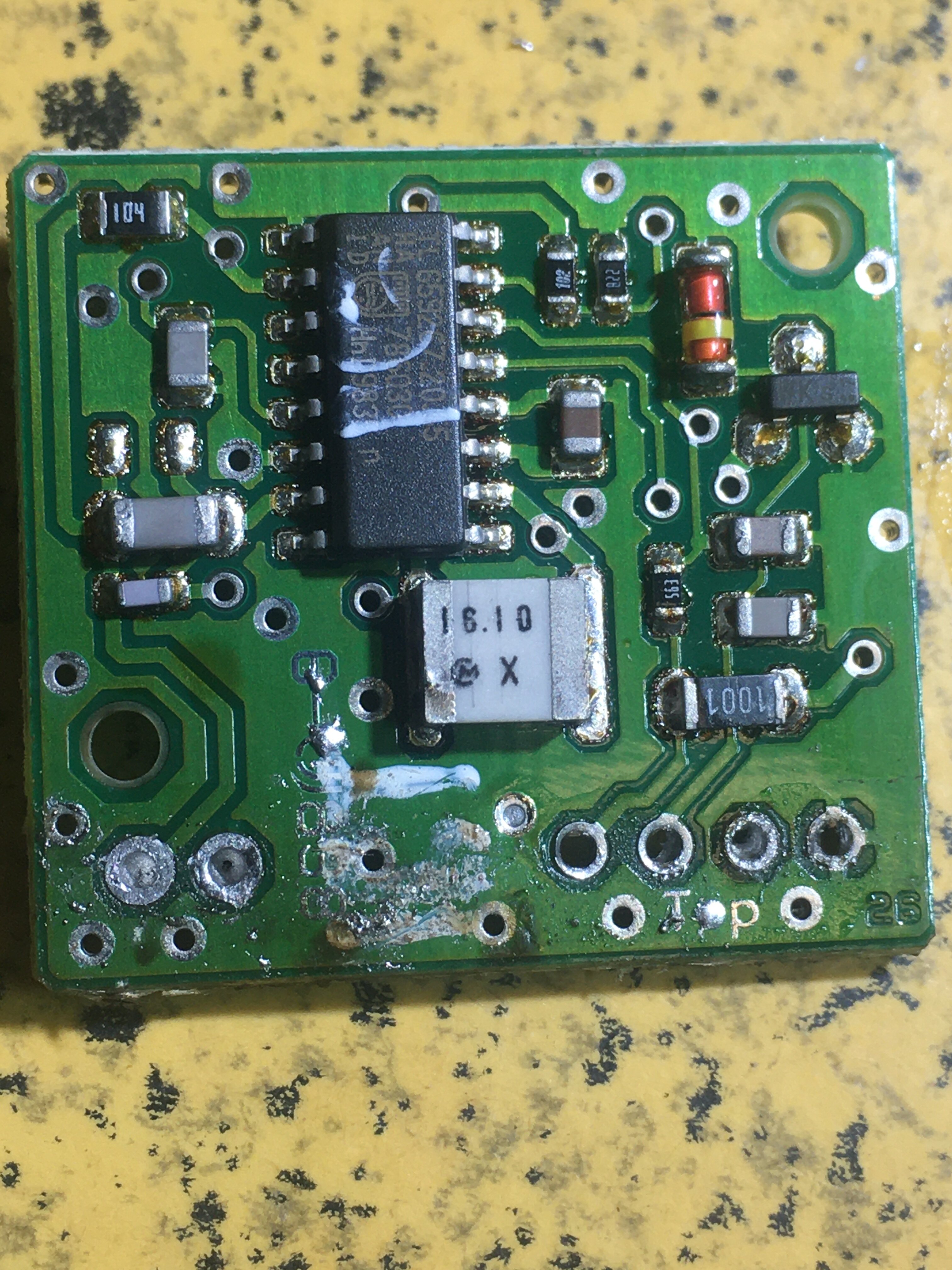

Identify Crystal on Ford Immobilizer antenna board
funnyboy7
Hello!
Can anyone identify the crystal on this 1999 Ford ranger board?
Thanks!
Best guess - the big item with 16.10 on it?
That could also just be a capacitor, but I cannot see anything else that looks to be a possible candidate.

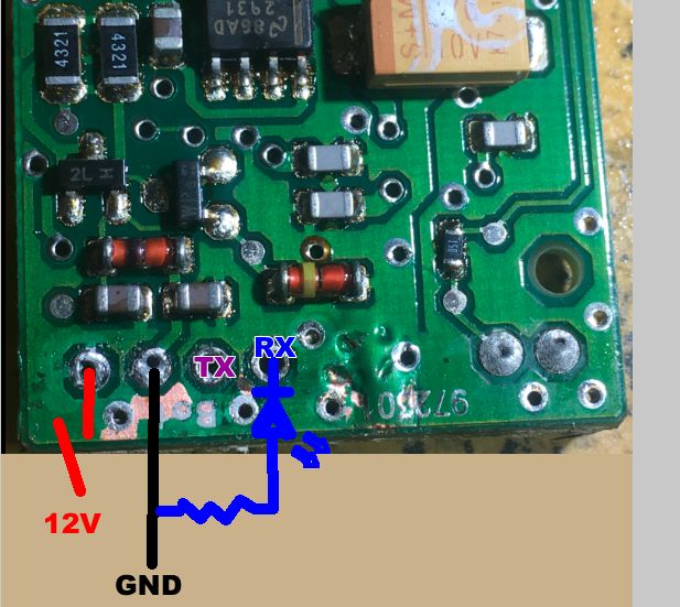

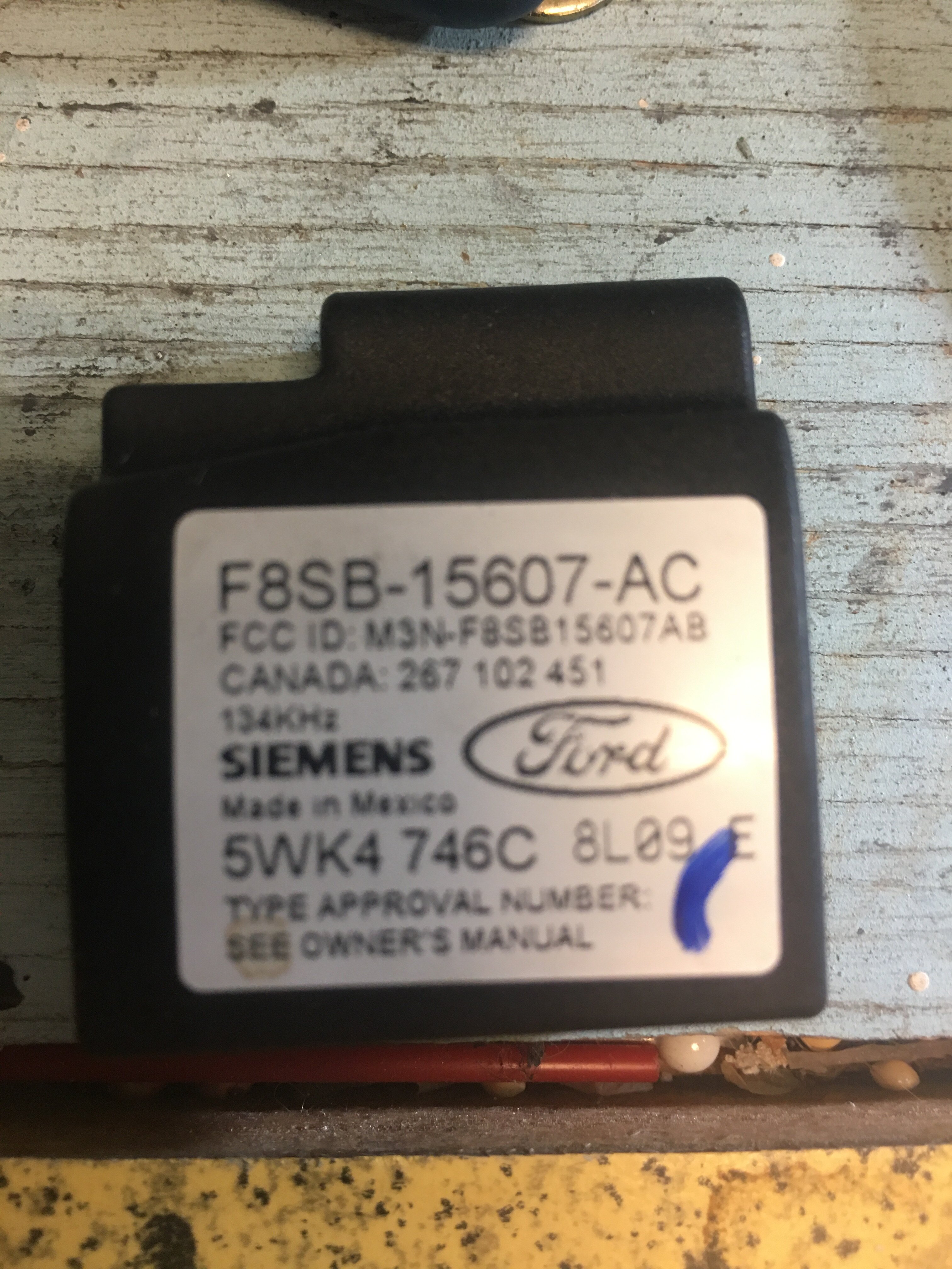

You can just grab another one from a junkyard, they are interchangeable. Nothing fancy, Its just an antenna that relays the transponder data to the instrument cluster where "PATS" system is located.
If your just trying to see if its working, when you first power it on you should see few hi/lo signals on the RX/TX lines. Easy enough to just connect a led to it. Usually when they die you will not see these signals at all so its a good indicator. This is the pin-out if I remember correctly but you may want to check to be sure.
